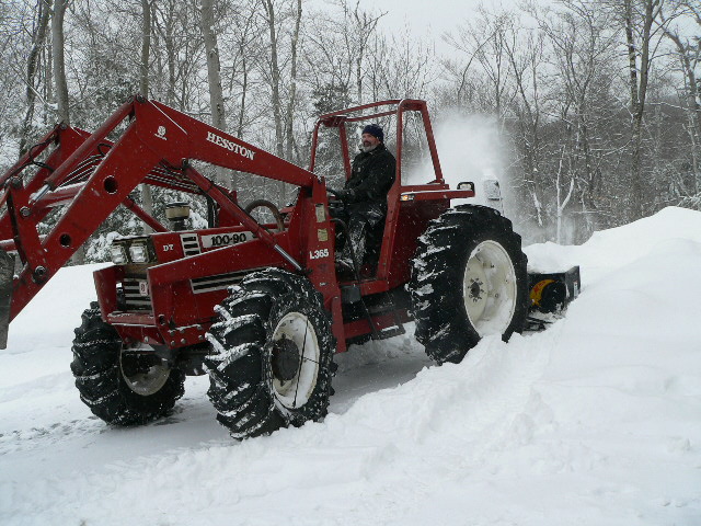

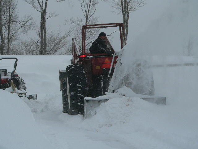

I put the chains on this big guy as needed. When not needed, I take them off. Each chain weighs in excess of 80 pounds. Yes, pain in the tail, but this tractor weighs a LOT and will wear out a set on the pavement if I don't do this.
The drive is 3/4 mile long, pavement. and the tractor makes a couple trips a week up and back for firewood from the wood shed to the outdoor furnace.
I really don't mind, as it is rare that this tractor actually needs chains for his usual chores.
The guy who does this plow route gets his truck stuck in a ditch on a narrow gravel road above me, about once a season. His truck can weigh in excess of 30,000 # with a load of sand. When I have to go get him, I stop at the barn for the chains, as a matter of course. :)
Otherwise, if I am dealing with a storm like the one in the picture, I chain up, too.

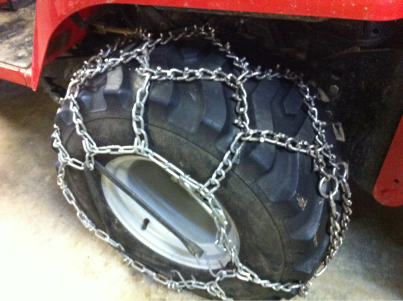

Put them on and leave em on all winter , have a steep gravel driveway and the gc2410 goes like a tank in 2wd . Had the chains on the front 2 link regular chain , but have removed them after reading the negative and don't want chance front end damage. The rear chains are studded and don't really hurt the garage floor , just driving in and out . May put the front back on going into the woods still have 2 plus feet of snow on the ground.

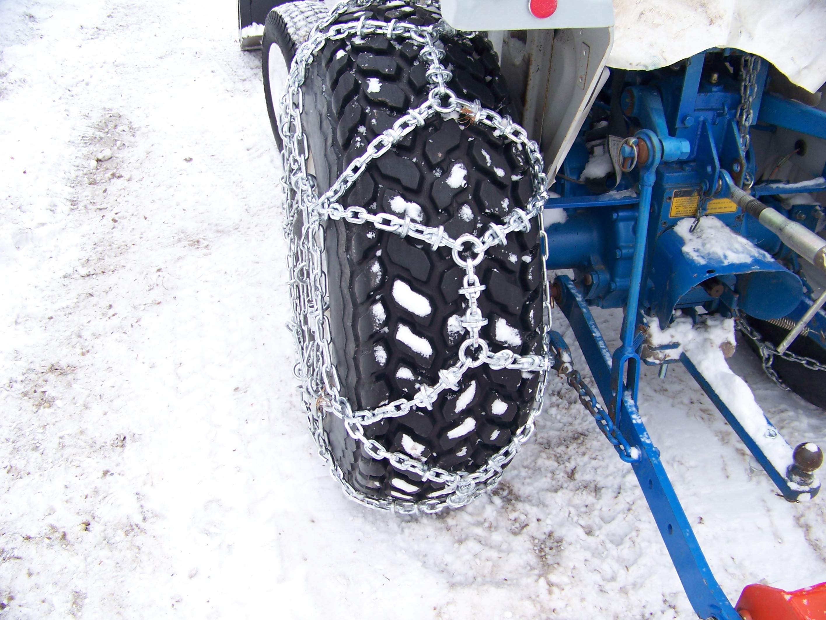

I'll leave mine on all winter, as I see no advantage to taking them off and have no desire to install them multiple times in one season. I got the European style
net reinforced chains from TireChains.com. It's absolutely unbelievable what they'll do on the rear of a set of R3s, since there are no lugs for the links to fall between.
Come spring, they'll hang on the garage wall.

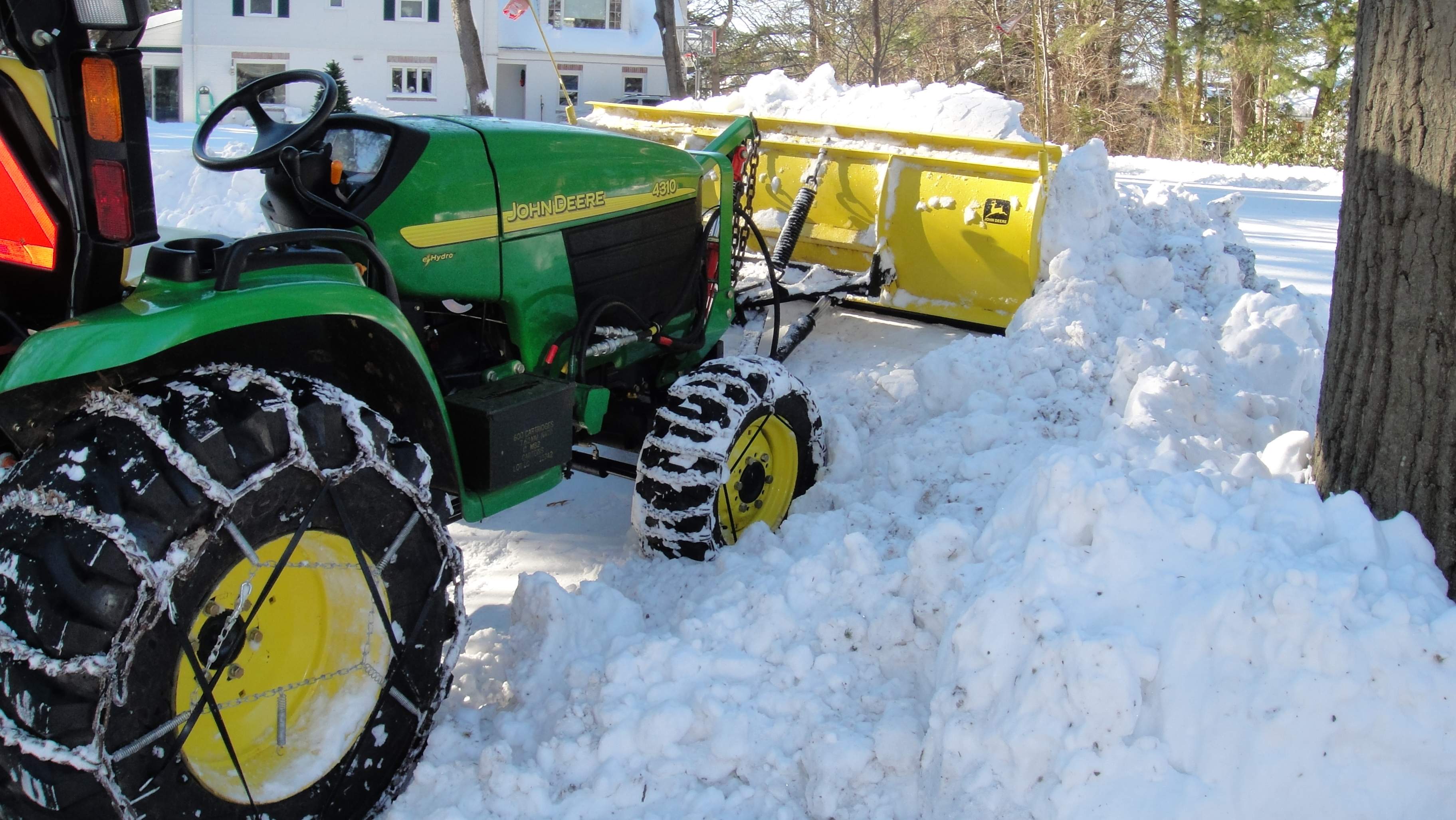

I use the jack also and don't have any tricks, just alot of struggling, using your hip to hold one end of the chains, as you pull the other side over at the same time trying to teeter the tractor with some other part of your body, so the tire your working on is off the ground but the other side is not touching the ground, so you can turn the one you're working on, etc etc. That's if you just use jack in the center like I do.
So yeah A PITN, not something I'd want to do every storm. Much easier with an extra set of hands.
My V-bars are tearing up the driveway this year, with all the snow and trying to push the piles back as far as possible.
