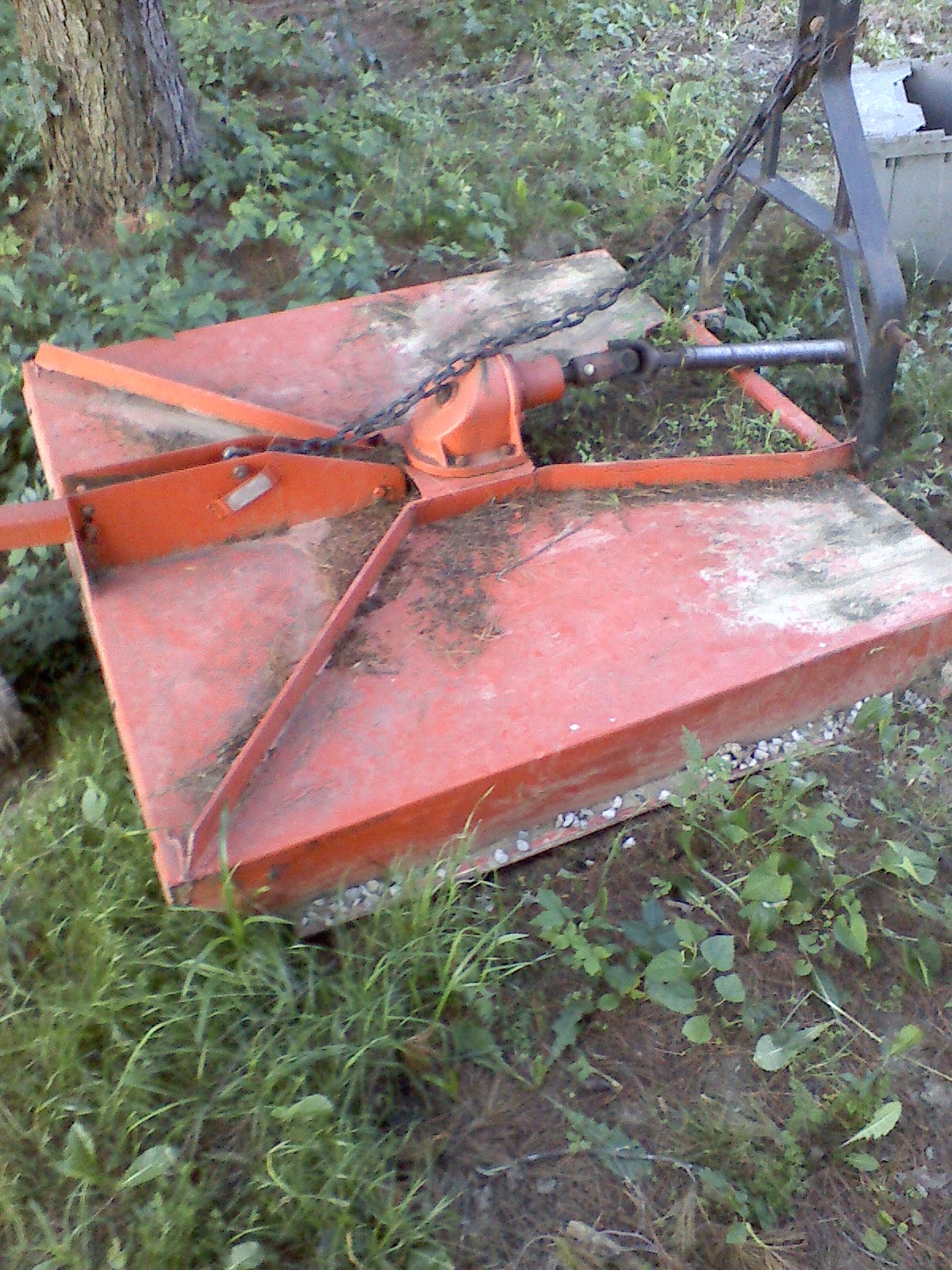

Here is what I used to use on my old NAA tractor. I had chain for a toplink and also mower height control chains to give me consistent mowing height and take the pressure off the hydraulics. If you have hydraulics that sag, this can make your mower very stable and be able to lift it when needed.

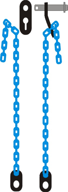

I mow very steep land that is also very rough. I found this system works great with steep approach and departure angles. It allows the rear of the mower to push up on approach and the chains limit the travel of the mower when I go over the top.

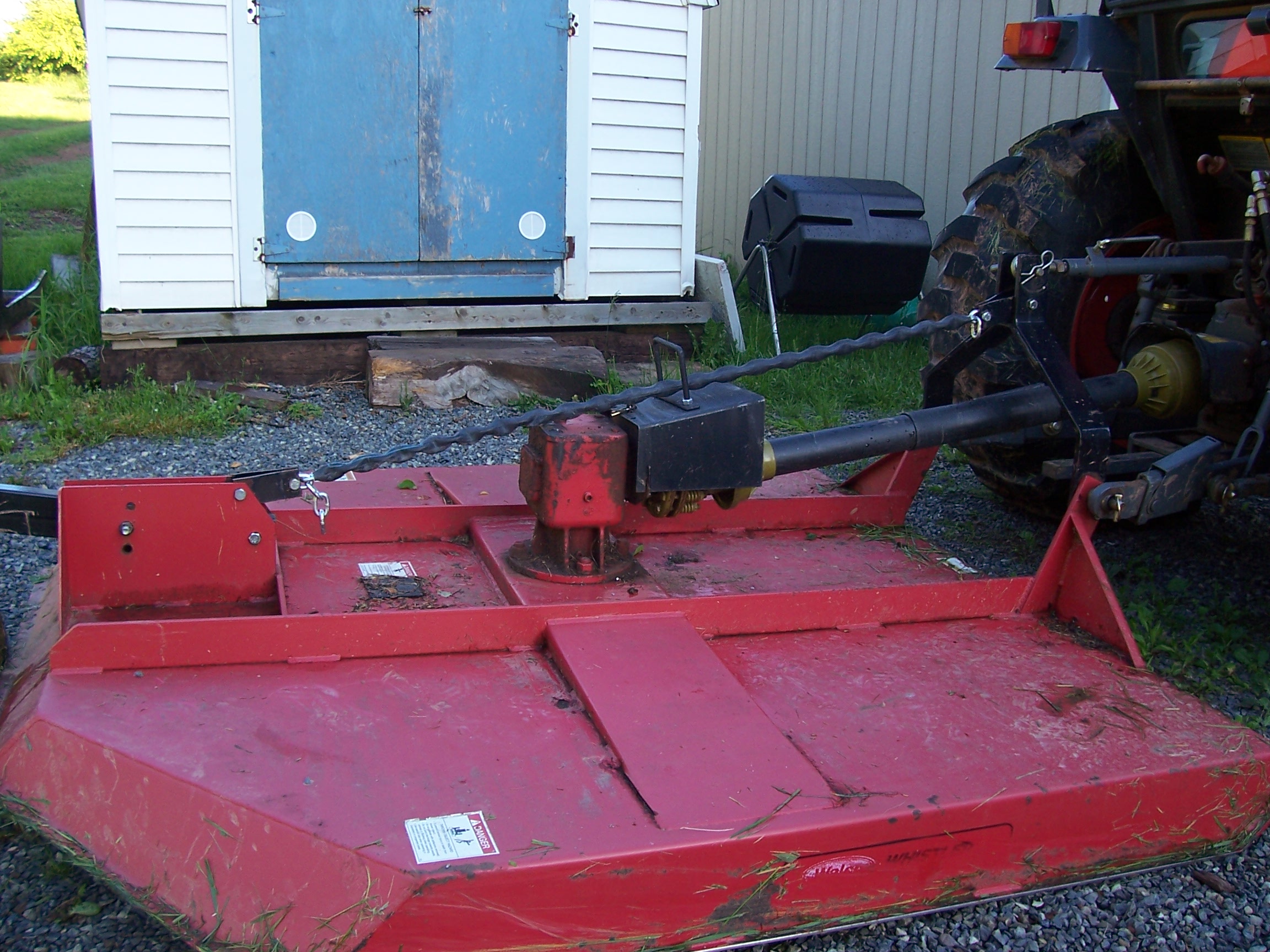

I have my chains running from the 3 point hitch frame to the deck as seen at: http://www.tractorbynet.com/forums/attachments/177784-rotary-cutter-id-please.html
However, the chains now attach behind the gearbox instead of in front of it.

This is the same set-up I have on my Bushhog model 105. ANd the same as I had on an old modern-sunshine cutter. And soon to be converted is my 360 bushhog.
I will note that the chains are much benefit for "rough" terrain. They are mainly for hilly terrain. As mentioned, the approach and departure angles. Having a chain allows the bushhog to follow the terrain better. And like when backing up to a hillside, a chain will allow the wheel to and the rear of the hog to raise up to the angle of the hill, instead of the WHOLE cutter when using a ridgid set-up.
So, I agree with those who say..keep the TL ridgid, add chains from that point down to the deck where the angle "straps" usually are. For a 5-6' cutter, if you have 1 strap, use a 3/8" chain. If you have two angled straps, remove them and use 2 5/16 chains.
Heres a pic of the 105 with chain. And I will also note that having the chain like this makes it easier to hook up as well.

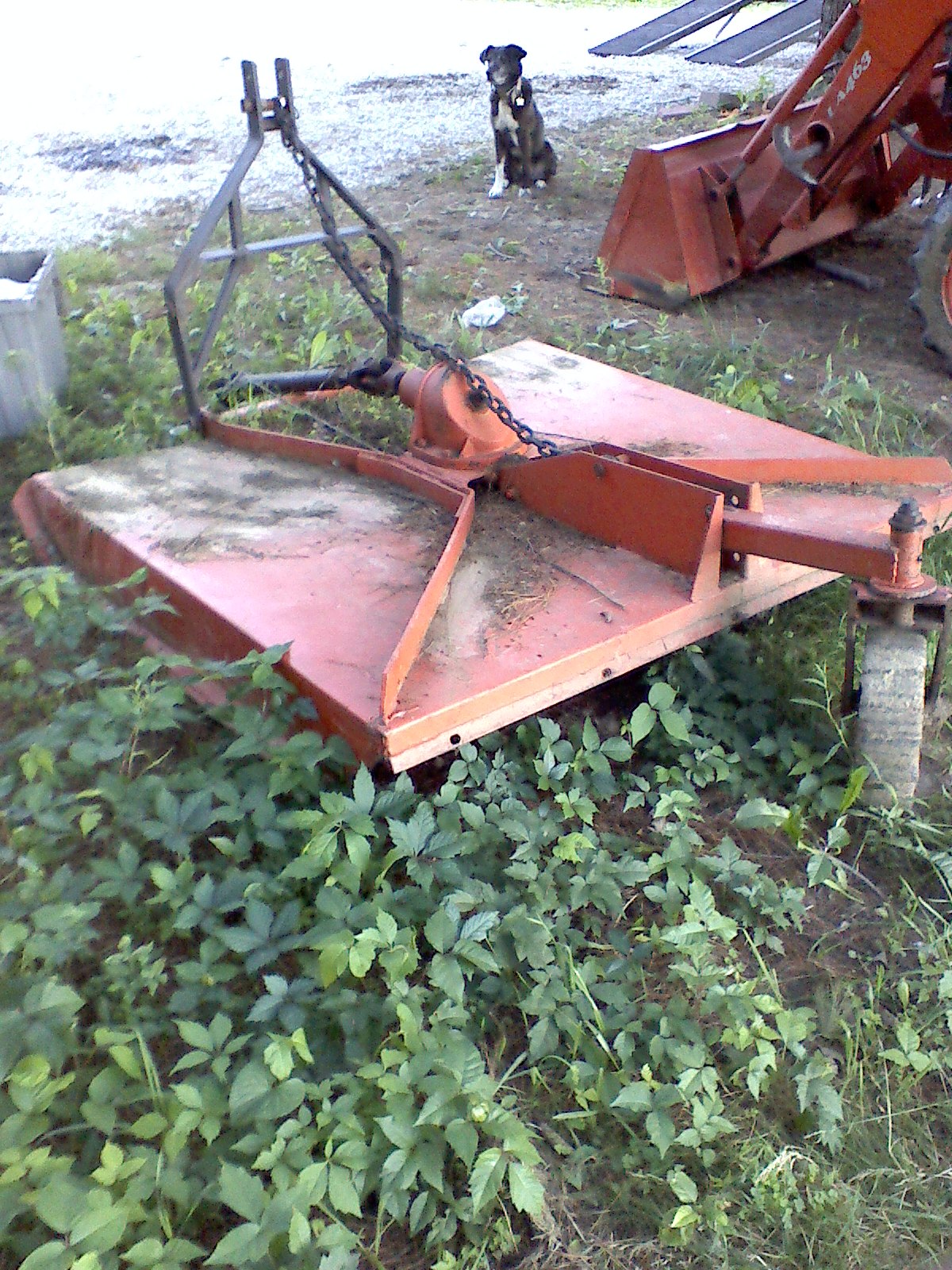

My brush mower needed a really slack support chain for it to follow contours properly, but this sometimes allowed the chain to slip under the slip clutch shield when going through steep dips (when the chain would go REALLY slack) and contacting the rotating U-joint. I fixed this problem by installing a retaining bracket on top of the shield and also slid an old bicycle inner tube over the (replacement!) chain to keep it from slapping paint off the shield.
In transport, I just tighten the top link until the chain is taut, then loosen it way up to mow. If the rear wheel comes off the ground when you go over a rise, it will rotate then slam down on the ground as you level out and, eventually, the wheel fork WILL get bent/broken...so, you need either no top support or a really slack support chain.

The geometry of that cutter is quite a bit different than the ones I have ran chains on. I can see where you were having the problems.
What brand/model is that cutter BTW?
