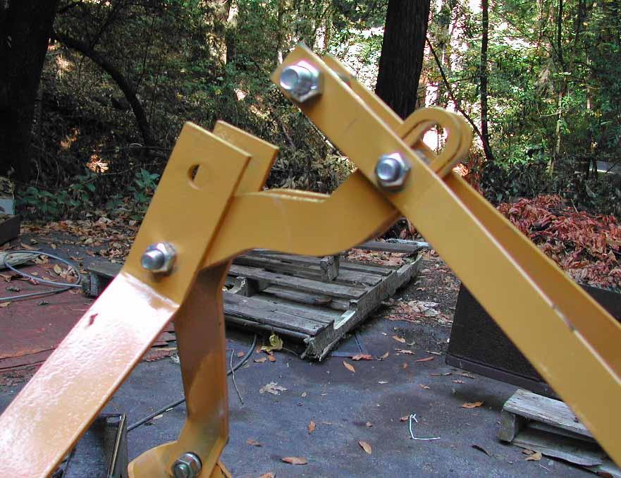

Here is an example of a floating linkage on a new Worksaver rotary cutter. You can see where the rigid or hydraulic toplink attaches (not provided). You could use a chain instead of a toplink here, but that would be redundant.

^^ That only appears to limit travel to a couple of inches, or less, where a chain would be less limited.

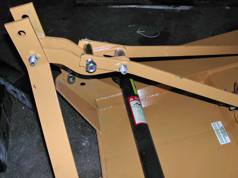

A chain toplink or chains instead of the mower top bracket would have more range of compression, yes. The Worksaver compression bracket above will compress about a foot, and result in as much as a couple of feet of lift at the rear of the mower. The bracket in partial compression is shown in this photo. It can compress more.
I bought this new to go with one of the tractors I refurbished, and have no experience with using it mowing. Others may have experience with this kind of mechanism in actual mowing. I hope they report here. Maybe a chain toplink or chains instead of a mower top bracket works better.

dfkrug: That specific configuration is one I had not seen but all the major rotary cutter mfrs have something with similar intent and function. They all know it is a mistake to run with a totally stiff top link and structure back down to the body of the hog. Deere uses the loose clevis to allow similar freedom to the linkage you show. Bush Hog (at least on my 792) uses a heavy single bar of steel link from the top end of the 3pt lift triangle on the hog to the straps they provide on back to the hog body. I have proven that rig inadequate as have many others bending or breaking the straps that go on down to the body of the hog. Look at web literature (or your local dealer) and you'll find they all have some free-floater design that at least helps prevent bent hardware. I do not personally believe ANY of them work as well as a simple piece of chain. For one thing you can cut-and-try until you get the ideal length for your tractor, your hog and your circumstances. At least half of the old farmers I see use a piece of chain.

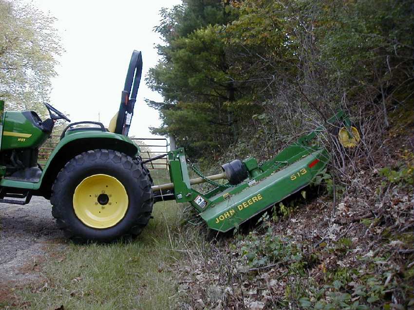

A picture found in the archives.
http://www.tractorbynet.com/forums/attachment.php?attachmentid=231392&d=1317222147
Experts, correct me if I’m off base. Wouldn’t be the first time.
This is written only in regards to the chains going from the solid top link to the rear of the cutter in lieu of the solid bars.
You can still raise the cutter in normal operation if the chain length is set correctly.
The positive from using chain is that if the tractor is backed up an incline or into a ditch where the cutter rear is forced up by the terrain, the chain is flexible under compression.
With solid bars/linkage, the bars have no give so something has to give as the cutter is forced up shortening the distance from the rear of the tractor’s top link mount to the cutter’s attachment point.
If the 3 point arms are lifted to raise the cutter off the ground in normal operation, the chain(s) are under Tension and pulls the cutter off the ground just like bars.
Reasons to not run chain all the way to tractor and not run a toplink?
1. Having to remove toplink.
2. Worry about chain getting into PTO shaft when slack.
3. Lotta movement around of cutter when raised and running down the road.
4. Seems it would get a little touchier to get the chain length right to allow movement full range yet pick up cutter for transport.
