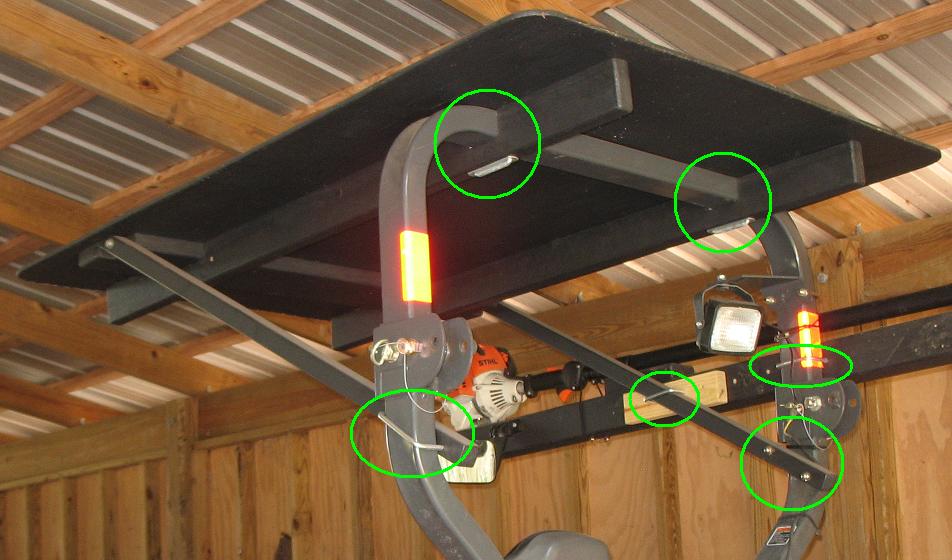

Quit worrying about drilling or not. Just clamp it to the ROP with a square-end u-bolt from the hardware store or a couple of bolts with a steel strap between the ends.
Bruce
Square U-bolts are great! Look how many I'm using to attach my canopy & polesaw-holding 4x4 to my ROPS:

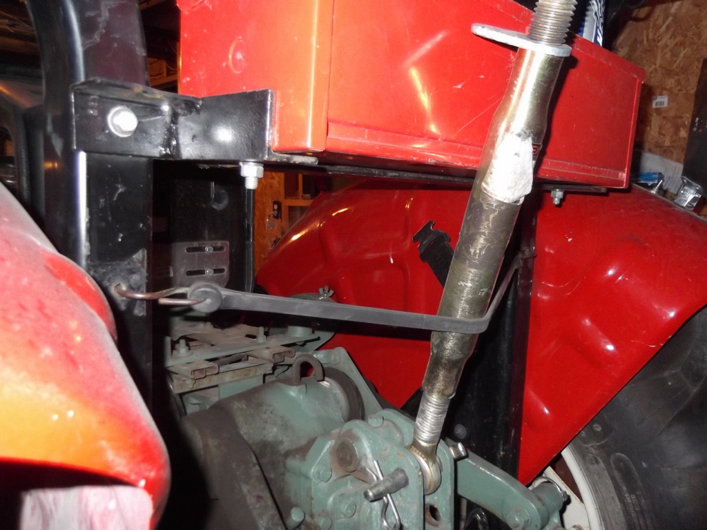

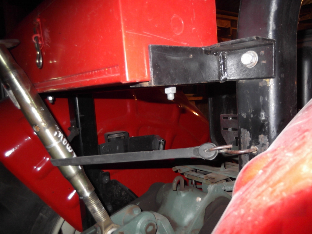

Here is how I attached mine if it helps and I see I used 2" angle for all of it.
For me it would have taken a trip to town for u-bolts which I would have to close shop to do so and a different design all together plus they cost a lot more money than bolts which I have on hand so thats how I decide how to do things right or wrong.
I know without a shadow of doubt my design will be right there 50 years from now and just as strong as it is today with only 2 bolts holding it on fwtw. There is a piece of 1/2" plywood cut to fit in the bottom so the box has added rigidity and it will save the box from wear and a couple drain holes also which cant be seen.

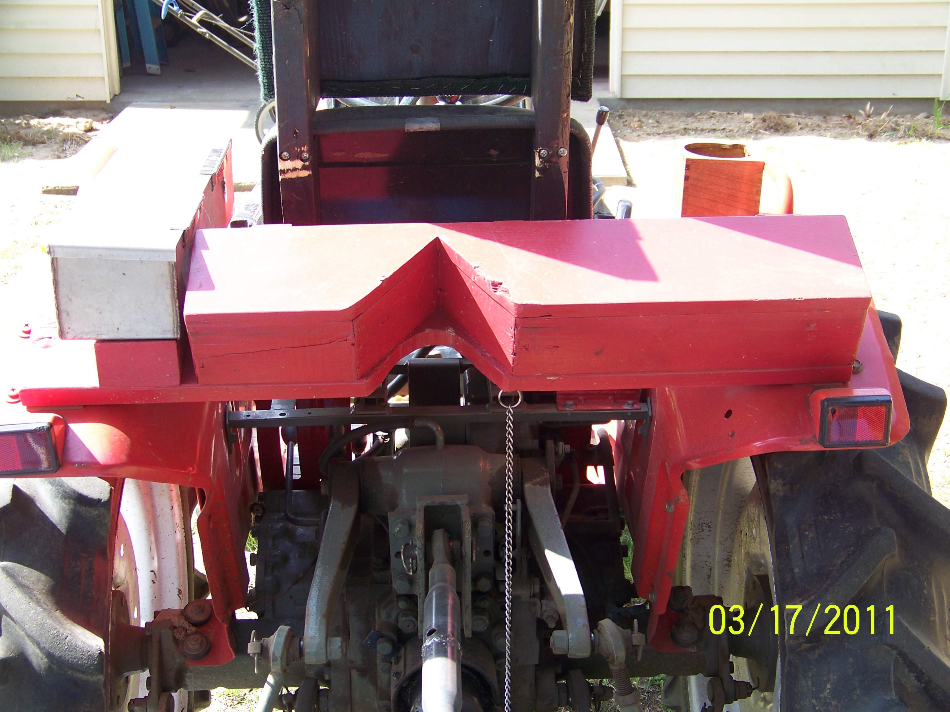

I decided that I was WAY over thinking. This is what I ended up doing - I installed one small tool box on the fender and it over hangs - I have just some wrenchs, hammer etc...and it caught the quick hitch but I tightened up the lift arm chains and its seems to have stopped... the other one is mounted between the rear upright on the ROPS. You can notice that the husky tool box lost a battle with the 3 point hitch....a little adjusting upwards and banging out the crushed bottom and sides and it works for storing my chain. I think this box will also hold a car battery that will run the winch I have to get me unstuck from time to time.
