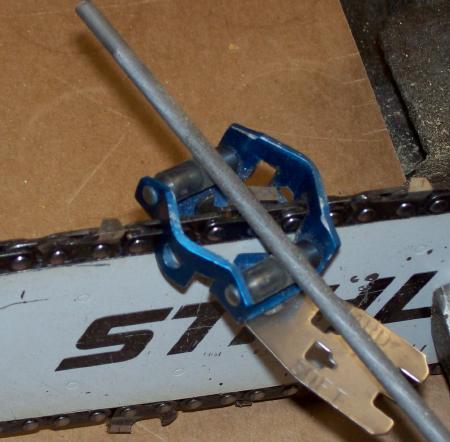

Update, I ended up buying an Oregon sharpner, its basically a Dremmel with a guide. I used it the first time today and I'm pretty happy with the results. Its 12 volt, which I didn't know when I bought it, but its O.K. because I usually have a vehicle parked near my work bench in my shop, plus I can take it in the field and use it if I want.

Dodge Man,
I think you'll be happy with the Oregon sharpener. It's a pretty good little unit.
There are a few things you'll want to keep in mind.
  1. Being a motorized tool, it's pretty easy to blue the teeth on the chain. Use a light touch and you'll avoid doing so.
  2. There is a tendency to take off varying amounts on each teeth. With a file, if you keep with the "3 strokes per tooth", they'll generally all stay the same height/width. With the motorized, it's more like "X seconds per tooth", and that time will vary. I bought a cheap caliper to use when sharpening. Every 2-3 sharpenings, I find the smallest tooth and lock the caliper to that setting. (It doesn't matter what the actual reading is). Then I make all the teeth the same width. This will make all of the teeth cut equally, giving you a better cut.
  3. Don't forget the rakers! You'll be taking off more metal, so you'll have to file down the rakers a little more often.

You should be fine with it. Like someone else said take your time and go light with it. Any sharp chain on a saw should do the cutting, if your forcing at all then it's time for a touch up. Rakers can be tricky, grind off to much and the saw can pull itself to a stop. To little and the teeth don't get the chunks/bite they want. When you do the rakers just take a VERY small amount untill you get use to what they need. Oh and make sure you get the right grinding stone for your chain/s :eek: :confused:

The Oregon electirc sharpner came with a gauge, I just figured out what hole my manual file came with and used the correct stone. I still file the rakers with a manual file plus I have a gauge for them.

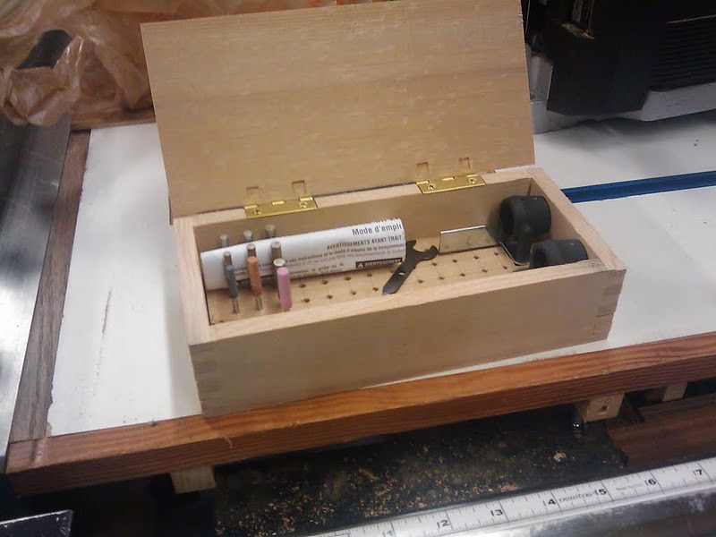

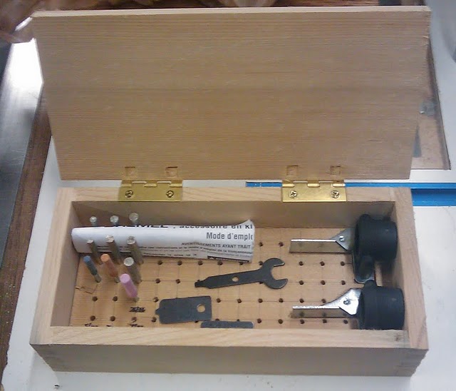

Re-opening an old thread here...
I have several different sharpening methods (Oregon 511a clone, files, Dremel, Oregon bar clamp / guide). Anyway, I had a mess of stuff I needed to store for the Dremel method, so I made a quick little box to store them in.
No finish, didn't even sand the box. It's made from old fir flooring material, with box joints on the corners.

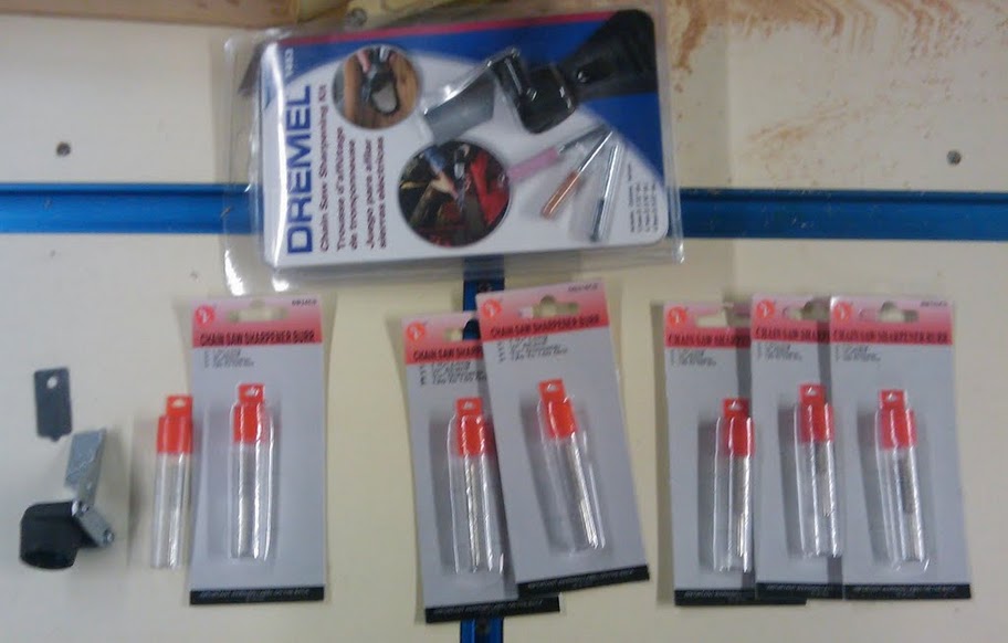

Items to store

Box

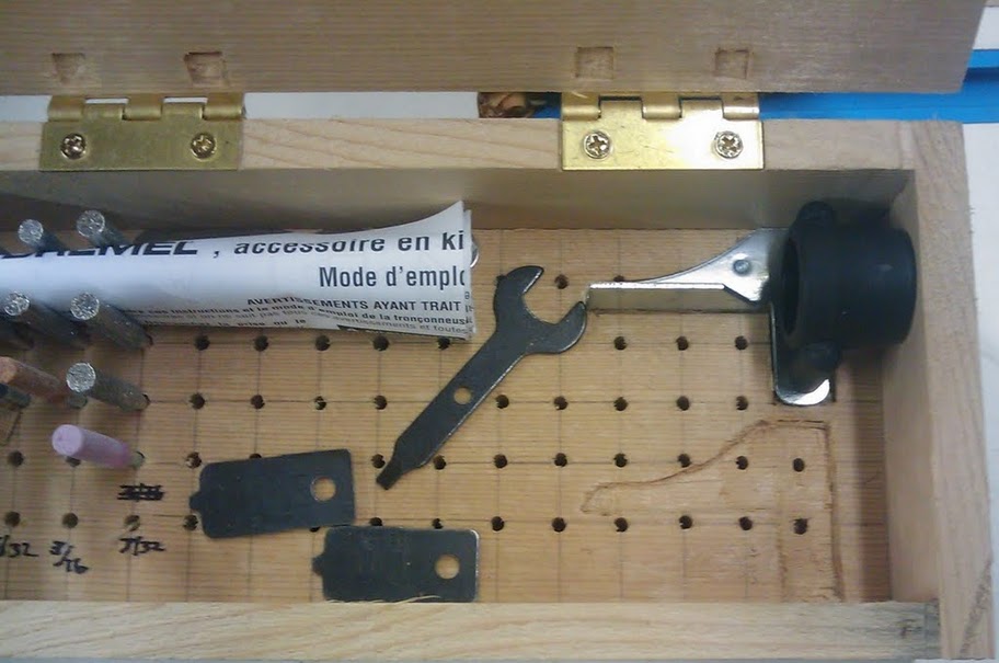

Carved out areas for guide so it would stay in place.
