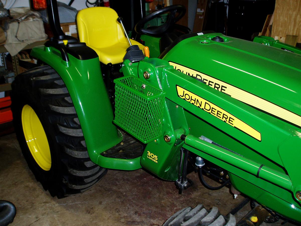

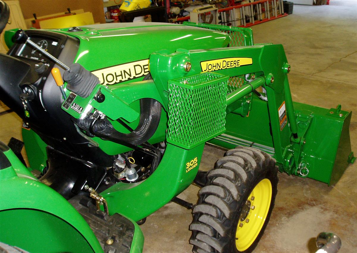

For some reason I've been on a roll with expanded metal lately. I like to carry around two or three lengths of 5/16" chain for all-purpose use, but lacked a convenient way to carry them. Since there are some unused cast bosses with 3/8"-16 tapped holes on the 305 loader's right side mast, I tacked together this little 4"x8"x8" chain basket to mount there. Extra care was taken to round off all edges and corners, and it doesn't stick out in the way. Easily carries a couple of 6' lengths plus a 14' length of 5/16" chain. The usual disclaimer about my fabrication skills applies.

And who said Deere wasn't thinking ahead when they put those threaded holes in there!
Really nice job, picker!

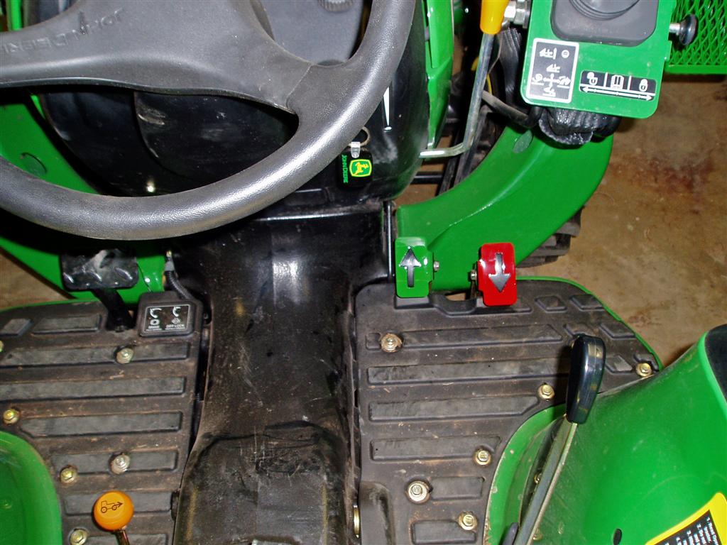

I figure a major step forward toward future procurement of things like a set of Chris' pallet forks, a tooth bar, etc. would be for the wife to learn to drive this thing. But she's a little scared about remembering what all the controls and pedals do, so...
Heh, heh... Eat your heart out, OSHA!!

Did you use brake to bend the expanded metal?
/ Chain basket for JD 3032E
#13
No, bending a single piece would have made more sense, but unfortunately I don't own a brake. I did it the hard way by carefully cutting and matching up four sides and a bottom piece, and welding them along the inside using tiny 1/16" 6013 rods and low heat. With a little judicious grinding and cleanup it came out looking almost like it was all one piece bent on a brake. After putting 3/4" angle around the top and bottom and adding a couple of pieces of 1-1/2" x 3/16" strap on the back for mounting, the resulting "box" was very stiff and solid. It's amazing how much chain a little 4x4x8" box will hold. I have three lengths of 5/16" chain in it right now and it's only about 2/3 full. It's turned out to be a very handy addition, no need to walk back to the shop for chains anymore, it's always right there when I need it.
