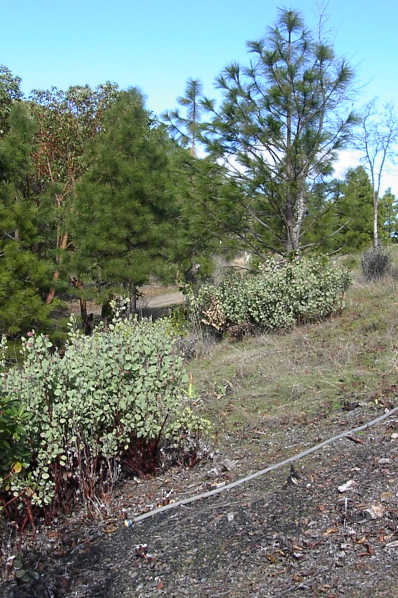

I envisioned this as a two-person job: one on the tractor; one manning the grubbing plow.
I also imagined that the tractor would be *above* the manzanita that was being grubbed.
The attached photo shows two stands of 2-foot tall manzanita on a 25% slope near my house. Each stand probably has 2 dozen plants in it, which is why grubbing rather than choking seemed most appropriate. (Maybe choking would work; I haven't tried yet.)
If I were using a device such as I describe, the tractor and tractor operator would be uphill, beyond the right edge of the photo.

Those look mowable with a brush hog. They'll just disappear without having to get off the machine.

Slope is too steep for brush-hogging. If you do brush-hog manzanita of this size, you end up with dozens of short, sharp stumps. Very unpleasant to step on. Manzanita is a very hard wood.
Nearest level ground for tractor is 30-40 feet away in this example -- too far for a backhoe to reach. And ... I don't have a backhoe.
My goal is to dislodge and uproot the plants. I can do this by hand with a grubbing mattock, but it would be nice to use tractor power. The tractor cannot come closer than 30-40 feet to the manzanita in question due to steep slopes.
The photo in my earlier post is just one example. There are other comparable areas where this would be helpful.
In theory I could hook a chain onto each tiny plant individually in every stand of these small manzanita, but I'm looking for a method to uproot at least several at one go.
I wish to remove them as part of fuel-reduction in firebreaks near my house and along my drive.

I just have to ask ... you said the slope was ~25%, and the pic seems to support that and the area seems to be free of boulders, stumps, etc. I don't think anybody really considers 25% to be too bad of a slope when working in the direction of the slope. Across the slope, yes, too steep. I know I'd try driving down the slope and try popping them with the bucket. A toothbar would probably be a big help.
