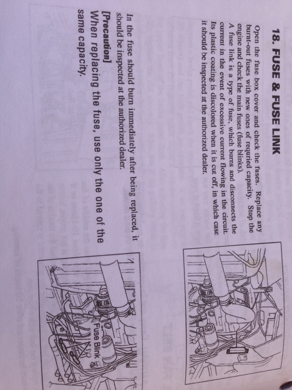

Eddie
This is from my 3510i operator's manual. My tractor is about 2005. Hope this helps.
CWB

Thank you. That diagram is the same as what's on mine. Is there any other fuses anywhere else?

After reviewing the information I received, I found what I think is the fusible link. In the photo, you can see where the plastic is worn away and the copper wire exposed. This was resting against the back of my starter. When I took it off, I found that the wire at both ends was fried. You can see the discoloration in the picture.
I made a temporary jumper to see if that was it and if I could start it. Nothing. It's still dead. The next place I checked is at the top of the picture. I'm calling it a starter relay, but I don't know if that's correct. Please help if it's called something else, since that's what I'm searching for online right now.
