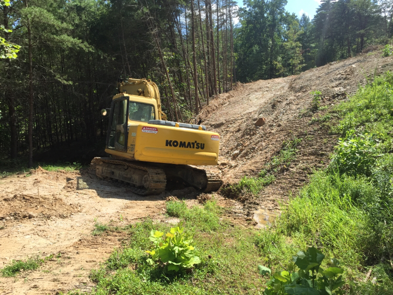

I have a bridge. I still have a lot of work to do. I'll be be doing more fill and cover work next weekend. But I have a bridge. I had two more trucks of stone delivered Friday. And then two more today. I was able to get the last one dropped right on the job site. Saved me at least 4 hours of picking at it with the tractor. So far that is 136 tons of crushed stone for backfill. Ive driven the excavator back and forth over it 30 times packing down the dirt. I feel confident that it can handle day to day traffic with no problem. image-4058305844.jpg

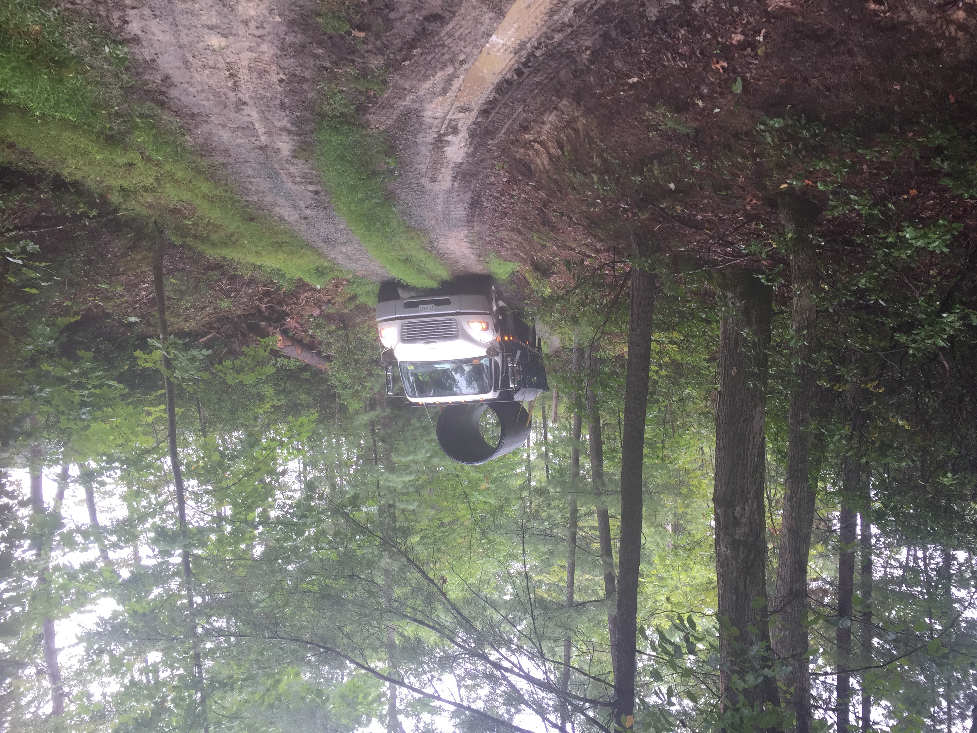

I was able to send that first picture from the mountain, but couldn't follow it up. Let me back up a bit. this weekend, I made good progress. I started early moving stone for an hour or so and then My wife showed up and was moving stone for about 7 hours on Saturday. I would wait till she had delivered 5-10 loads before I would mess with it. I had plenty of work to do because my son and I were putting clay at the start of the drain pipes, Tamping down inch or two layers of dirt by hand. Plenty of cardio Saturday. We got a lot of backfill in there.
Sunday we did ok, but it started to rain around 2:30...some big dark storm clouds and enough rain to turn the dry clay into a mess. I pulled the plug before we could tear up the soil.
Today I went back alone and did some maintenance while the sun finished drying out the roads and work area. This morning, at 8 I went into the quarry office and ordered two more truck loads of stone. I asked if the could deliver them to the pond. ....I was in town getting diesel when the first load came and it was dropped by the road...I pained a big sign on the ground with utility marking paint asking that they deliver the next load to the pond. I was tightening longest on the tractor when I heard them a truck so I ran up to tell them to come down. The driver walked down with me and checked it out and back the truck all the way to the bridge and dumped the stone. Made me happy as could be.
I spread the stone that was dumped at the bridge, then ferried more stone for an hour. I got things spread outing started to put some dirt down. Then I drove the tractor for another hour, getting more stone. I thought I had moved enough....

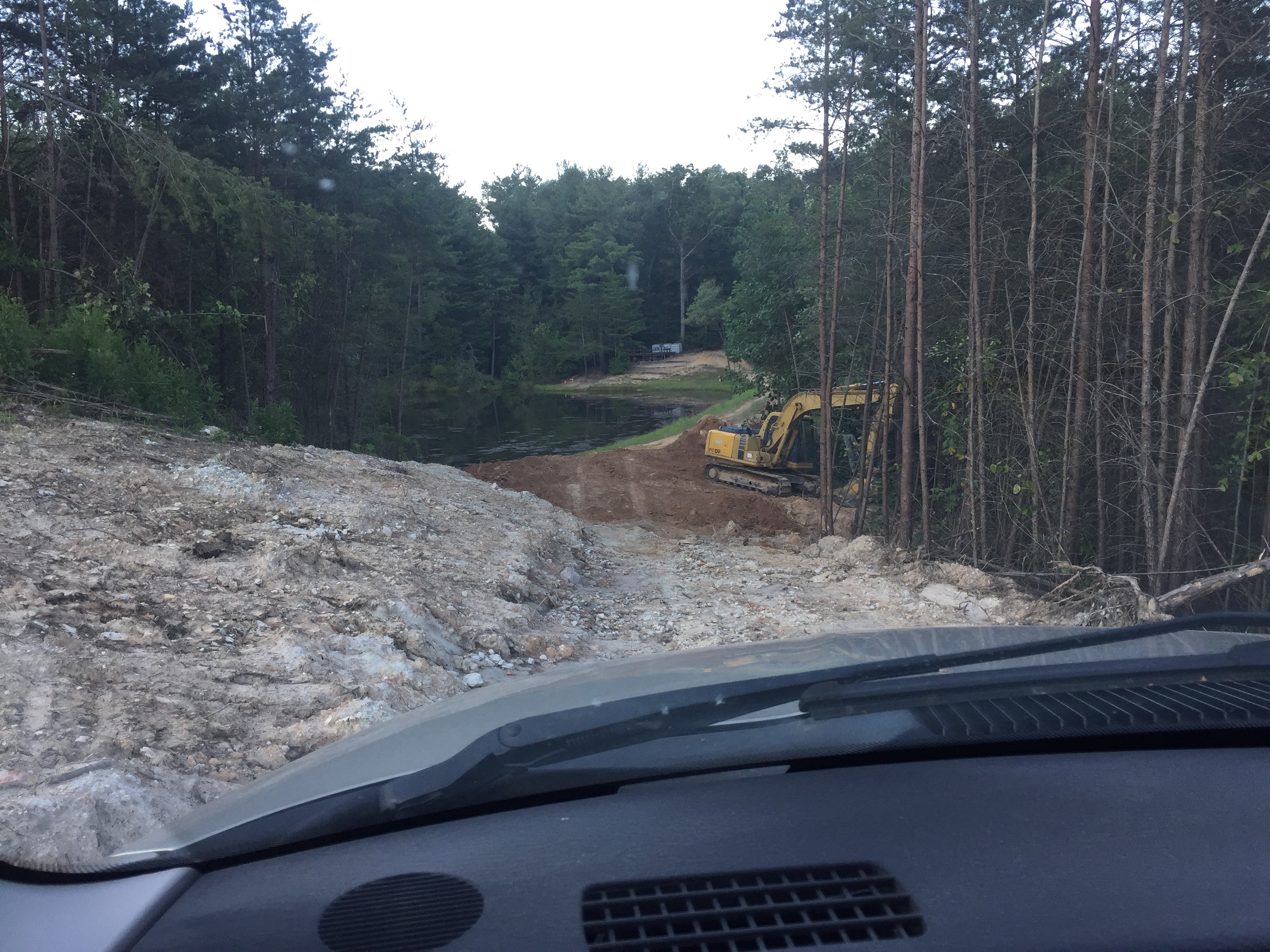

I would spread out 5 or so buckets of dirt then pick thru it to remove sticks, roots, and large rocks. When there was about 6 inches I drove on it to compact it. When there was a foot of dirt I stopped worrying about the larger rocks unless they were larger than a bowling ball. I am amazed at how much material I have put in that hole. I put all that pipe, 250,000 lbs of crushed stone and most of the clay back in it, and I still need more stone and will need more clay. Changing the contour of the land and joining tow pieces together is more than I thought it would be. IMG_4660 (1).jpgIMG_4659 (1).jpg
I was able to drive up to the home site. I kicked back in the bed of the truck for about half an hour to enjoy the sun setting behind the mountain......then I drove back down, and sprayed my trees. The work don't end.IMG_4667.jpgIMG_4669.jpg

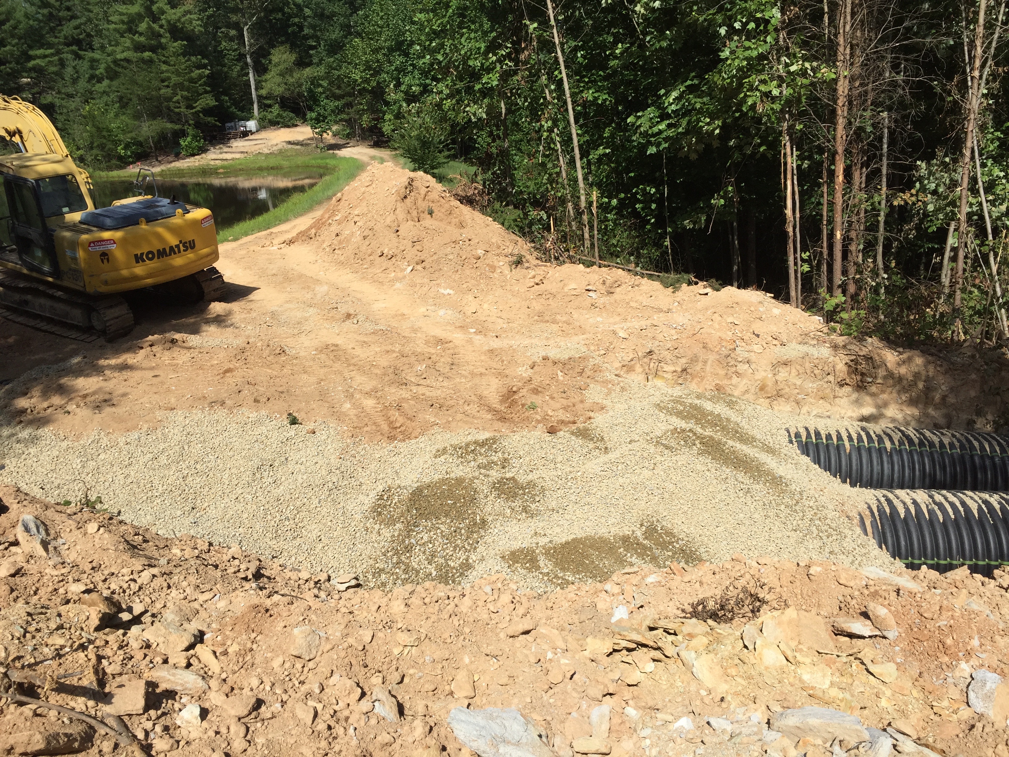

Lots of. Work going on there. Placing gravel around a culvert is a total new one to me, never seen that done before. What is the reasoning? Is it so water will seep through without washing out around the culverts?
/ Cement Bag Retaining Wall
#51
The stone is supposed to lock together easier, and require very little compacting. It also worked out for me because I am not just filling the hole back in, I am trying to create a bridge that rises up and changes the contour of the land right there. Basically a large ramp.

I can see how they are using gravel backfill for near level trenches with the HDPE pipe since it has little or no water pressure to seep around the pipe and wash out. A spillway is much different though, isn't it? I think you said you are only using the gravel in the center area of the long trench, with clay on the upper and lower ends. Hopefully that clay will seal the upper end.
/ Cement Bag Retaining Wall #56
Good links. I enjoyed reading them and seeing the video on how to join the pipe. From everything you've posted, compared to the links you provided, in my opinion, you are doing everything right for a culvert installation on a road. Easily going above what is needed and not cutting any corners.
My concern is that you are also using the pipes as a pond overflow. Crushed rock is one of the best materials in the world to allow water to flow through it. If any water gets past your cement bag retaining wall, it will eventually undermine the integrity of the foundation under your pipes. Will you even notice it? How long will it take until there is a problem? With everything you've done, and how often the pond overflows, you may very well never have an issue. If it was me, I would just do all I could to ensure water did not get under your pipes and into the gravel.

That is why the first 8 feet at the inlet is clay that I have tamped in by hand. Once I get the cement retaining wall built I will decide if I need to make a more advanced inlet. The concerns you listed have definitely been on my mind. I think that by having the inlet side be clay and having 3-5 feet of compacted clay over the rock I should have a pretty good set up to prevent erosion under the pipe. I may also dig down in front of the pip band do a cast in place inlet ramp with concrete. That remains to be seen.
