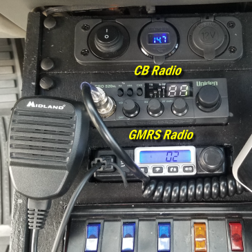

We live in area with spotty cell service at times,considering CB home base. :unsure:
What are pros cons also good unit.

CB with SSB is the only way to go. Finding units are harder today with SSB.
GMRS is better, requires an FCC license that is easy to obtain. GMRS reaches the same distances on much clearer channels.
CB AM output power is 4W. 5 to 16 miles reaching range
CB SSB output power is 12W. 15 to 30 miles reaching range
GMRS output power 50W. 65 to 90 miles reaching range
CB Radio = 26.9650 MHz – 27.4050 MHz
One of the nosiest locations on the AM band.
GMRS Radio = 462.5625 MHz – 467.7250 MHz
Mainly FM and crystal clear communication.
CB antenna is around 4FT for the shortest, but to get the power to signal out a 5/8-wave is perfect, thus almost 7FT.
GMRS antenna is around 6-inches. Can be placed nearly anywhere and is STEALTHY.
Why GMRS and not 2M Ham license?
GMRS is just a fee. Ham is a minor fee and a radio electrical test to pass.

High output GMRS is the only way to fly plus you can do repeaters if necessary. I have a mobile in each of my tractors and a mobile / base unit at home and I can reach my wife from the next county quite easily and unlike a CB, it's quiet and not much squelch needed. Mine are Midland but lots of them on the market. FCC licensing is a snap as well. Much, much easier than the Drone pilot's license I also hold. CB's really require no license to operate, supposed to have one but I don't know anyone who does.

1/4 wave CB is 107 inches, you can make it directional (longer range to the front and rear, less range to the sides) like big rigs do by mounting one on each side mirror BUT they must be 107 inches apart exactly. Anything over or under will reduce the distance gained to the front and rear.
Anything shorter than 1/4 wave will have a coil somewhere on the shaft (called a load), back in the day we found that putting the load at the top of the antenna gave the longest horizontal range and at the bottom the shortest. You want to know more you gotta get into horizontal and polar wave radiation patterns.
It was fun at the time. Better than EW/ECM stuff the Air Force exposed me to. :):alien:
You can also run a power mic, with the modulation set to just under 90%, that way YOU can be understood as far as your radio can reach. All of this is legal. There are other things you can do to increase YOUR talk range. Talk to the HAM operators for that kind of stuff, They can do that CB can not. There are issues.
