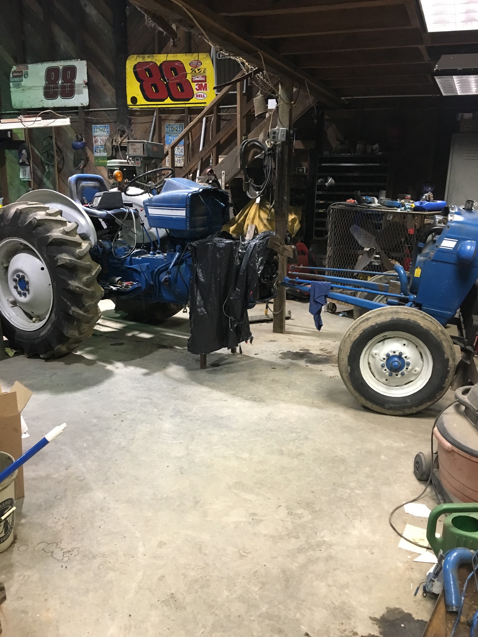

The first machine shop i sent it to performs 99% of their work on gasoline engines. He did mine as a favor since he knew me and business was slow. I asked him to put new guides, seats, and valves in, but he told me a set of guides and a simple grind would be all it would need.
Maybe he didn't realize a proper valve job was critical in a diesel because of the higher amount of compression.

Just to give a final conclusion on this thread.
After I had the injection pump rebuilt and installed, the tractor started on its own without ether.
I hooked it to a disk and spent the day cutting about 5 acres, lugging it down to set the rings in. The next day I hooked it to the bush hog and did some mowing. It ran great and did not slobber any oil when idling.
I spent a lot of time chasing the manuals specification of 500 psi compression. Maybe that was a misprint, I was measuring it wrong, or there was some other factor involved. I live on the coast, so elevation is not a factor. Regardless, it does not take 500 psi for these tractors to start and run properly.
This was my neighbors tractor and after the repair he has continued to operate it without issue.
This was the only picture I took of it, when I had the head sent to the 2nd machine shop.
Thanks for all the input and helping me brain storm!
