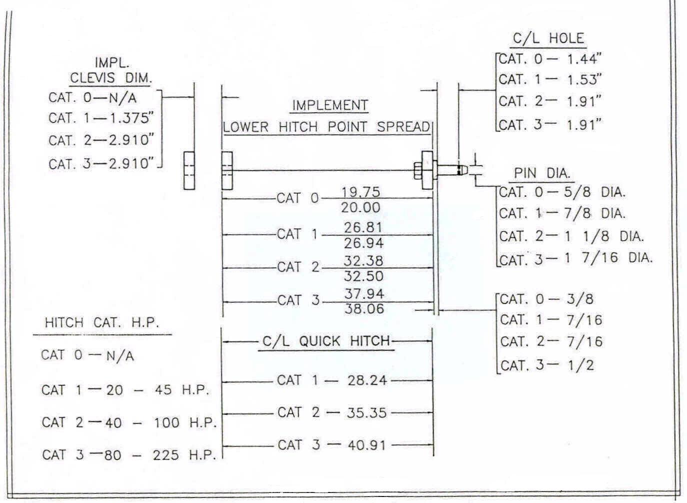

Hey all,
I am a do-it-myself (tight!) guy... :thumbsup: I have done more then enough web searches and came up really short of any really good plans/blueprints for Cat. 1 3pt implements... I have seen alot of pictures of works in progress and finished projects, but not many diagrams with cutlist and such... I done University searches and most every worded search a person could do... Any 3pt projects would be cool as long as it cat. 1... Blades,lifts, scratchers,diggers,you name it.. just love looking at others ideas and ingenuity!! I appreciate your patience and help with this....:cool:
I will post my email for anyone having anything... mhein68 at live.com

Don't know if this is of any use to you, but you shouldn't have to push the delete key very hard to get rid of it.
/ Cat. 1 Three point implement plans/blueprints/designs??? #6
I believe SAE has some standards for the different categories of 3PH. Trouble is you have to purchase these or have access to their standards library.
looking for standards a couple days ago for 3pt hitch, and it would seem SAE standards are pointing to ISO standards for the latest revision. i think iso.org wanted something like 88 bucks for a copy.
a lot of talk on... lower lift arms and top link. and how much they can swing/angle, how far they need to stick out behind tractor / tires, etc...
i don't remember site, but it cost over a hundred bucks but provided copies of previous revisions. and some noting that older tractors built on older revisions, may have some issue with some attachments built to different specs.
