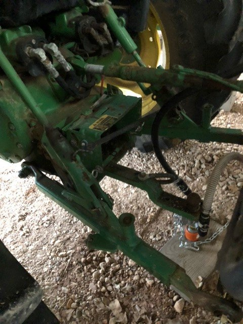

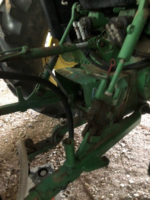

I am (trying) to post a couple of pictures of my 3-point. I am "always" able to get things hooked up. Just the old man (me) is wondering if this could be made easier. :)
I did buy a Quick Connect for me front end loader. It helped tremendously with changing out my bucket with a hay spear. Previous to getting the quick connect, it would take a long time and much effort to re-connect the bucket. By the time I climbed in and out of the cab 100 times to line things up I was too tired to do anything else. :cool:
So, again, just looking for suggestions I can afford or something I am overlooking since I am NOT extremely familiar with tractors.

For some reason, I thought you were having difficulty with a smaller JD tractor. I don't know the model numbers very well and should have looked it up. I have a JD about that same size, physically. Unlike the Kubotas, my JD doesn't have extendable arms either, and it has the turnbuckle sway links that are awkward and slow to adjust. Even the top link stowage is awkward. I agree that it's a pain! Fortunately, I rarely hook anything to the 3-point on that tractor unless I'm using a heavy 120 gallon sprayer.
Thanks for the pictures!

I'm not grasping the issues being had with hooking up implements if the tractor has extendable arms. Even if things aren't level. I back up to something leaving maybe 2" to 4" gap away from the pins. Get the height adjusted so that you have equidistance vertically with the two arms. Extend the links, pin them or slide them on and back into the locks. If it's unlevel you may need to raise and lower a couple of times but they will pop in. Then hook up the center link and the PTO if so needed. It's not a quick hitch but I've been doing it for lots of years with no issues.

That's what I was afraid of... that is, the solution is a quick hitch. :(
I am uncertain if I get one, how / if it will effect the shafts on my seeder or post hole digger ? Maybe would be okay ?
Does anyone have a recommendation for a quick hitch ? The bottom pins on my tractor are Cat2, but all my implements are Cat 1.
Most QH (all 3 points) are not compatible with post hole diggers (PHD) as most PHD’s hook directly to the tractor top link mount.
Any PTO shaft that has been cut to length (shortened) can be an issue with any QH as they all add around 4” to the distance between the tractor PTO connection and the implement PTO connection. As a footnote there are PTO extenders available which may be able to provide the fill of the gap as could an overrun clutch if it is not already built into your PTO.
Also if your implements are not WH compatible, expect to modify each to fit. This is common with older implements (some of is believe these are built heavier and will out last the newer implements). When looking at QH’s consider Pat’s quick change system. It is not for everyone, but it dies meet the needs of some of us.
as for your Cat 2 tractor and Cat 1 implements, unless your tractor has dual size balls in your lower lift arms, you are using bushings, you will need to continue using bushings or start using bushings with a QH.

Check the sway blocks they may be holes to bolt them "sideways" to what they are now. That would make them narrower and be easier to hook up implement. If I remember right the 4010 ( the old big one) had blocks the could be bolted on the side to narrow them or could be removed and or bolted on different so they only worked when the hitch was fully raised. The 520 had the elephant ears and only worked when the hitch was raised. No issue hooking up implements. That said sway blocks were available as an option and used spacers of different length for cat 1 or 2.

Yea those sway blocks had a scalloped side that allowed more sway as the hitch was lowered. You could flip them to the square side and it would stop the sway all the way through the lift.

Yes, I checked the sway blocks. They are set for Cat 1. You can flip them and re-bolt for Cat2. Should be easy except the mud dobbers build nests in the holes which you have to clean out to get the bolts in.
