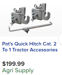

Alternative to quick hitch is Pat's QH. These Pat's adapters can be be utilized on both Cat l & Cat ll implements unlike standard quick hitch & don't require all implement centerlink attachment locations to be identical dimensions.
I had purchased these last year. Ended up giving them away. The tips on my lower arms are "curved/angled" slightly and the Pat's just DID NOT fasten up good - good enough that I would trust them. I had to use all the shims that come with the kit, even so, they did not align very well. But, thanks for the suggestion.
I would rather have a "frame" style that has (3) connects to the tractor if I buy one at all.
