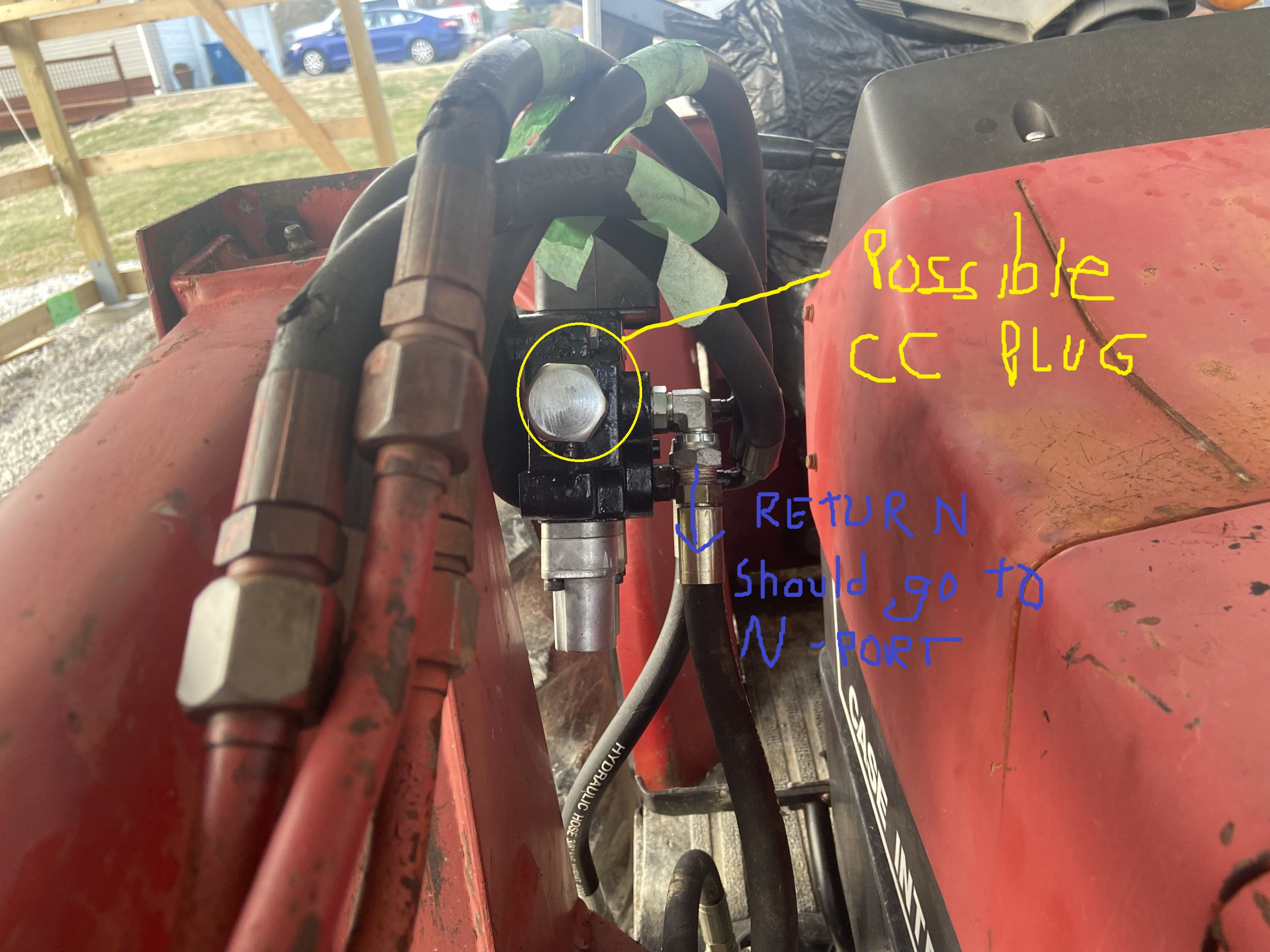

So I pulled out the plug that you circled and put normal plug in and 3 pt hitch seems to be working fine. I have not put a load on it yet, but believe this fixed the issue. I reached out to Brand support during this and kept saying I needed PB setup. I was suspicious since it was not on other control valve. LD1 thank you because your input help me better understand the problem and resolve the issue.

That sure looks like a CC plug to me.
You really should get the appropriate PB cartridge from Brand. Then instead of feeding your 3PH off the tank passages of the new valve (which can possibly damage it if you put something heavy on the 3PH)....feed the 3PH off the PB. Then add the tank line and dump it somewhere to the tank/case of the tractor
