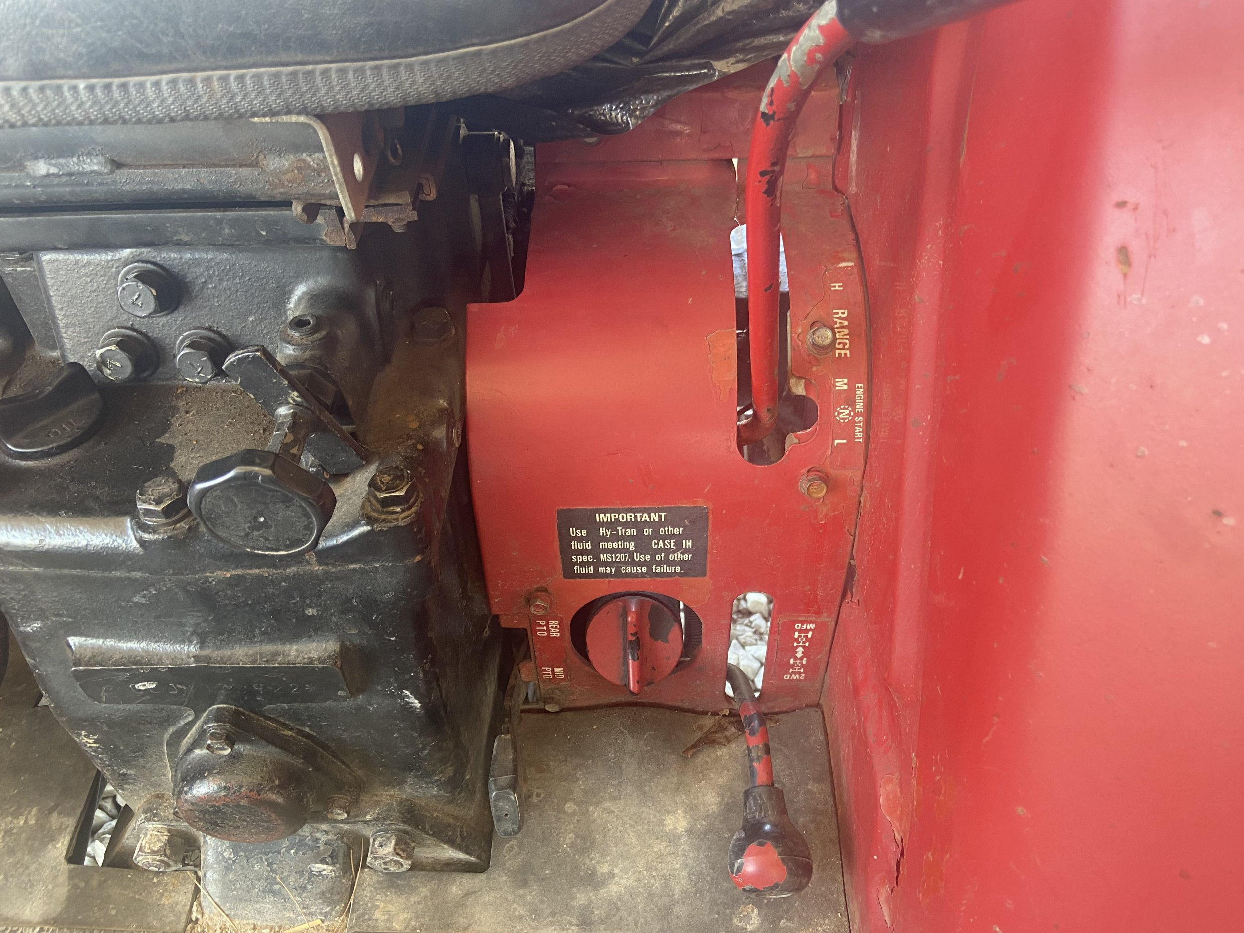

Is there a lever on your left side? If so try moving it and see if that does it.
/ Case IH 275 Loader Control Valve
Just a lever on right for 3 pt. Some times my 3 PT hitch moves slowly with no weight on it.
/ Case IH 275 Loader Control Valve #4
Some of the older IH had a lever on the left to switch the hyd flow from front to back. That is why I posted that.

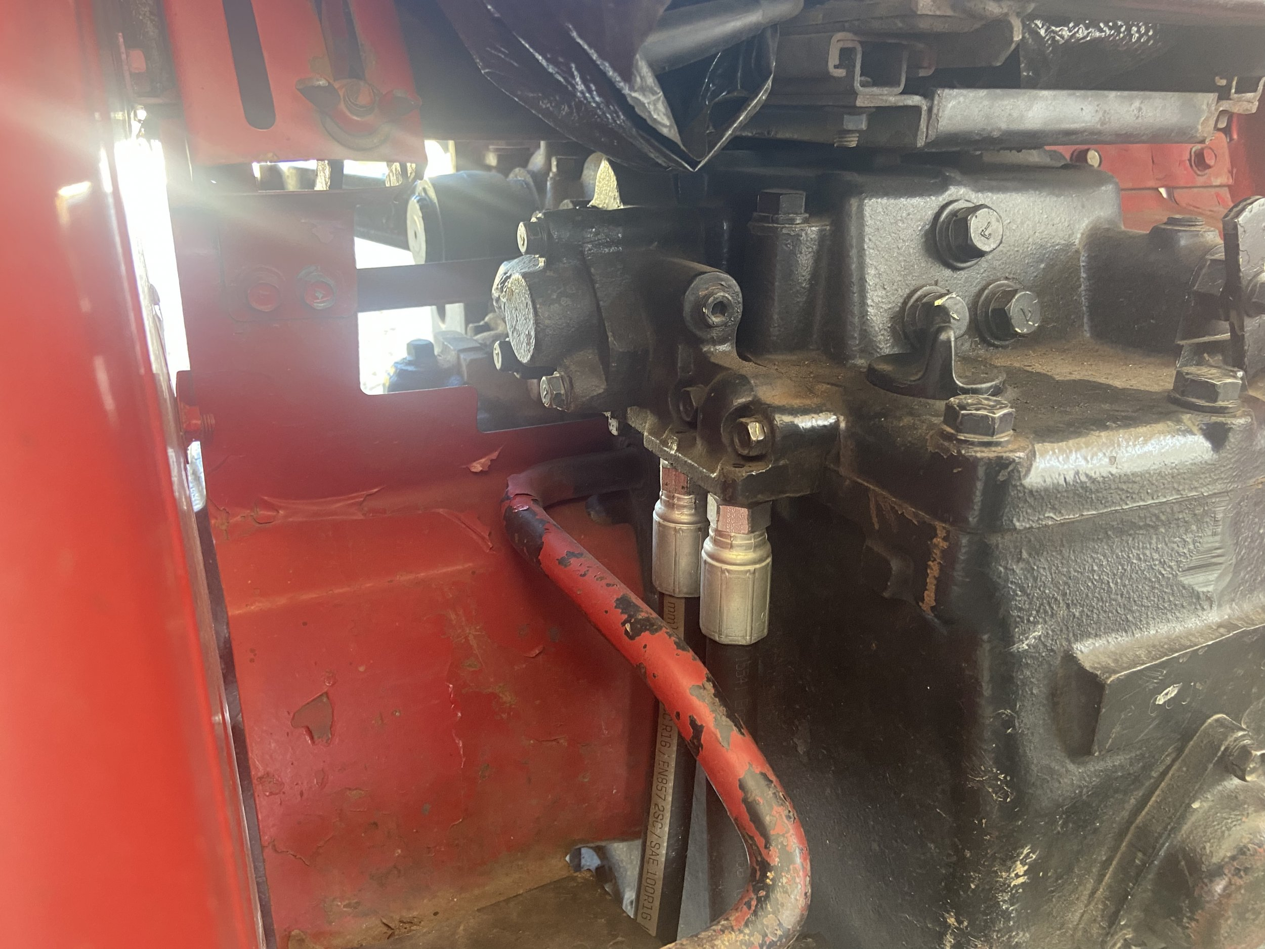

Couple photo, one show block and hoses that go to control valve.

You do not have the lever I was talking about.

Any pictures of the valve itself and how its hooked up?

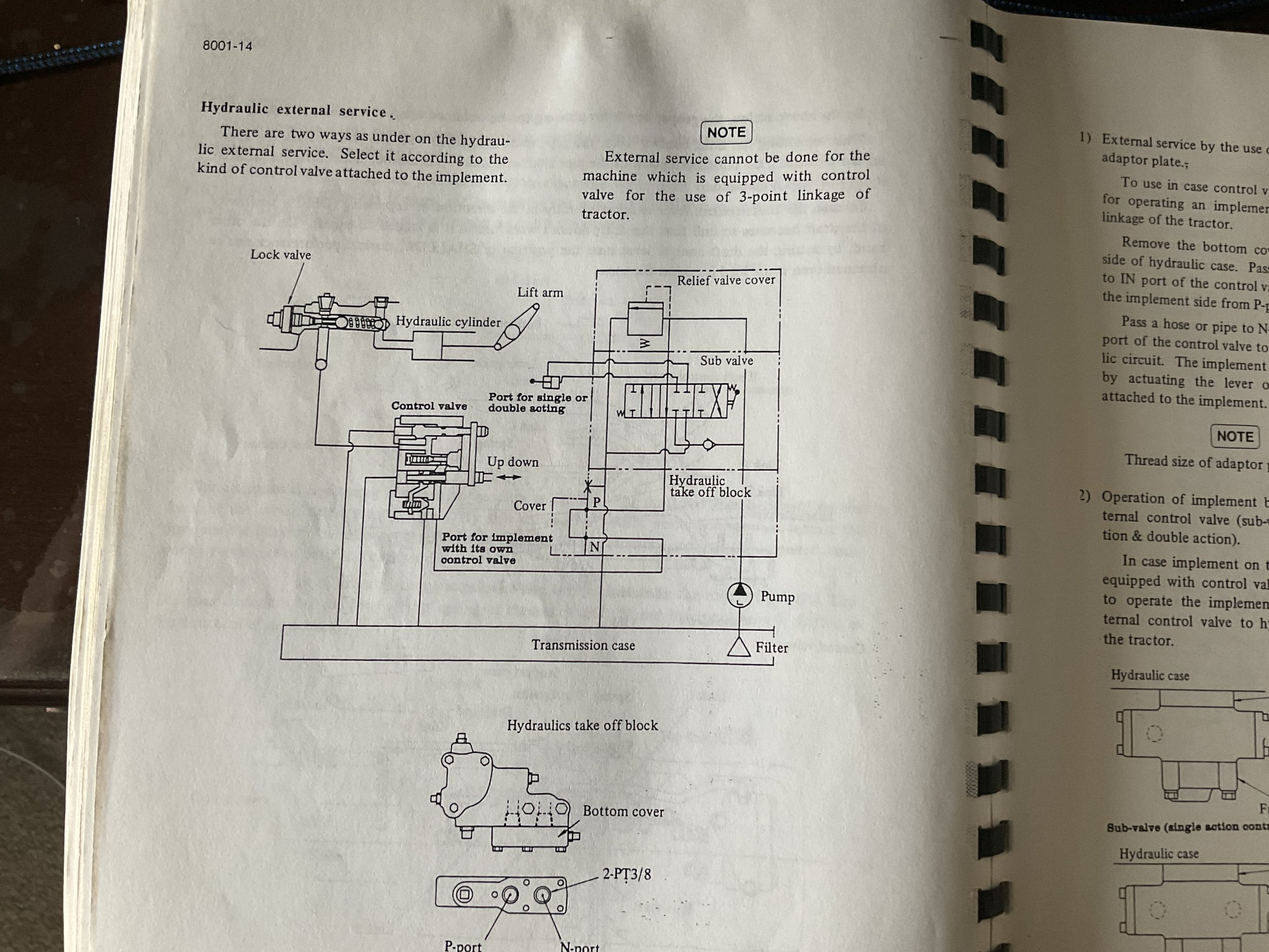

Below is information from the controller valve and how I have it hooked up, plus information from Tractor service manual on hydrauli.

The N port is what is feeding the 3ph. Are the hoses correct. The hose that is hooked to the N port on the bottom of the tractor....what port on the valve is it hooked to?
The way the block is hooked up.....you really should be feeding the n port with a pb out of the new valve and add a tank return somewhere. Otherwise you may end up with the new valve split or leaking as well

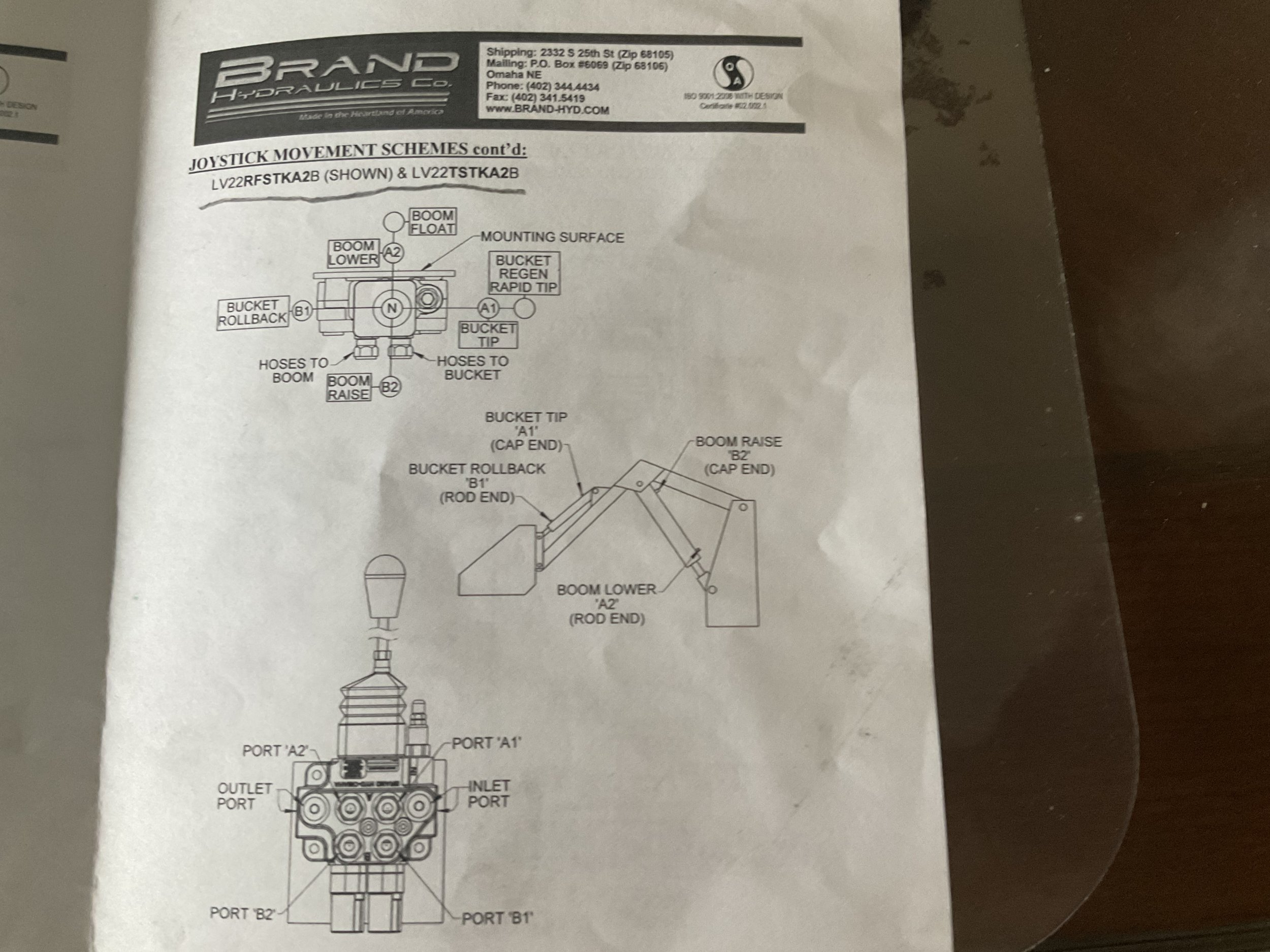

Diagram of Brand Control valve above is how it’s hooked up with with the P on inlet port and N on outlet port. I have tried to switch N and P and it does nothing. There are 6 hoses originally and none were changed. I did have to get 90 degree elbows for Inlet and Outlet connections.
The reason for the change was Top part of valve where handle attached was broke and made controls very sloppy and hard to use. I was starting to see slight leak as well.

The verbage in the manual about external service won't work for tractors equipped with 3ph control valve is concerning.
The diagram shows pump pressure should simply go in the new valve through it (since open center) and right back to n port which is the supply for 3ph.
It SHOULD have PB feeding the N. Whereas you are feeding it off the T of the new valve. But doing that only protects the loader valve and won't make any difference on 3ph performance.

I did what you said and the 3pt hitch does seem to work when I move the loader.
