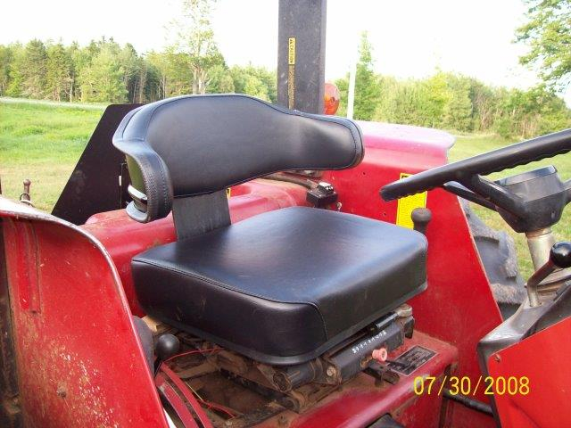

The tractor does not have the OEM tractor seat, it is a aftermarket seat on top of the OEM( I assume) seat bracket. It looks like the standard aftermarket seat available at Tractor Supply. The seat has a spring underneath it and has up down adjustment but it is rusted out. I wrapped a rope around from above to below compressing the spring to lower the seat a couple inches. I also have a 2x wood block with a hose clamp on the clutch and gas pedal.\
I want to modify the seat to go a couple inches down and forward and was thinking about removing the spring. Does the original seat have a spring with it?

OEM seat is this, has damper strut and spring, very comfy. Likely someone removed the whole thing on you and put something on that doesn't work right.
I had just put new cushions on in the photo. My feet sit flat on the foot boards, my wife is shorter than me and her feet are flat and no blocks on the pedals :)

I like those seats with a damper and spring. Our old JD has similar sort of system and it is nice. Maybe you can find an original one, but then again I do keep threatening to put a Grammar air seat on everything we own.

Try not to be too critical about the seat height/location,,
when it operates correctly,, that high seat actually has a function for you.
I have a similar high seat,, and I always wondered why the tractor was designed for a minimum 6'7" person.
I recently read about the JD similar model, it has a seat like this.
The purpose of the seat is to assist the operator in changing from a seated to a standing position, and back.
Apparently, there are tractor operations that require frequent changes from seated, to standing..
I currently have a nice replacement seat that does that exact function.
Set the seat to the operators weight, and height,
the seat functions perfectly moving the operator with assist from seated to standing, effortlessly.
When you sit down, the seat is supposed to lower by body weight, then rise as you attempt to get up.
Sorta like a handicapped lift chair, but, no need to push a button, and wait for the actuator.
I think the seat will move over 6 inches in height travel.
It is nice when you sit down, and the seat contacts you, lowering you easily, the rest of the way.
My seat came from Welcome to KAB Seating , but, I do not see my model there now.
I did buy my seat 15 years ago, and it still works like the day I installed it.
