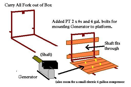

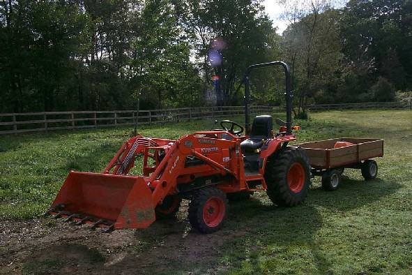

I have a similar unit. I drilled some holes into it and bolted down some 2 x 6 pressure treated to make a platform and a back on it, then I bolted this NorthStar PTO Generator — 7200 Watt, 14 HP Required |PTO Generators | Northern Tool + Equipment to it.
The Northstar is easy to take off and put on. Nice to have some current and a small compressor to move around with when the tractor is in the field. When the generator is off, I can get a lotta stuff on that carry all.
If not, I'll hook up my dump wagon ...

If your frame is like the KK discussed (see image), then I don't understand how the Genny PTO shaft runs ...
See attached ... I dont have the center strut ... The cam needs a battery charge so I whipped up a drawing .. sorry :rolleyes:
