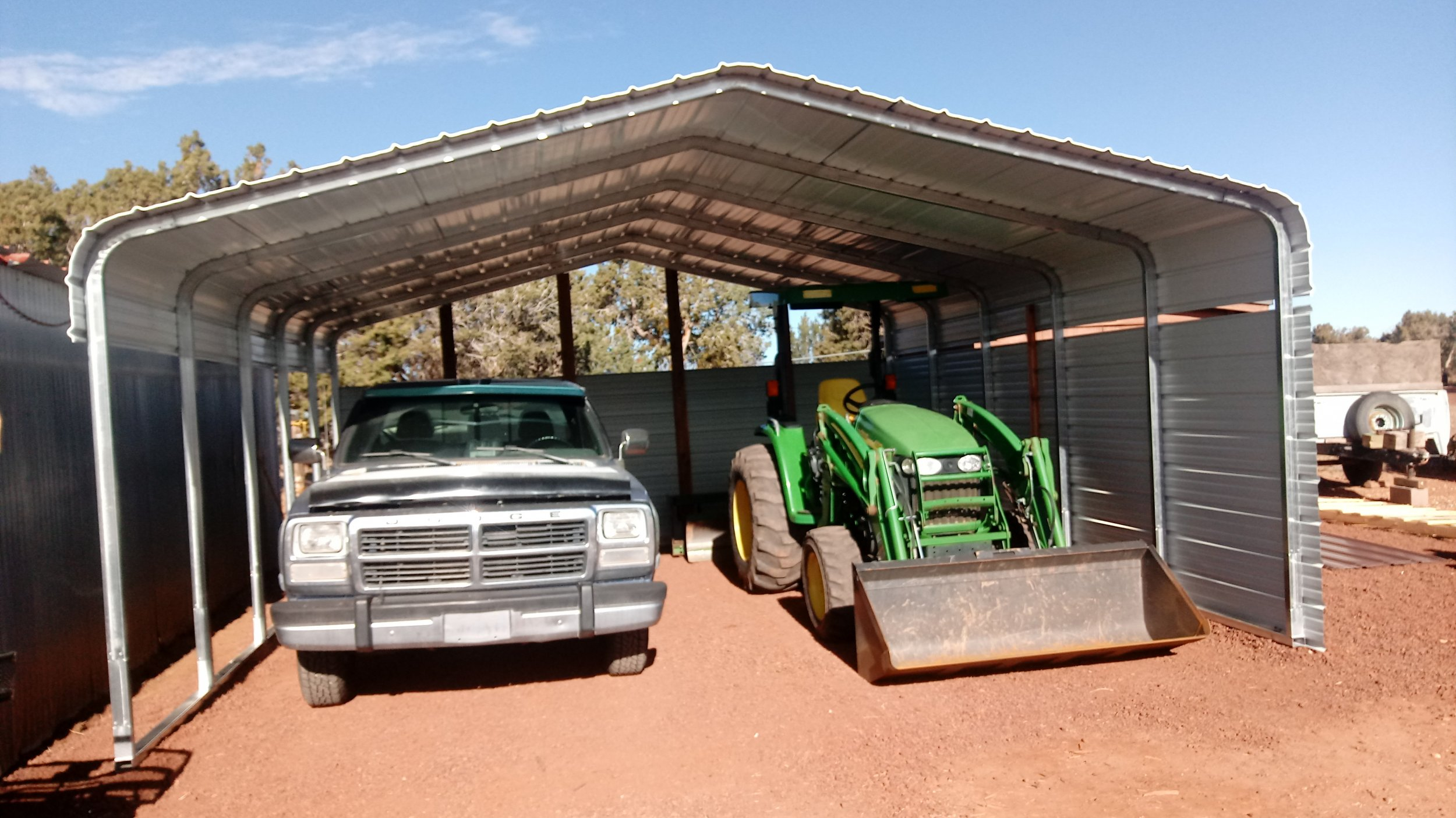

All, question what do you think this carport weighs?
I want to move it and I am thinking about moving it without taking it apart.
Its 24’x24’ and post’s are 9’ tall. The posts are 2.5” square.
