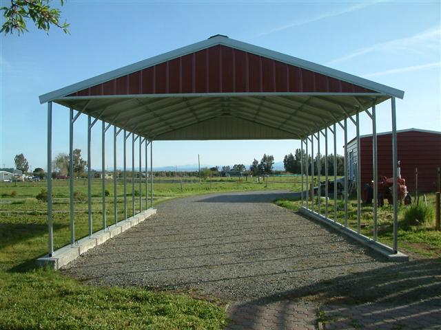

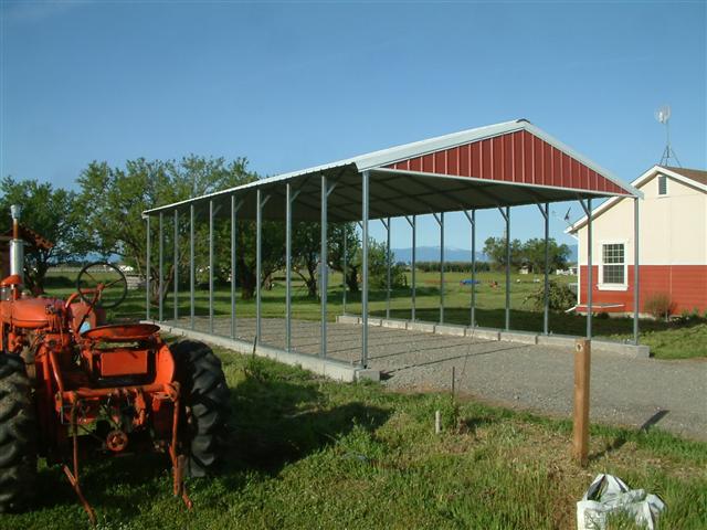

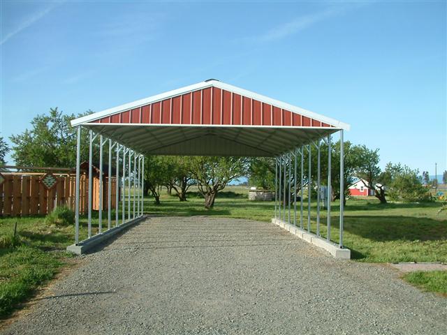

I had this carport (20 x 36 ft with 9 ft sides) built two years ago.
Bought it from Carports and More in Fair Oaks, CA (near Sacramento) 916-224-9977 Jerry Azevedo.
It's manufactured by American Carports Inc. in their Colusa, CA facility.
In Tehama Co a carport that size needs wet signed engineering drawings that were supplied by American Carports. No problem pulling the building permit.
I handled the concrete footings myself--about 6 yards needed.
That carport has the side-draining roof option and cost about $3K installed.
There doesn't seem to be any diagonal bracing. I can't believe that survives a windload, are there thin cables that aren't visible in the photo?
