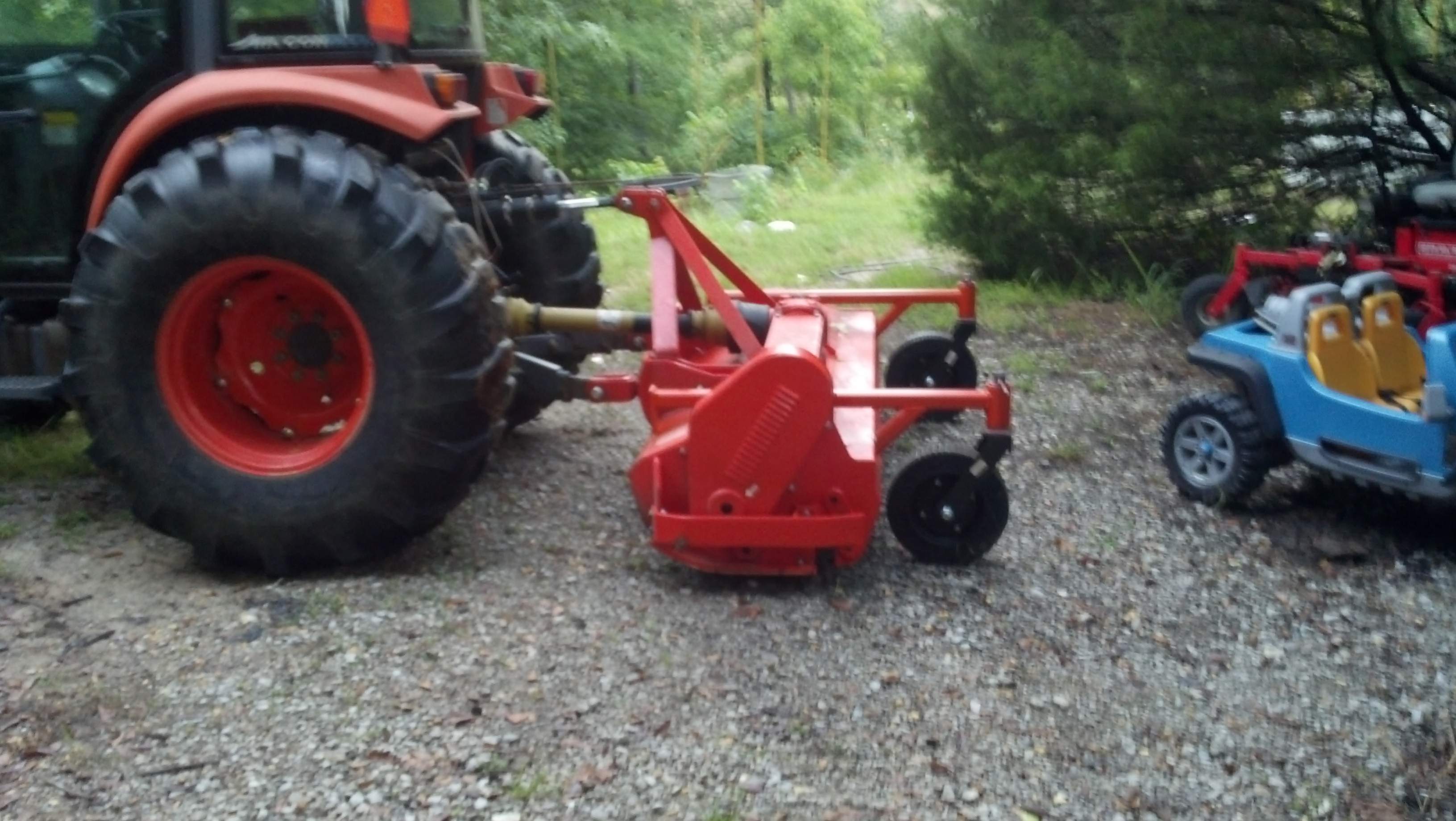

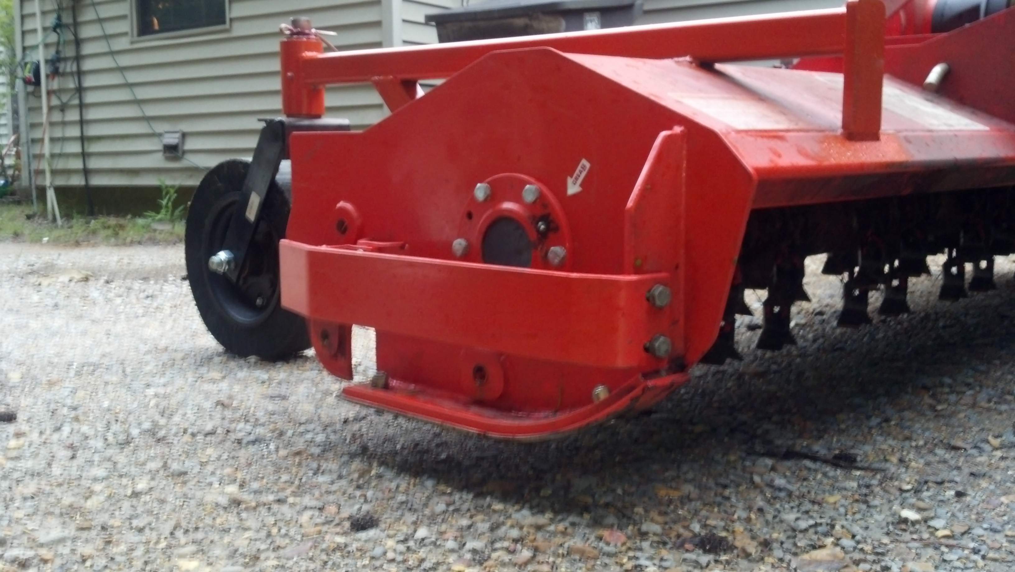

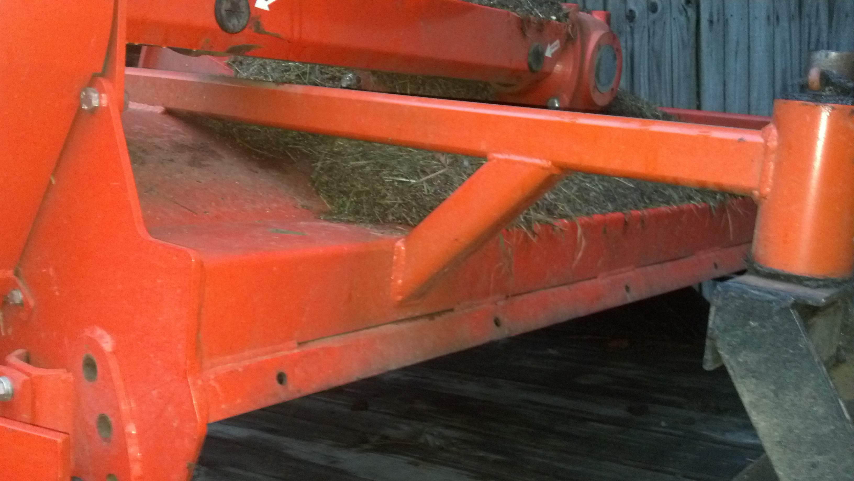

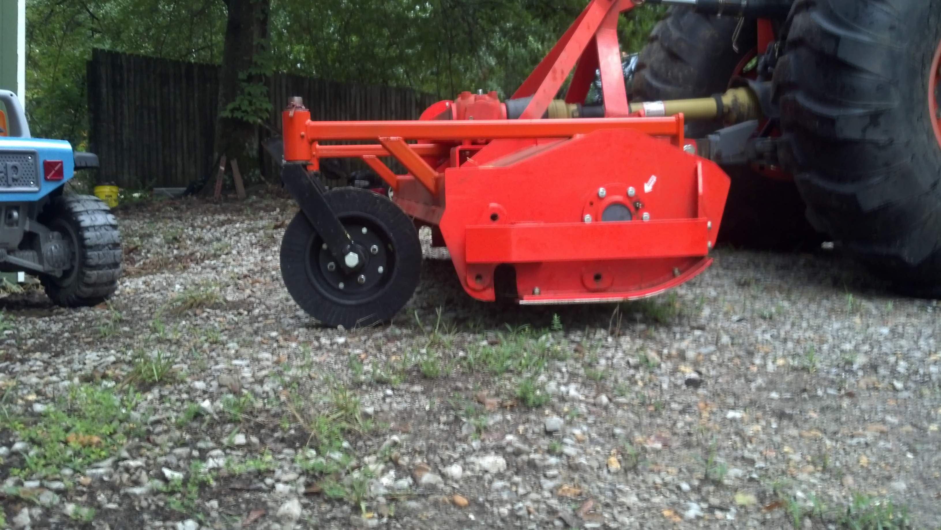

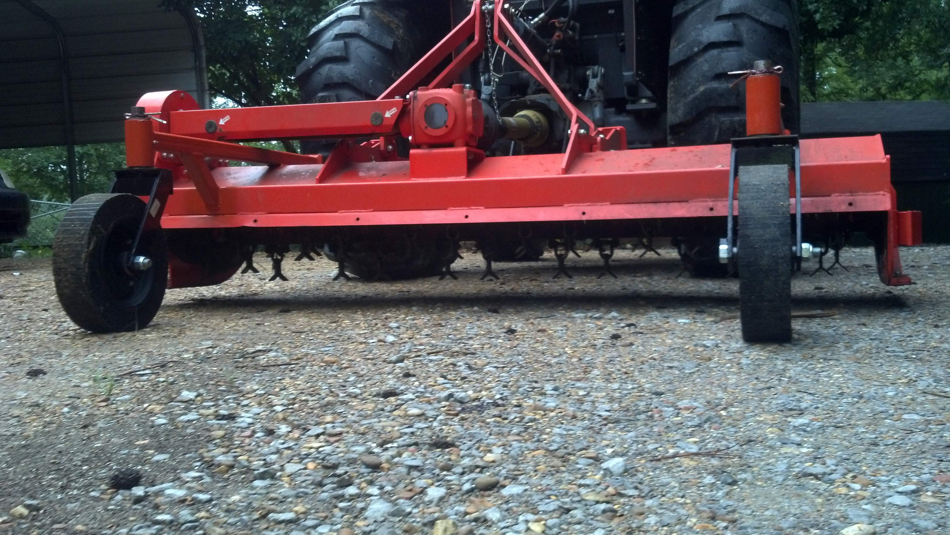

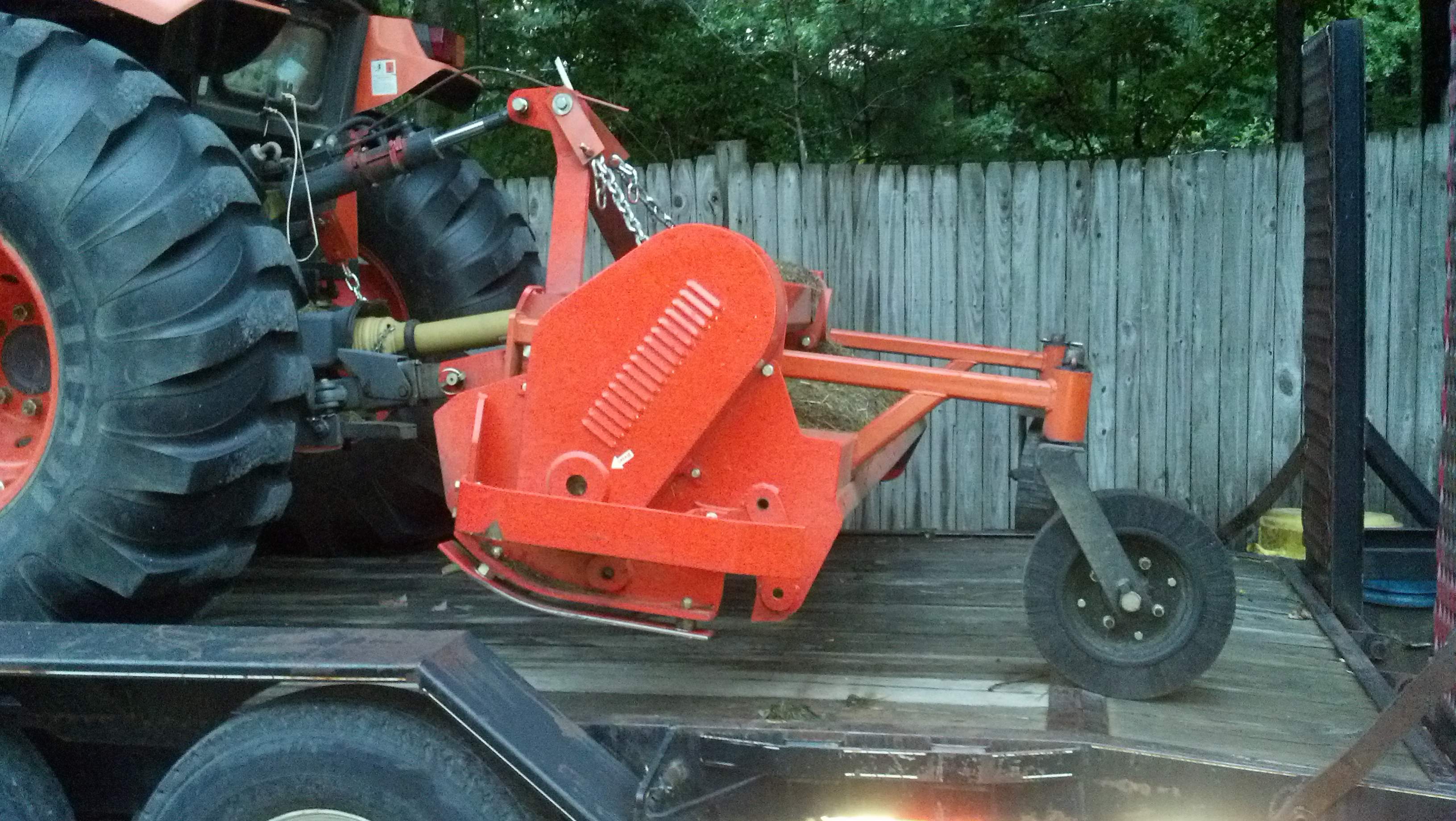

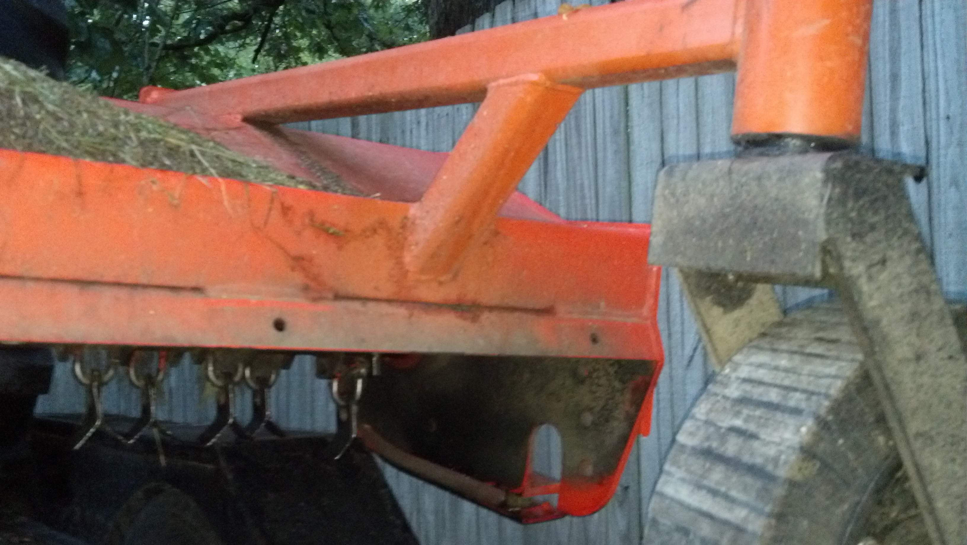

Ok so here is my fix for my roller problems i just finished it and mowed with it and it perfect at least for now. It acually has a rear dishcharge now and will cut going backwards. and when i cross gravel or asphalt its quiet rather than the rumble of the steel roller crushing gravel. past experiance with bush hog wheels makes me think it will be a while till i have any problems again.View attachment 273109View attachment 273110View attachment 273111View attachment 273112

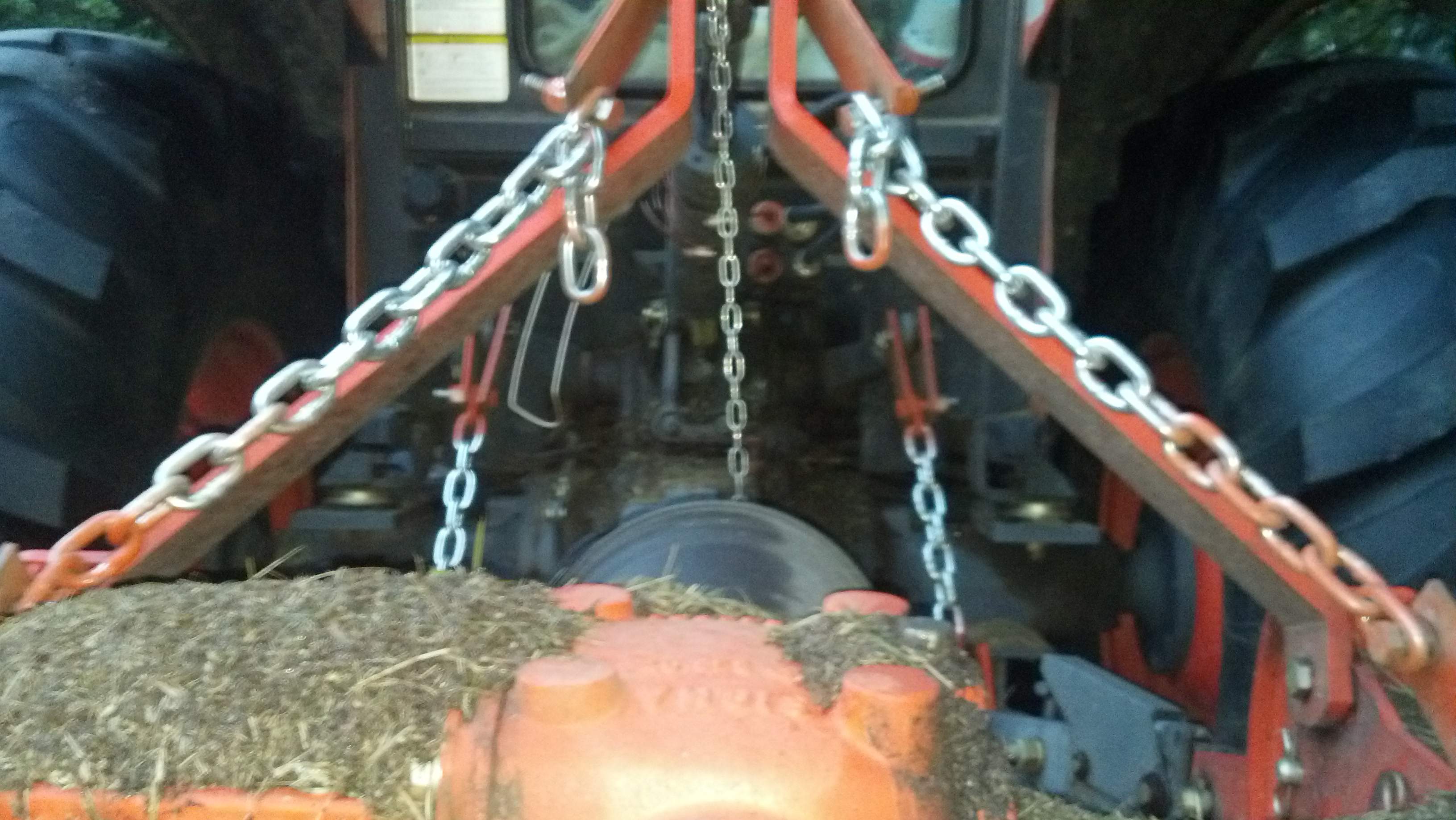

since i last posted on this i have replaced one of the braces on the flail with two chains so i can use my hydraulic top link to give slack so the flail will go in and out of ditches and flex with the contours of the ground better.
