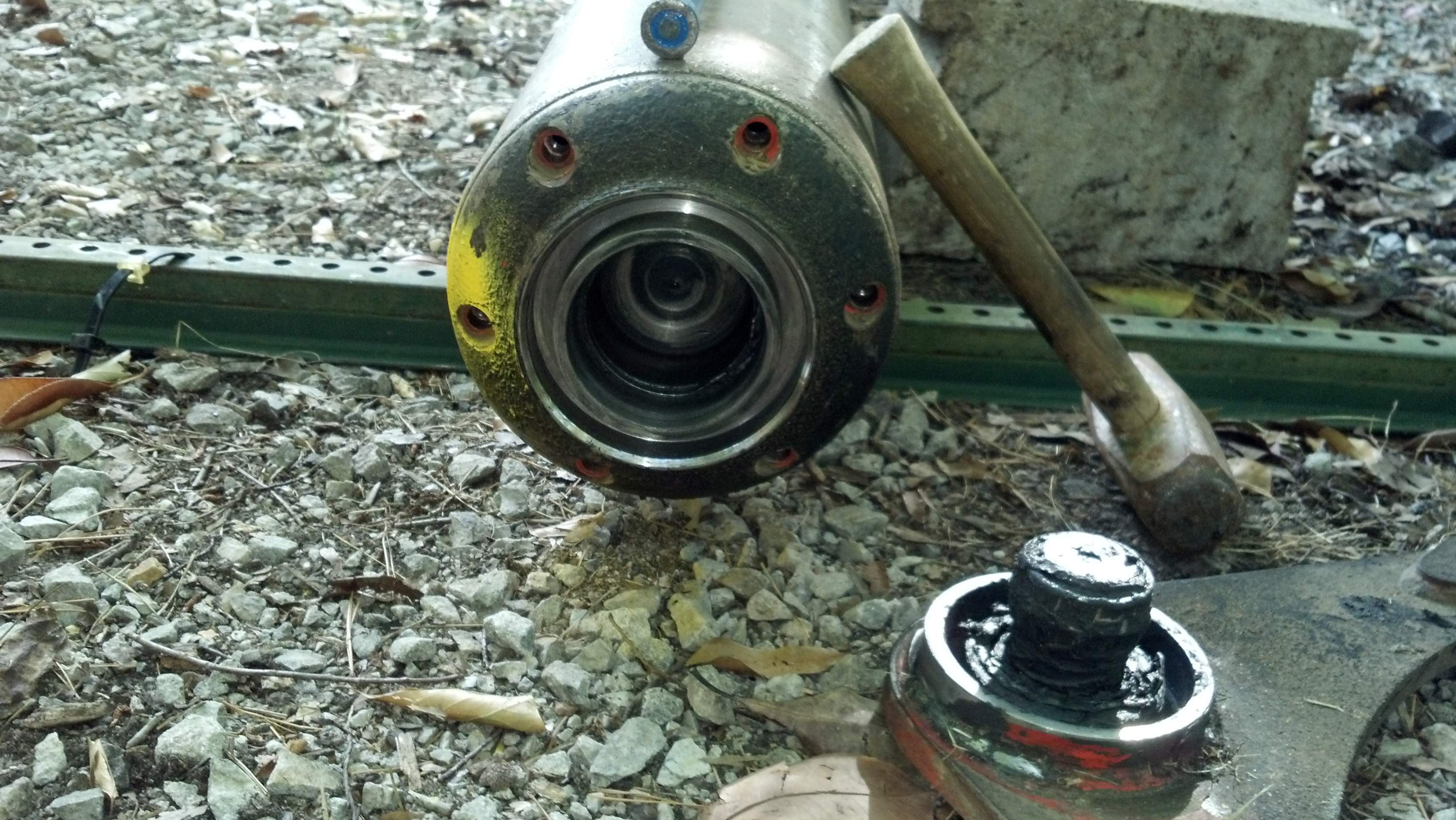

I could not crack the bearing race with a cold chisel and hammer. I even tried heating up the piece.
I finally used a diamond drill and that worked.
Now to tackle the outer race in the roller ends.
I might try a cutting torch.

Dana, was that race frozen to one of the axle stubs? Looks like that was a pain to get off. Do you have to buy the replacement bearings from Caroni or can you get them elsewhere ?Joe
Joe, the race was not frozen but it was what I call a press fit. The diamond drilling took about 30 minutes on a drill press. I'll probably order the parts from Agri.

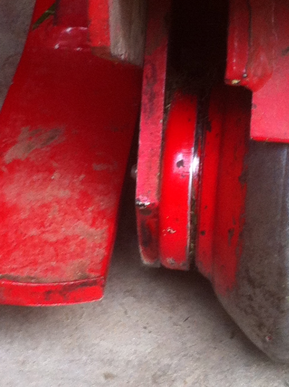

I'm eager to see how this goes back together with the new parts. Please keep us posted. I've got a few questions but will hold them until your finished. I don't want to pester you with a lot of mundane questions. I think I may have done something to tweak the roller mounts on my flail. One side may be splayed outwards and this is what is causing the side-to-side slop in the roller.

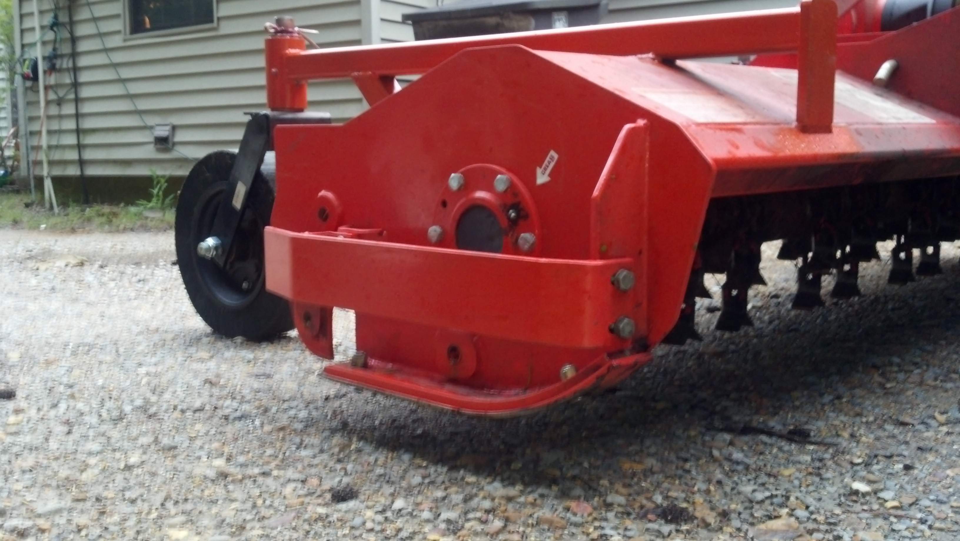

View attachment 272263View attachment 272264must be something in the air. Mine did the same thing and my mower is only a year old. I added grease every time i mowed and it still failed but i think the problem is because i mow in wet conditions in the spring time and moisture and grit is getting into my berrings especially on the offset side that i use to cut the lowest part of diches with.

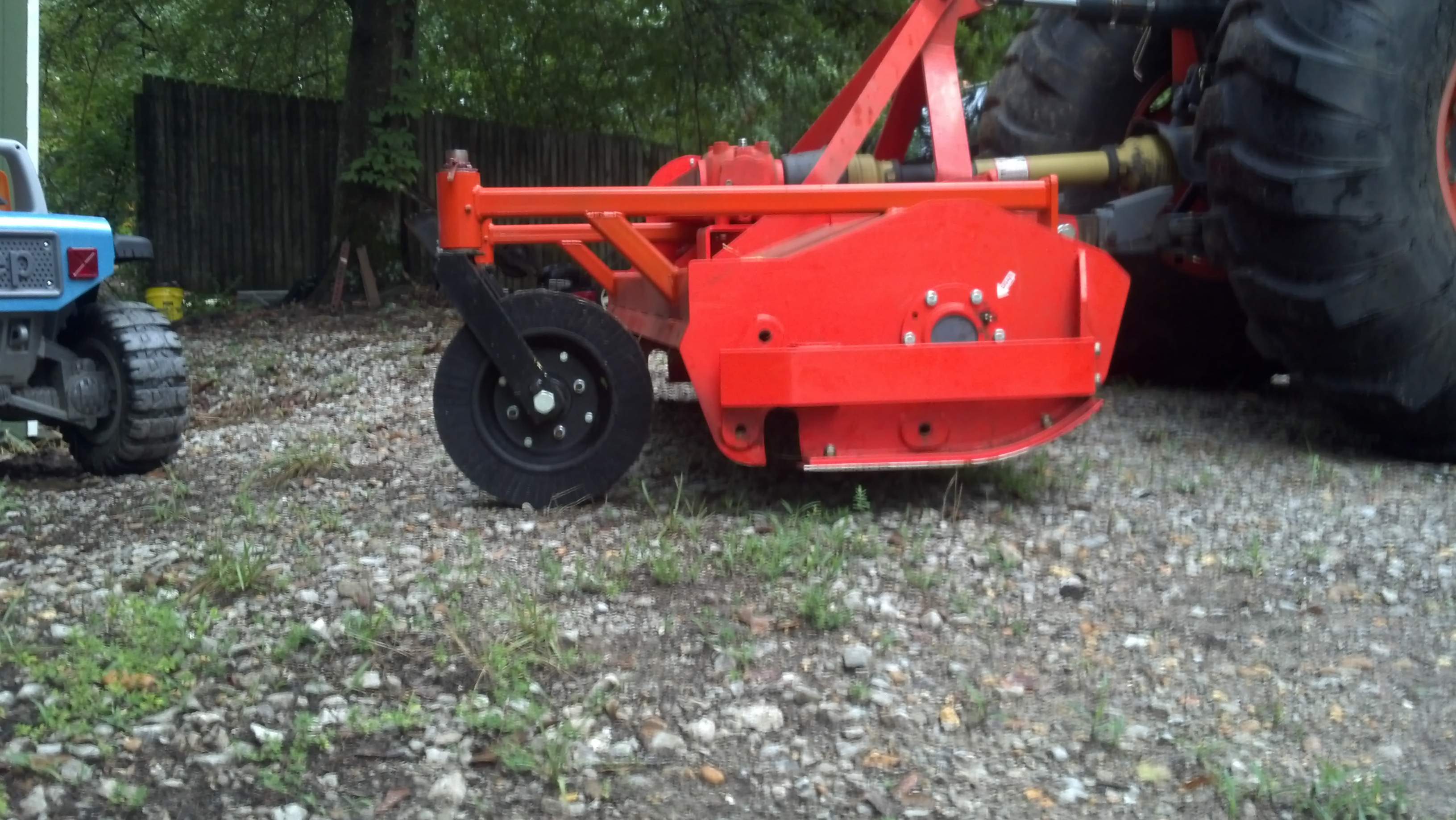

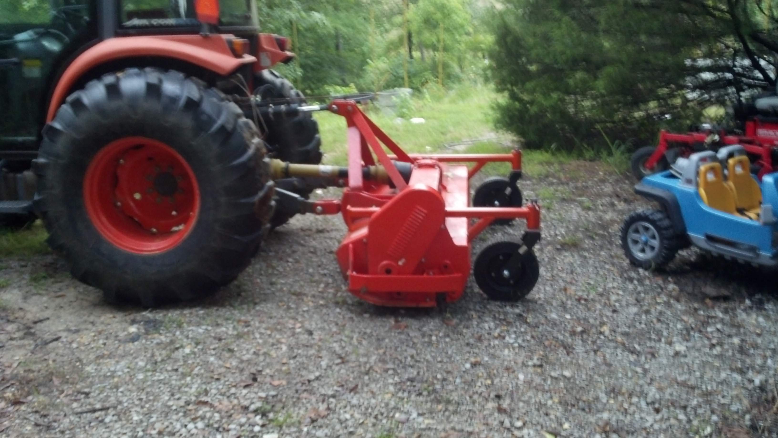

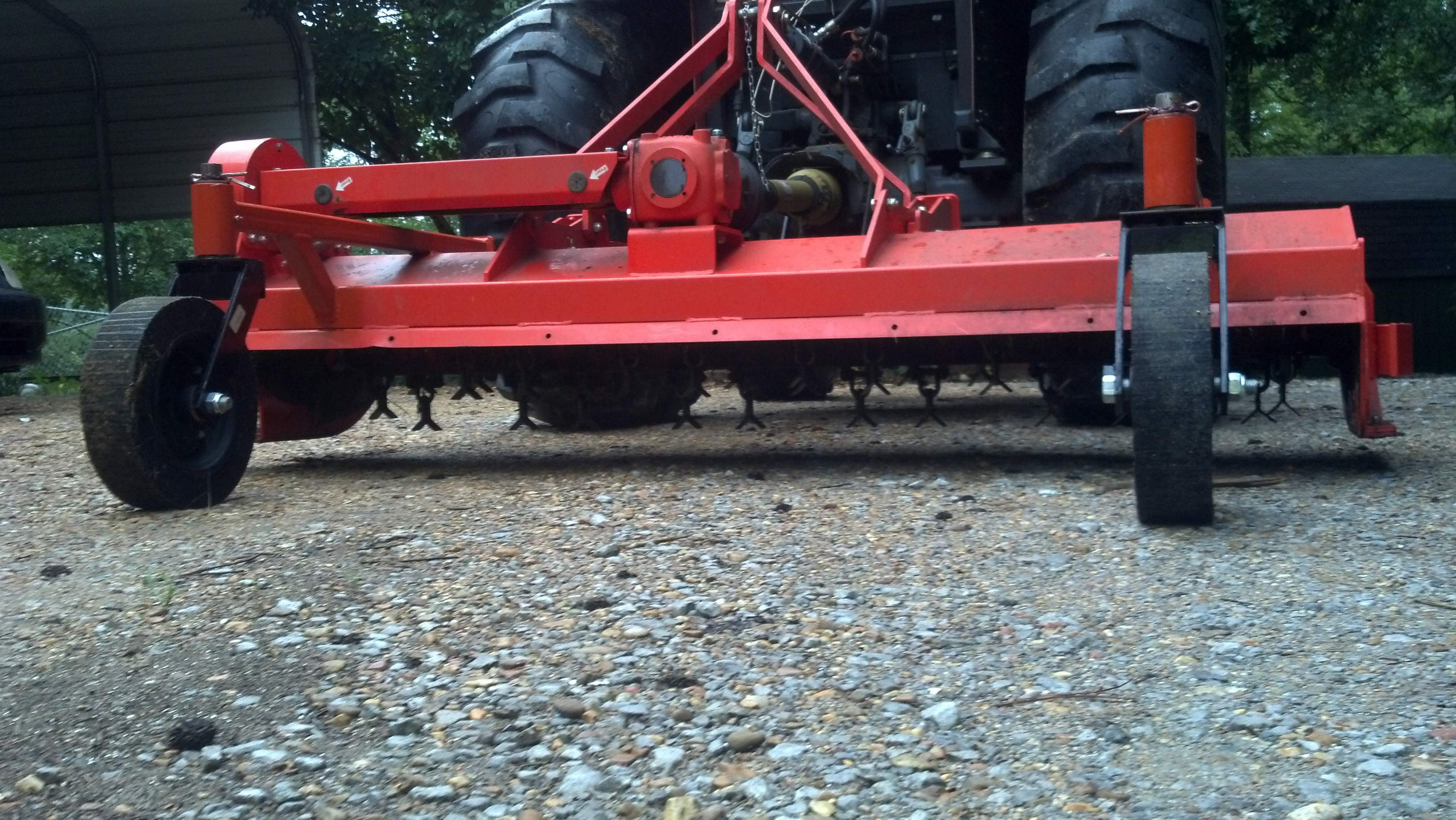

Im going to be going a differant rout on the repair this time im going to remove the roller and replace it with two bush hog tail wheels. ive been thinking about this for some time. with the roller out of the way it will cut going backwards too and the roller wont interfear with the discharge of tall grass as much either. anyway ive always ended up modifiying my mowers for better or for worst.
Ok so here is my fix for my roller problems i just finished it and mowed with it and it perfect at least for now. It acually has a rear dishcharge now and will cut going backwards. and when i cross gravel or asphalt its quiet rather than the rumble of the steel roller crushing gravel. past experiance with bush hog wheels makes me think it will be a while till i have any problems again.007.jpgView attachment 273110006.jpg005.jpg

I closely examined the bearing for any markings. What I found was not stamped but looks like etching. The marks are CF and 205.
I put a new battery in my Harbor Freight digital caliber and this is what I got.
Outer diameter is 52mm with a thickness of 18mm. I was not able to nail down the inside diameter as I was reading a different size on multiple tries. It varied from 24.66 to 24.85.
I measured shaft size of the support. It is 25mm. I was not able to slip the bearing on the support shaft by hand but I have a bit of peening from trying to beat the inner race off the shaft.
So lets call it 52x25x18mm.
