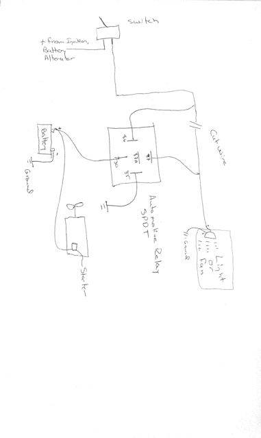

So, I am going to try and give a bit back. I feel I have gained so much and given so little.
I like relays, a lot. Switches are seldom designed to handle current much more than an amp or two, and they are generally expensive and difficult to replace, especially when it is your ignition switch.
So, here is a little drawing on how to install a relay to reduce the amps through your switch. The relays I speak of are automotive, can be found anywhere, and cost $2.00. You can get bases for them that make wiring even easier.
First, always disconnect your battery when you are doing electrical work.
Basically, find the wire running to your device that you want to put a relay on. On my 1850 I installed additional lights, and relayed them with fuses. I found the lead from my switch to the lights and I cut it. I then ran a thicker guage wire from my starter block (follow the positive batter wire to your engine and there it should connect with the starter and have lots of other connections) (or you can do it from your battery post). Anyway. You connect that new hot wire with a fuse to your relay, you connect the wire you cut from the switch to your relay, and you connect the wire to your light or fan to the relay. Then you run a ground wire off your relay and ground it to the tractor (i generally use the screw I am using to mount the relay to the body of the tractor as the ground as well).
One late note, and one not on my drawing, I always put a fuse on the wire running from the battery / starter. Just a good policy to get into. I ususally put it on next to the relay so when I have to tech a problem I know that the fuses are next to the relays...
Most auto relays have the same wiring pattern and number at the bottom. 86 is from your switch
85 is to ground
30 is from your battery
87A is left blank but protected so it does not touch anything else (it is hot when relay is in rest mode)
87 is to your device.
Many I hope this makes sense. Hope it helps someone as well. It is quite easy to do.
Here is a link with a better drawing of the bottom of the relay, and a picture of one too...

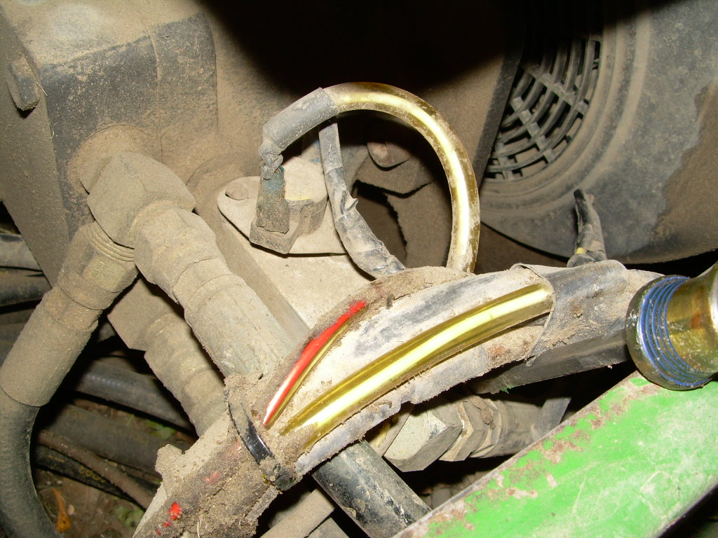

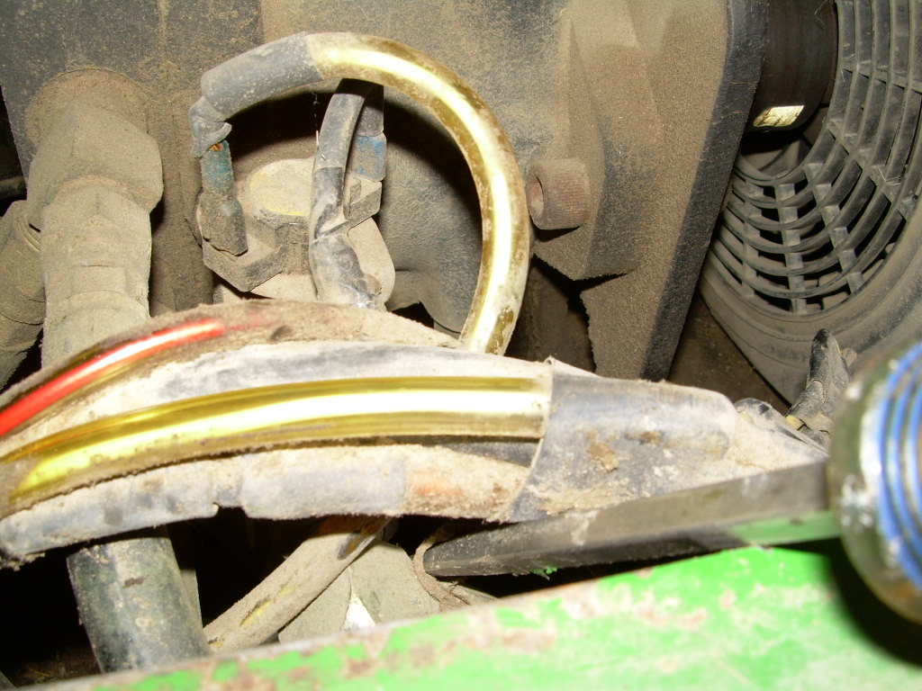

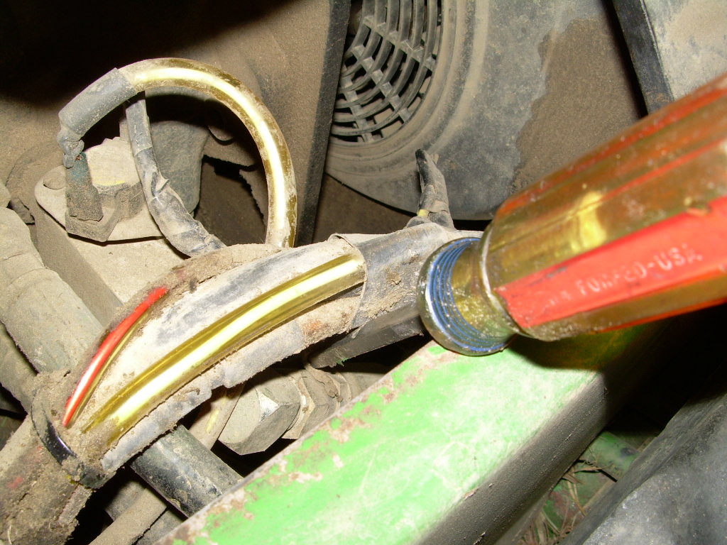

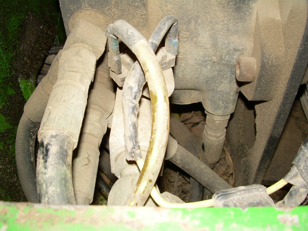

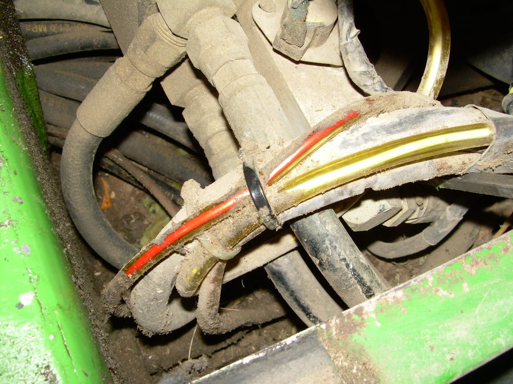

Yes, there should be a wire on each side of the "thermal relay"
The missing wire goes into the wiring harness. See attach pictures for it's location. It comes out of the wiring harness right next to the scewdriver that I am using to hold the wiring harness in view and away from the side.
Yes, you can jumper those wires together and make the fan run whenever the key is on. You can run it from the white wire. My guess is that the lug has broken off of the white wire.
The white wire is in a clear plastic tube (which I might have installed, but I don't think so). The wire runs from where the screw driver is, forward and then undeneath the wiring harness and over to the "thermal relay".
You could run your own wire through the tunnel and up to the ignition switch if you cannot find the existing on.
If you have a meter you can check the wire. If there is voltage on it when the key is on and no voltage when the key is off, then it is probably the right one.
The "thermal relay" is a temperature switch which I belive cuts on at 130 deg F. I believe it is commonly used in clothes dryers. I have replaced mine once.

Bob...yes, that is exactly the setup! My white wire going back to the harness is also in a clear rubber tube, but it does not have the right connector to fit on the other side of the relay. It has a different type than the push on spade that is from the fan (with the fuse).
{I am definitely going to be calling that service center I used, it almost seems deliberate. If the connector broke from the wire, the push on spade connector should still be on the male fitting of the relay, and the white wire would show a break, not a different connector.}
After talking with Carl the last time, I went out and checked the relay using the ohm meter, and it is working like it should be when hot & cold.
I then checked to see if the white wire in the clear rubber tube was hot with the ignition key on...it was.
Then I took a nail and put in the connector on the white wire and touched the push on spade from the fan with the fuse, and the fan came on...so fan is good.
So, I am thinking I will change the connect on the white wire to a push on spade and put onto the other side of the thermal relay.
