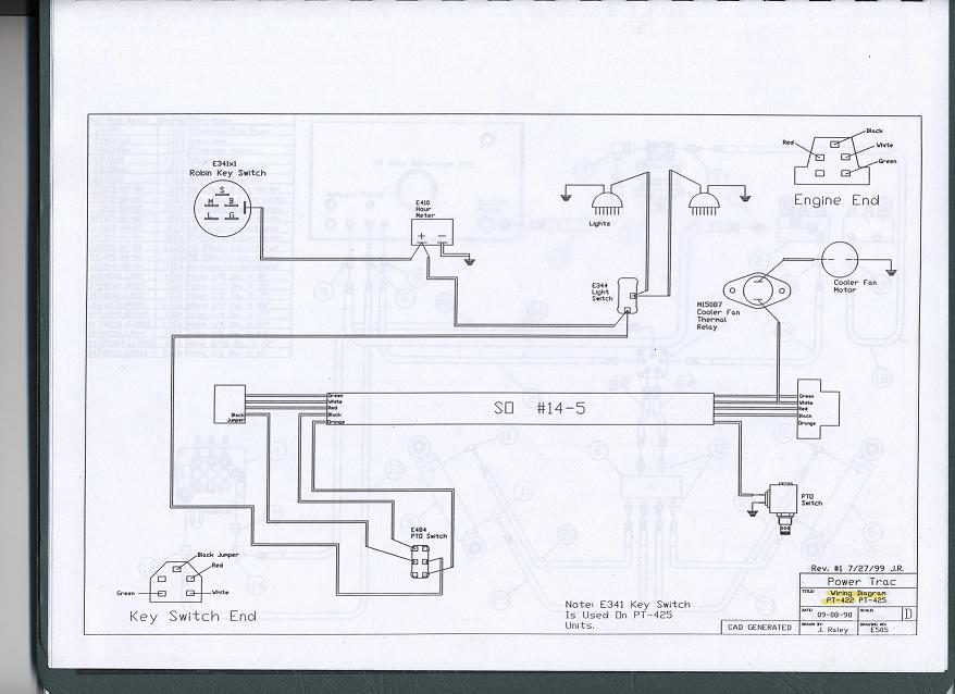

I have a 2422, with a Robin 25HP engine--should be close enough. Your schematic shows a multiconductor cable with a white wire (this is the one you haven't been able to find) going to one terminal of the thermo-switch. Find that cable in the area near the thermoswitch and find the white wire, follow it to the end of the white wire. There should be a terminal on the end that will plug on to the thermoswitch. The other terminal on the thermoswitch is already connected to the fan.
If you have trouble finding the multiconductor cable, follow the wire from the PTO valve until it joins the multiconductor cable. You should then be able to find the white wire.
If all else fails, you can run a (fused the same as the present fan fuse) new wire directly from the battery to get you going until you can find the correct feed (white) wire.

There are two wires coming from the fan, one goes to the fuse, and then continues to the relay. The other one goes to a bolt on the tractor for ground.
As for checking the relay using an ohm meter, shouldn't I go across the terminals of the relay (when cold shouldn't have anything) and then when hot I would have a change.
Does this sound anywhere close, or am I missing your point all together?
Yes, that is advanced electronics :) But, make sure you unplug the other clip or take out the fuse. You can never be too sure of where a wire came from. Some volt meters are sensitive to reading ohms and taking a voltage hit. Check the resistance cold and hot. Cold should be open circuit and hot engine should be close circuit.
OK. Now looking at your note it appears to me you do not have any HOT (+) power coming to that relay. Just to make sure you are saying the fuse wire in the picture is coming from the fan.
So, you need to get some juice from the battery to the fan. If it where me and I had the patience, I would not let the load (the amperage needed to drive the fan) run through the ignition switch. Instead, I would take the switched lead from the ignition switch and run it into a relay (These are automotive relays, cost about $2) I would then take a hot lead off the battery or starter area and run it into the relay, using the switch to activate the relay ( this does not make sense - let me draw it, scan it and post it).
Carl

BTW: "what does 'SO #14-5' mean on the wire diagram?"
The SO refers to the insulation jacket on the multiconductor cable, SO means 600volt insulation flexible; if it were SJO it would be 300volt insulation flexible. #14 refers to the wire gauge of the conductors, 5 is the number of conductors in the cable. In short, just a description of the multiconductor cable.;) Hope you are able to get going quickly.:)

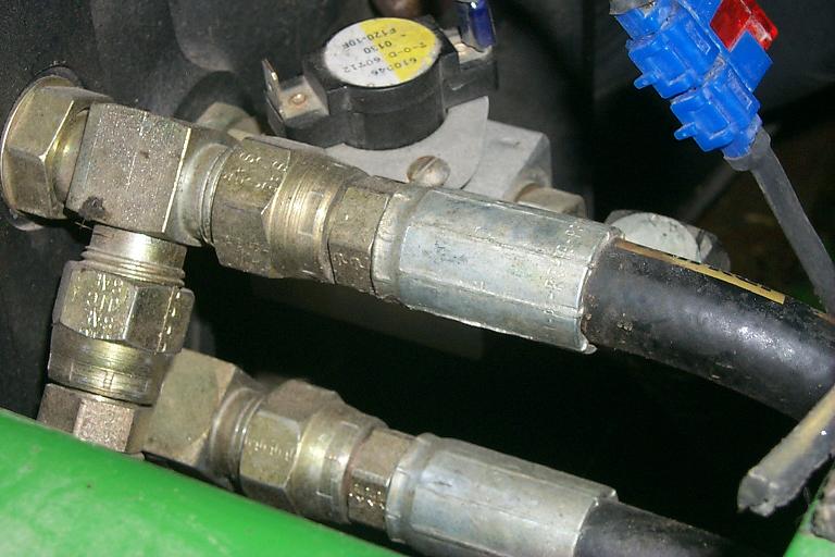

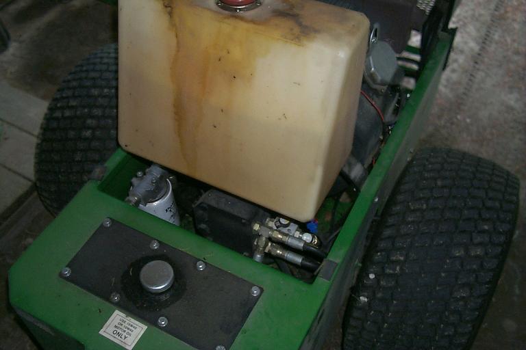

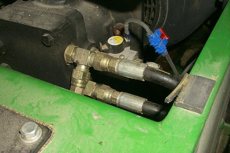

Yes, there should be a wire on each side of the "thermal relay"
The missing wire goes into the wiring harness. See attach pictures for it's location. It comes out of the wiring harness right next to the scewdriver that I am using to hold the wiring harness in view and away from the side.
Yes, you can jumper those wires together and make the fan run whenever the key is on. You can run it from the white wire. My guess is that the lug has broken off of the white wire.
The white wire is in a clear plastic tube (which I might have installed, but I don't think so). The wire runs from where the screw driver is, forward and then undeneath the wiring harness and over to the "thermal relay".
You could run your own wire through the tunnel and up to the ignition switch if you cannot find the existing on.
If you have a meter you can check the wire. If there is voltage on it when the key is on and no voltage when the key is off, then it is probably the right one.
The "thermal relay" is a temperature switch which I belive cuts on at 130 deg F. I believe it is commonly used in clothes dryers. I have replaced mine once.

Bob...yes, that is exactly the setup! My white wire going back to the harness is also in a clear rubber tube, but it does not have the right connector to fit on the other side of the relay. It has a different type than the push on spade that is from the fan (with the fuse).
{I am definitely going to be calling that service center I used, it almost seems deliberate. If the connector broke from the wire, the push on spade connector should still be on the male fitting of the relay, and the white wire would show a break, not a different connector.}
After talking with Carl the last time, I went out and checked the relay using the ohm meter, and it is working like it should be when hot & cold.
I then checked to see if the white wire in the clear rubber tube was hot with the ignition key on...it was.
Then I took a nail and put in the connector on the white wire and touched the push on spade from the fan with the fuse, and the fan came on...so fan is good.
So, I am thinking I will change the connect on the white wire to a push on spade and put onto the other side of the thermal relay.
