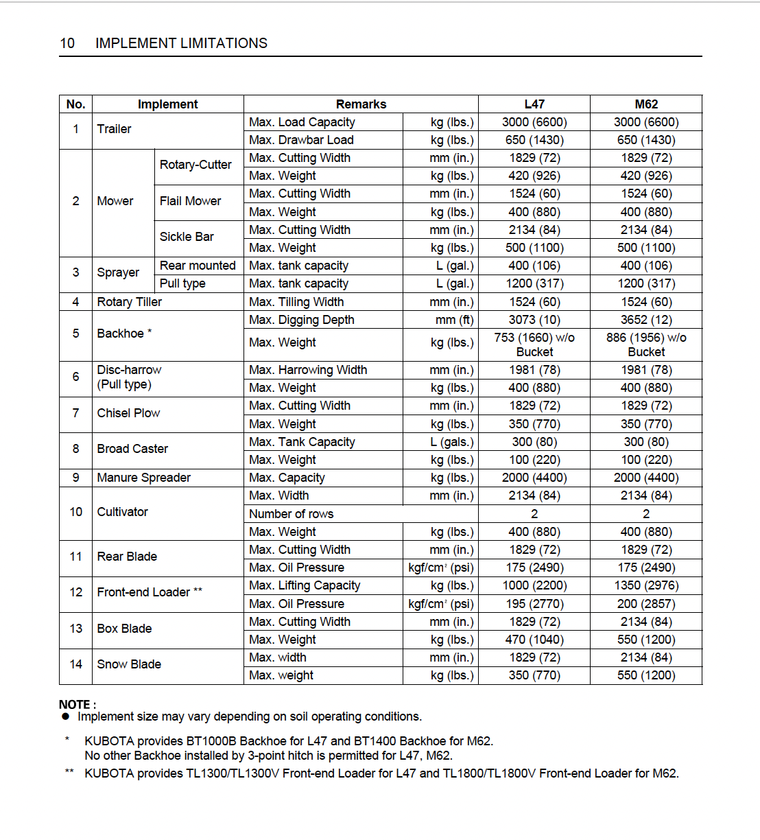

I guess it really comes down to the PTO hp of the L47. Will 33 hp be enough to run a 5 or 6 inch woodchipper or a 5 foot flail mower?
From the Operator's Manual for the L47 & M62 :
