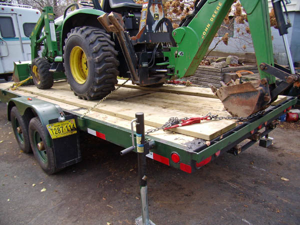

I'm in the replace the trailer camp. It seems to me all the solutions needed to load your tractor & hoe are a major pain in the ... Looking at your tractor on your trailer picture--the first thing that comes to mind is too small a trailer and overweight. A safety cop might think the same thing even if you are legal in all respects. Do you want to be hassled every time you move your tractor? Surely, there are trailers out there (think good used) that would solve this issue in all respects. And, selling your current trailer would help offset the cost. Mike.

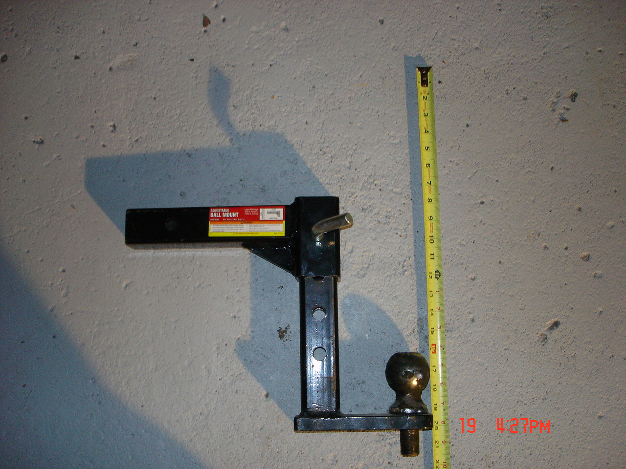

This might just work.
I have an adjustable trailer hitch on my truck, I think it is a Reece. I paid about 30 dollars for it on clearance at Wal-Mart. :D
I was just discussing this gizmo with a friend yesterday - it IS a great solution, and I might just end up there - although price might be a problem, unless I find one on clearance at WalMart ;).
It is a little short, but far from overweight - its a 10,000# trailer and a 6000# tractor. However, a better trailer would, of course, be the best final solution. I'm working with what I have, at the moment...

I actually have 2 of them, one is a harbor freight model that was very inexpensive. The only thing wrong with it is it is only rated for 7,500# probably right at what your tractor and trailer weigh. I think it was around $20 on sale, $30 regular price. It has a 20" range of adjustment but you would have to remove the ball and re-mount it on the other side to get the full range or just mount one on both top and bottom...:D:D:D

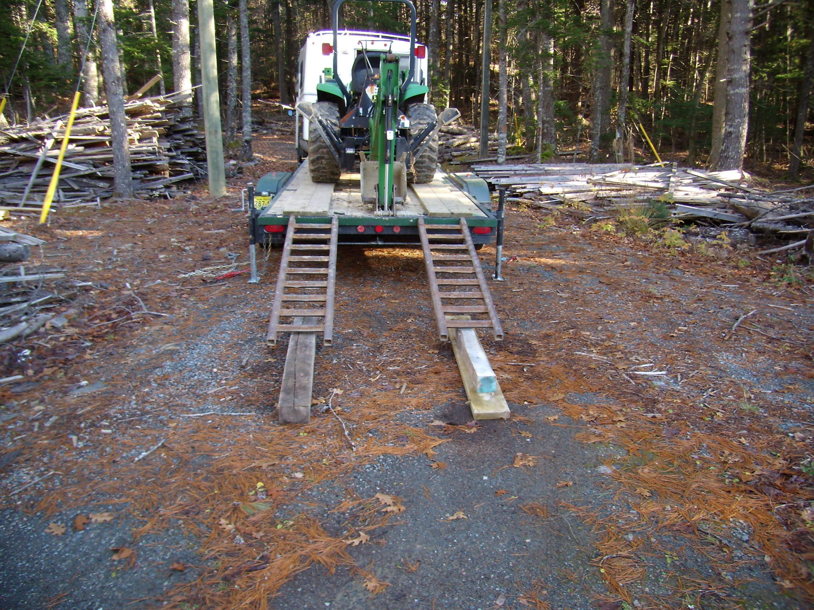

Had to load and unload mine today. just some scraps of wood managed to get me off and on.:D

Do I see ramp 'feet' on your trailer ramps ?
If you raise the front of the trailer, are you still going to be able to drop ramps with those 'feet' ?
