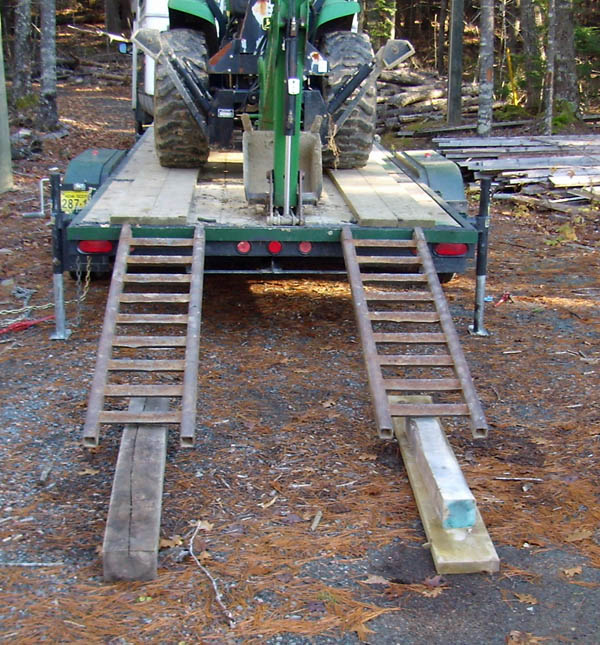

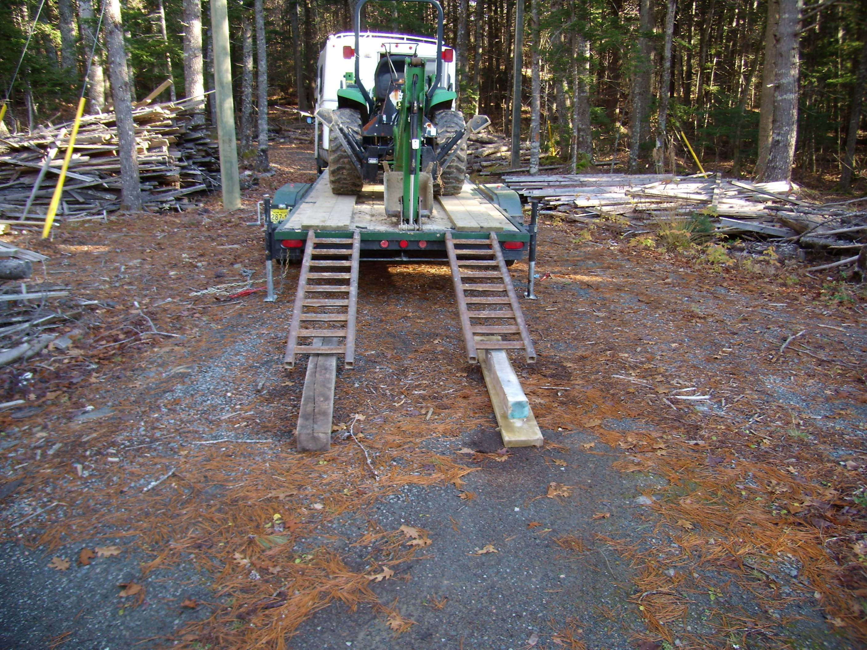

OK All - it's done. 4@ 2x10 planks made into a sub ramp, that reduce in 6" increments from 5.5' to 4' long. Blamo. I put handles on the ramps so that I can lift/carry them too. Thanks for all the suggestions and spirited debate.
JayC
Looks great and with a simple solution!!.. I am sure you securly fastened all the boards together? If not I would definately do that ASAP..
I found balanced center of my sub ramps took some 1/4" or 3/8" rope and fasten the rope to the sides making some rope handles this made handling and moving them much easier probably similair to what you did...
Looks like a good solution. Same as lengthening the ramps, doesn't require steel or a welder though.

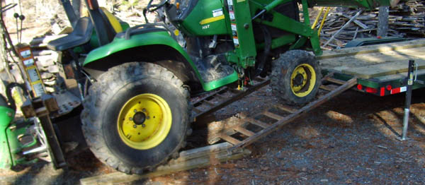

Yea - once I got the ramps put together enough to get the tractor's back wheels onto the metal ramps, I got an amazing amount of drop in the back. If I could've figured out how to make the trailer do that earlier, I wouldn't have needed the extra stuff!

All of the boards are nailed together. I bought 4 chest-handles (fold down flat) on sale from Lowes and mounted them on the same side of each ramp. I grab both handles and hold the the ramps across a thigh (they DO weigh roughly a million pounds each).
