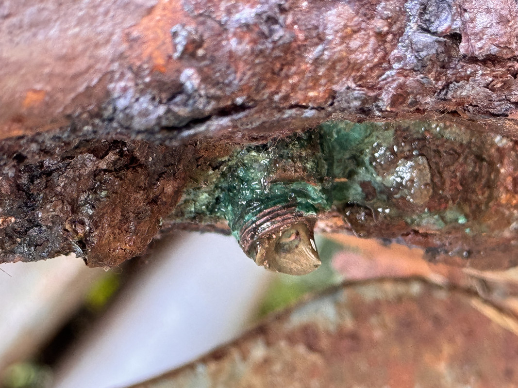

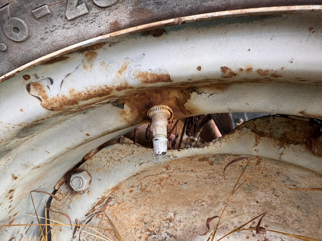

Tires on, holding air. Went to pump up the rear and this is what I found.
It's supposed to look like this:
The stem threads into a piece. Where can I find the stem that threads in?
/ Can't just retube that #66
Possibly a Milton? Tractor Supply carries them, but you'll want to confirm thread/hole size:

Well then...
I know we're focused on the rim here, but look at the sidewall on the tire. Those big cracks and discoloration don't look good either.
