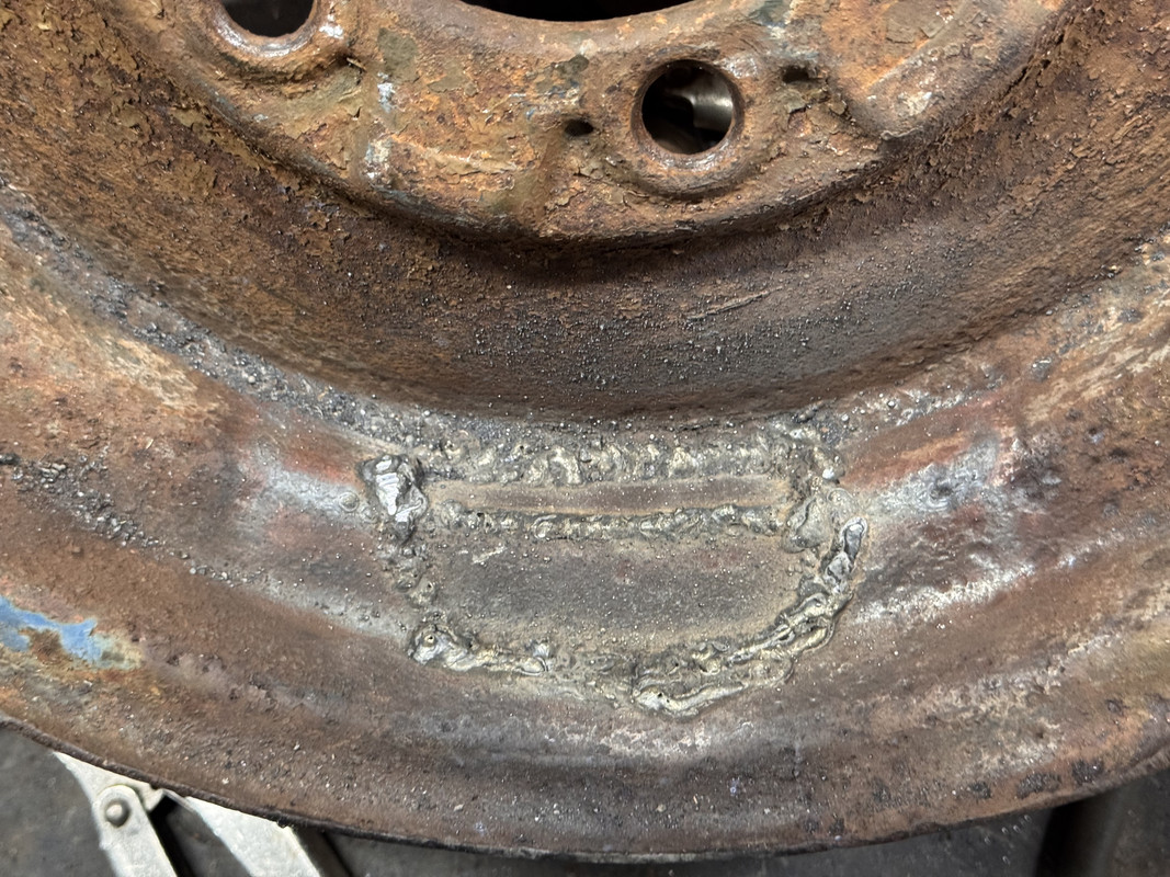

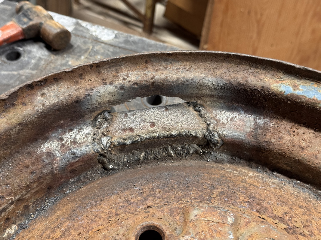

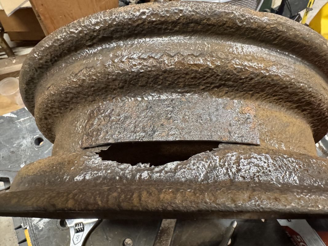

As I'm half your age, I feel like I should at least make the attempt. But I'll say, if this doesn't work, I'll be placing my order for a new rim without hesitation.
I did inflate the tire, then deflate to make sure there weren't any wrinkles. Then I inflated to 6psi and bounced the tire around, 10 psi and repeat, 14 psi, and eventually 24psi. I feel like bouncing it got the bead to set into place properly with the various pressures. I was worried the extra material that I welded in would interfere with the bead, but I guess i grinded away as much as was necessary to let it set properly.

I think you did a great job. The only concern I'd have is with how the tube might wear a little near the edges of your repair plate. But I'm sure you did as good a job as possible with softening or feathering those edges, and could probably even add body filler later if needed. Probably not any short-term concern, unless the plate edges were left sharp.
