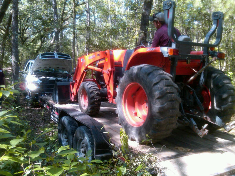

I don't see how checking fluids before a start can really help. Its a feel good thing for sure, especially if you are burning the oil. My JD doesn't leak anything until the plug drops out.
Lets hope it doesn't start leaking or burning on you - otherwise you'll never notice if you don't check the levels!!!
If it was tampered with, I'd look for problems on other machines, too.
Totally agree - Not sure where OP is, but if it is rural, I'd look for someone nearby who has an issue with you / your tractor!
THIS!!
For someone to "premeditate" this type of vandalism, they really have an issue with you. It isnt random. And its likely not kids. This is "personal". Same for the truck story earlier. Likely an ex-employee or somebody who had business dealings or a competitor.
Vandals usually want instant gratification. Draining oil to only see the vehicles fail later in the day when they aren't present doesn't happen much. Let alone having a wrench to loosen the plugs handy.
Somebody, either the previous owner or the dealership, loosely installing the drain plug during an oil change "to keep it clean" or "not to loose it" then forgetting to go back and tighten it is a much more logical explanation.

Hmm, wouldn't the drain plug look beat up after getting hit by the mower?
/ Can't Believe This Happened #77
yes/no. i can run of a gravel drive way and only get a handfull of rocks to fly. other times i could get tons of rocks to fly.

I got my tractor back today with a brand new engine. KTAC covered the engine replacement. It was a COMPLETE engine replacement - the new engine even came with a new radiator! I am extremely pleased with my Kubota dealer and KTAC!
I highly recommend that you consider the KTAC insurance. I know I'll always have it!
