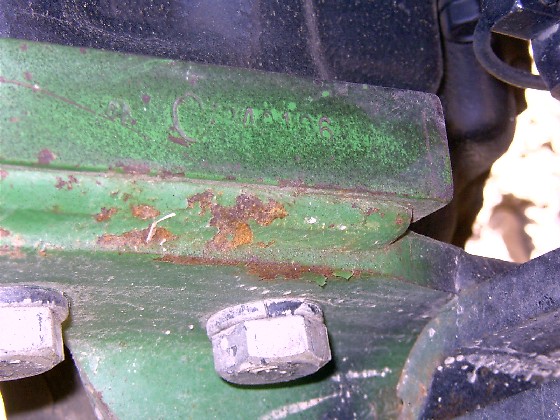

Thanks for the tips. I drove over there last night to check it out myself again, and all that's under the pto is two empty rivet holes.
I did find some numbers stamped into the frame on the rear, left of the PTO, 6 digits, starting with a 2, but hard to read. Also, the plate on the oil pump in the back has some overspray on it, as if the whole rear had been replaced, repainted, and perhaps the serial not transfered?
Other then that suspicious bit, everything looks great, and seems like a deal I don't want to pass up, but something about that tag seems fishy. The old man is a retired guy that has a bunch of heavy macinery and tractors on a farm lot. seems like a decent operation, but what do I know? He claims that the owner bought it and used it for a couple years , then died, and he's selling it for the wife.
Should I pass? or can this stuff happen? I want the tractor, but not if it's going to cause me problems with maintenance and possible resale.
/ Can you help me decript this serial number?
Here's a picture of that stamped number
/ Can you help me decript this serial number? #11
Shouldn't the engine have a serial number as well? I wonder if you can get that and a Deere dealer can cross-reference it back to the tractor?
#12
thanks, I do have a valid engine serial and model number, along with a serial number from the loader. I have someone at a JD dealership trying to help me out.
Just hoping to get the general feel from some people a bit more experienced then me.
BTW, the engine serial is CH3048D025074 and the loader SN is M0070AX140830, just in case there's anyone else looking that might be able to cross check the numbers.
