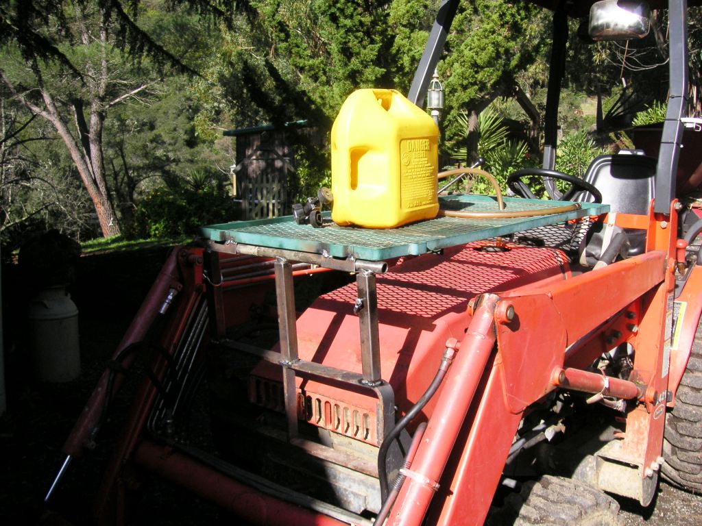

Lastly, if you regularly carry large items like chain saws, fuel cans, small generators, etc., you know there is no place to put them. Here is what I did with my previous tractor, a Kubota B21 TLB with a FOPS. I am adding a FOPS to my G3038H so I will again have two uprights forward of the dash so I may do this again. This tray was used VERY often at my ranch where I had a mile of mountain road to maintain and ditch well away from the barn. The hinge is simply round tube inside square tube - strong and simple.
