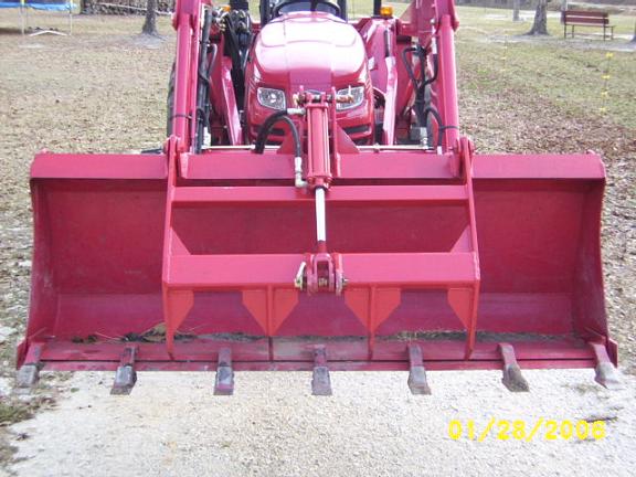

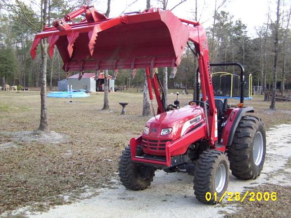

is that a manual grapple or hydraulic on your loader bucket? ecoscaper, it is a homemade hyd grapple added to my bucket and here is a couple more pics of it.
I need to ask you-don't your two ramps jiggle around while towing? nickel plate, my ramps are spring assist and the springs keep tension on the ramps, so no jingle. I will be welding some kind of metal stock to the beaver tail for better traction, probably re bar.

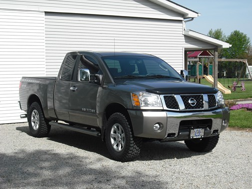

You will love the Armada. I have a Titan that I got into after a 2007 F-150 and this Titan will stomp all over the F-150. Mine had the 5.4L and 3.73 gears.
Here is a pic of the F-150 and the Titan that replaced it.
Chris
