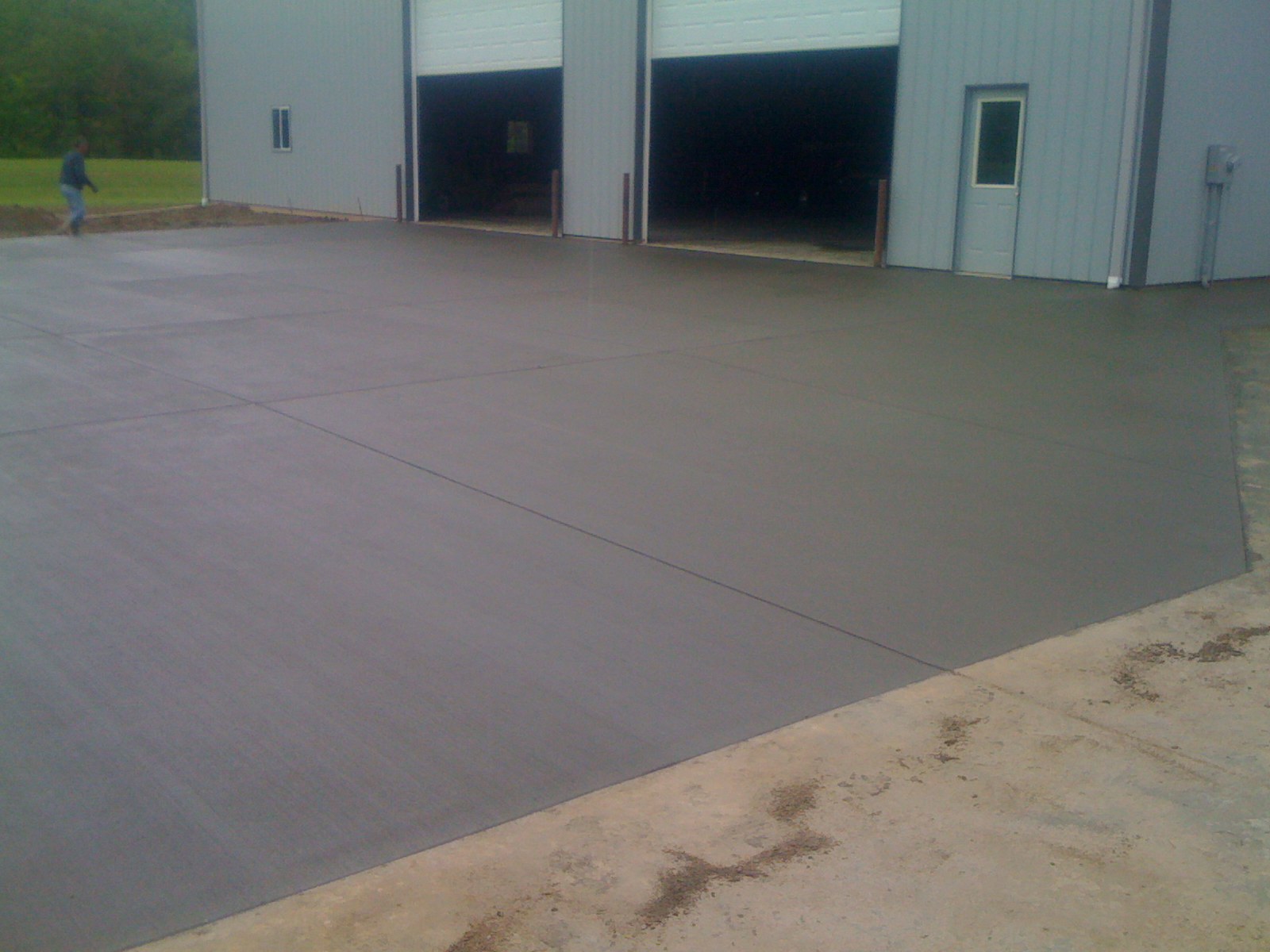

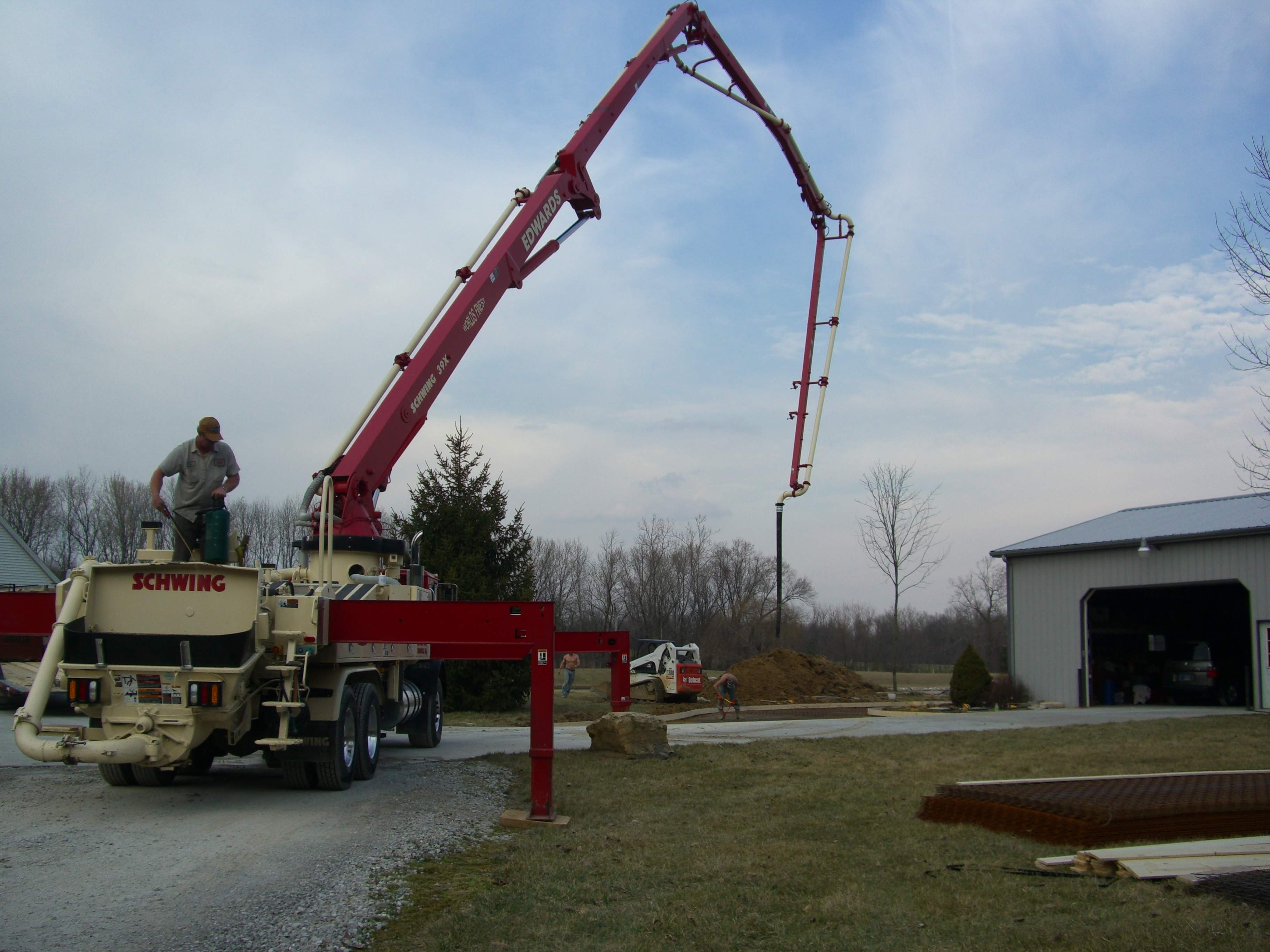

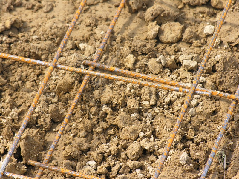

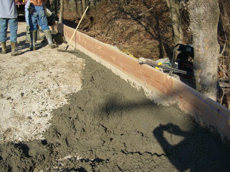

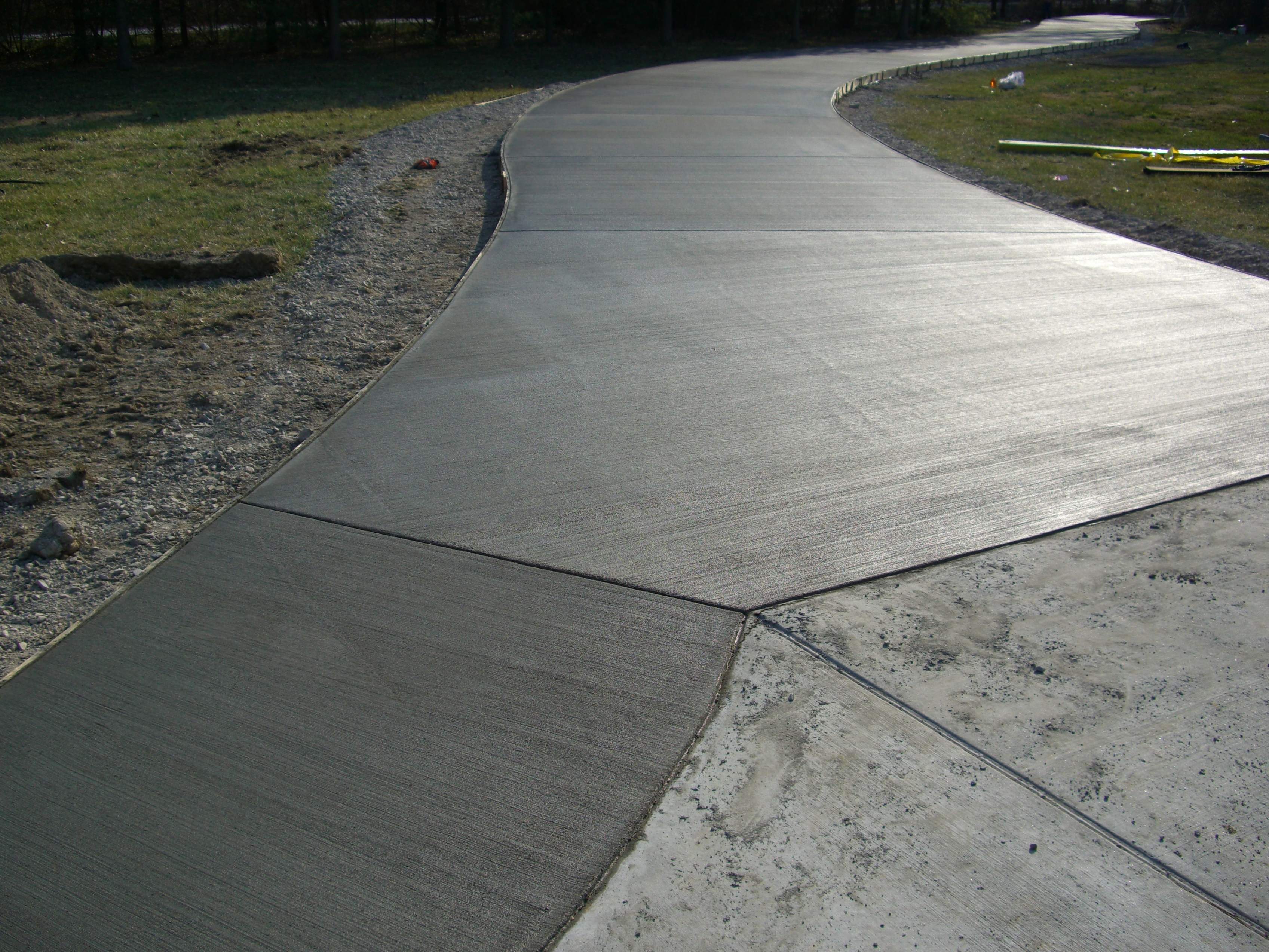

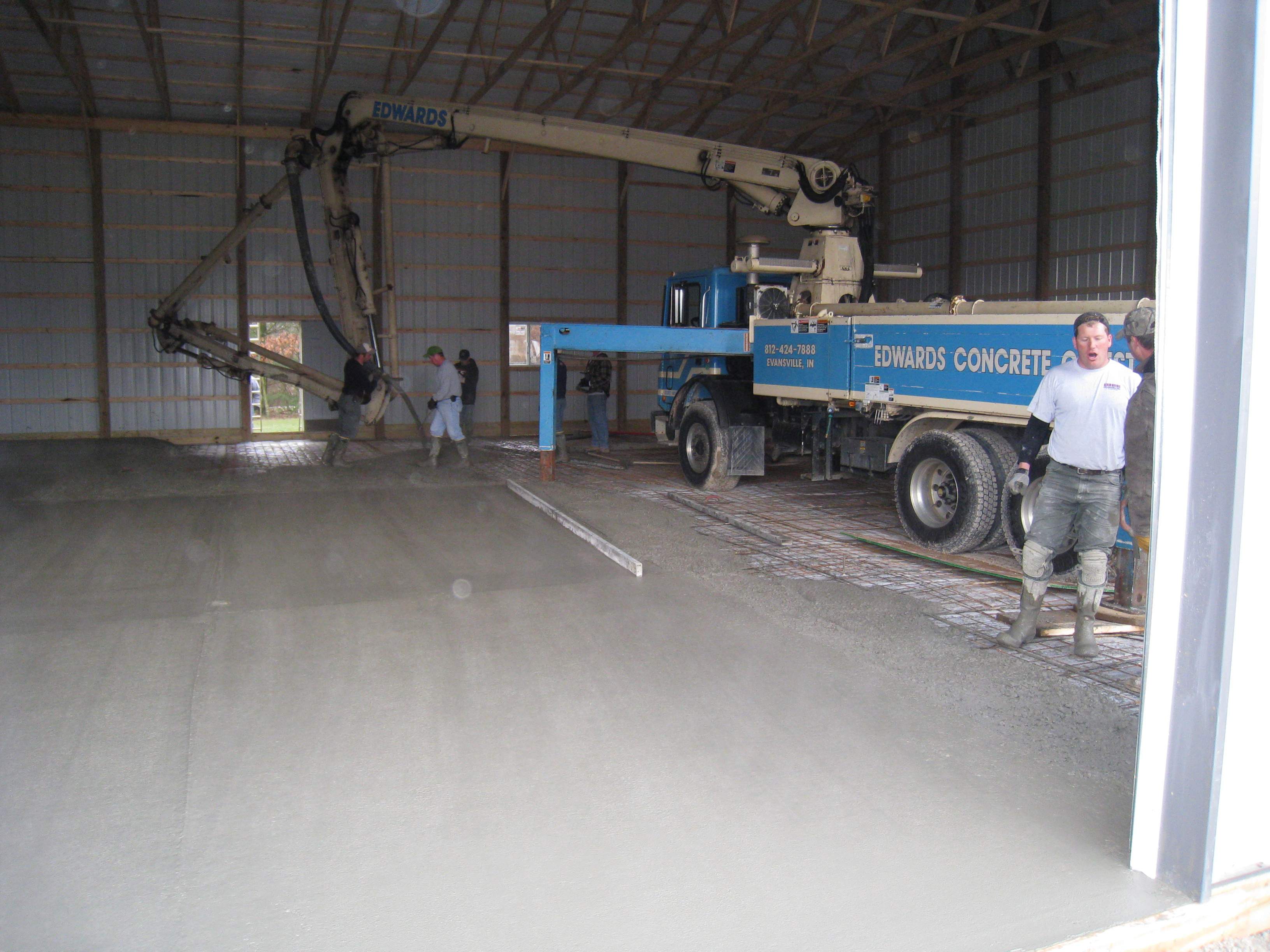

I'd have to say a lot depends on how young you are and/or how good your strength and aerobic conditioning is. I've done many smaller areas by hand, but most involved larger scale equipment. Last year I topped the 1000 yard mark at my place! For big commercial sites, that isn't all that much. For an individual homeowner, it's a bit much. For my larger jobs I've had huge pumper trucks (over 100' reach) here with a dozen or more full concrete trucks lined up down the street waiting their turn to empty their load into the pumper. The concrete truck drivers love that because they don't have to get a single chute off their truck and only get out of their truck to hose the one chute out.
About the only thing that I found that I'd do different than what has been explained already is use sheets of wire mesh in the smaller jobs and not rebar. The wire mesh I use comes in large sheets and cannot be rolled due to the thickness of the wire. Basically what it is amounts to 1/4" rebar made into 8'X16' sheets. None of my concrete is less than 6" thick, so all this wire mesh is held up off the bottom by old bricks laid down before the wire is put down. Using the wire that comes in a roll seems to be a complete waste to me. I've removed some slabs that were only about 20 years old and the wire was pretty well gone. It had completely rusted apart inside the concrete and was offering no support at all. I have used 'footers' on all edges along with #5 rebar. Even in my barn where I store heavy equipment and run fork trucks (10" 5000psi concrete) pretty well all of my concrete has developed some cracks. To me the big issue is to make sure that the concrete doesn't move where it cracks. In other words, I don't want any part of the slab being pushed up vertically than other concrete. All the rebar and wire should prevent that.
I included some pictures of a couple of the larger pours. One shows the "rebar matting" I talked about. In another you can see the forms for the concrete over my bridge consisted of a 2X12 on top of a 2X6. I didn't get any pictures of the 2000 pounds of #6 rebar I welded up and put into that portion because I was just too tired to move.

I also second the use of rebar as rolled up mesh is going to be a PITA to get to lay right before the pour, and it will end up on the bottom of the slab where it does no good from the concrete guys walking on it.

For larger slabs nothing beats rebar held up by rocks or bricks. But for small slabs I've used chicken wire to help hold it all together. The premade sheets of wire mesh tend to be also pre-rusted and I've found them to rust out and stop providing the reenforcing they are in there for. Chicken wire is galvenized and just doesn't rust.
