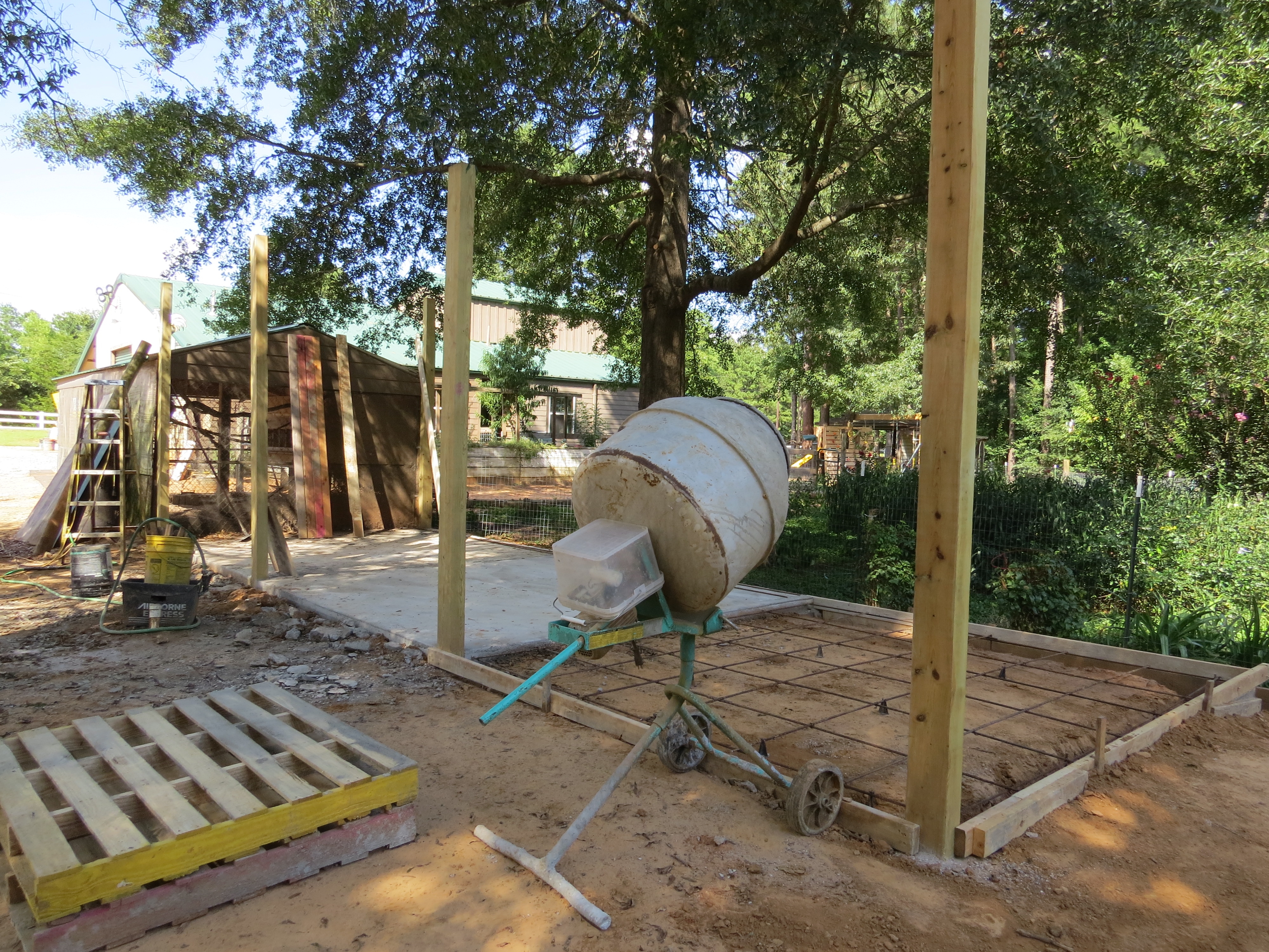

For my place, I mix and pour pads up to 12x12 without too much issue. I start early in the morning, and I'm usually done by noon. It usually takes a pallet and a half for most pours like that. My shed is 10x30, so I did it in three pours. I put the mixer next to where the pad is, and the pallets are right next to the mixer. In my opinion, the hardest part is getting the sacks of concrete into the mixer. The closer it is, the easier it goes.

For big projects, like my 30x52 garage addition, I hire the pros. Concrete trucks have a 3 yard minimum, and they rarely show up first thing in the morning. They do the big jobs in the morning, and then they show up when everything else is done. I hate pouring in the afternoon, especially when you have no idea when the truck will show up.
Another reason for doing it yourself is the location. My septic tank is just to the left of this picture, and there is a big oak tree that would make it hard to get a cement truck to the pad. For me, it's just easier to get it done myself, then deal with others and a massive cement truck.
