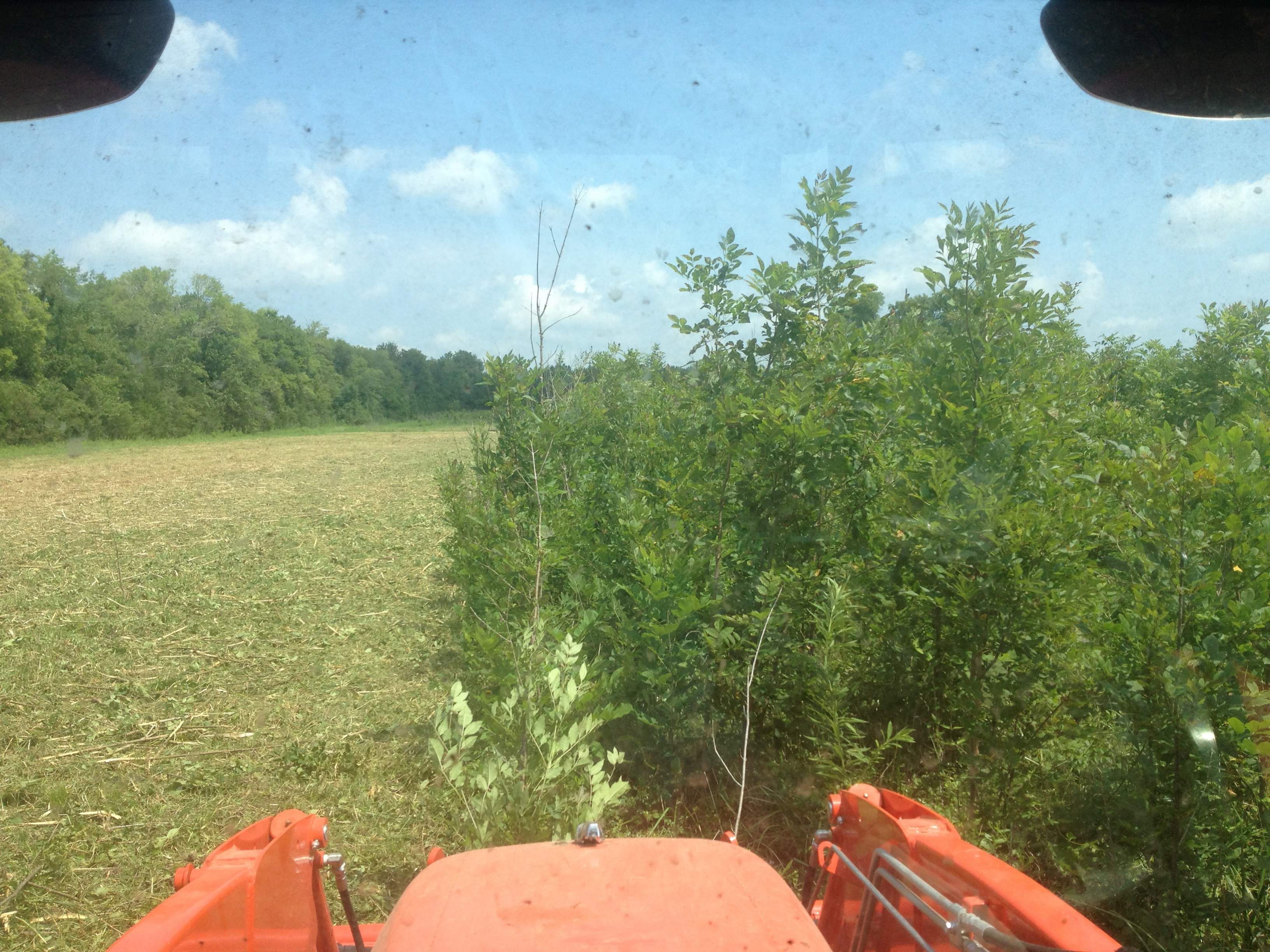

This is some heavy brush I cut with a Landpride RCR2672, as you can see I had stopped to clean out screen.It was a 10 acre property, I give that cutter a hard time and it has done very well.

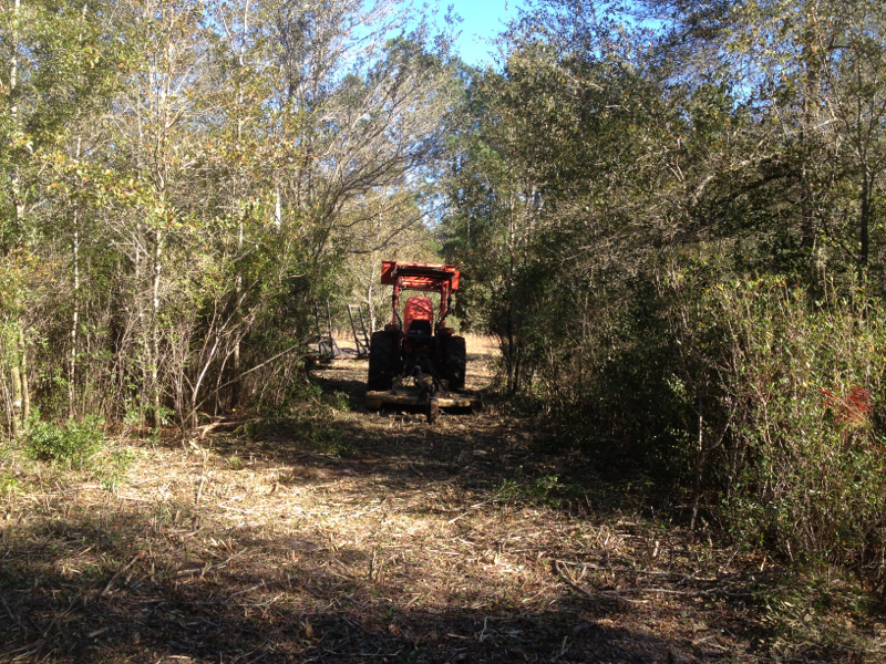

No problem cutting this mess down. I used my 1710 with a 5' bush hog and just took it slow. Ran the loader low - 10-12" to push over the trees and protect the tractor. Between the scoop, the arms and the crossmember the tractor is pretty well protected. I cut everything bigger over 3" diameter with a chain saw first and then just ran over them with the mower. After the mower I picked up the big pieces. (These were all hardwoods.) I had to put in in 4WD to get a lot of the trees pushed over and took it slow as I do not have a live PTO. If I can do this with my outfit yours will be no issue. Some of my trees were over 15' tall.
