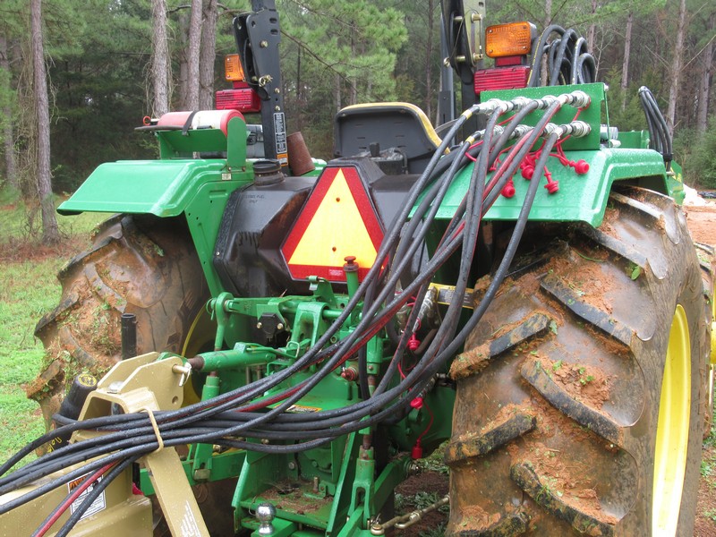

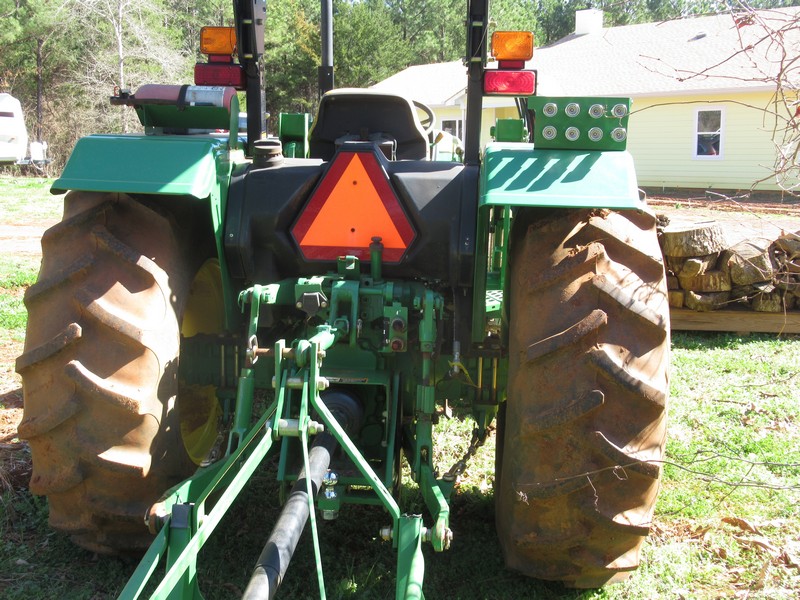

I was concerned about tapping into my hydraulics, and I needed a backhoe so I talked to my dealer and let him install the backhoe. I did not mention future plans since I didn't have any at that time. There are 3 hoses now to the back of my tractor with QD fittings.
All i needed to do was to identify which was the pressure line, power beyond, and tank. Then I mounted a valve bank (with power beyond) on the fender and put on QDs on the hoses to match the backhoe QDs. I did run a tank line since the valve bank also had that.
This is the Backhoe setup, there are 3 hoses in this picture, but - - the tank line is the one that is not connected and has a yellow tag on it. The other two are connected together and are just to the left of that line. The hose is blocking the view of the connector but you can see parts of the connector on either side.
In the last picture you can see the silver connectors that hook into the Backhoe QDs.
