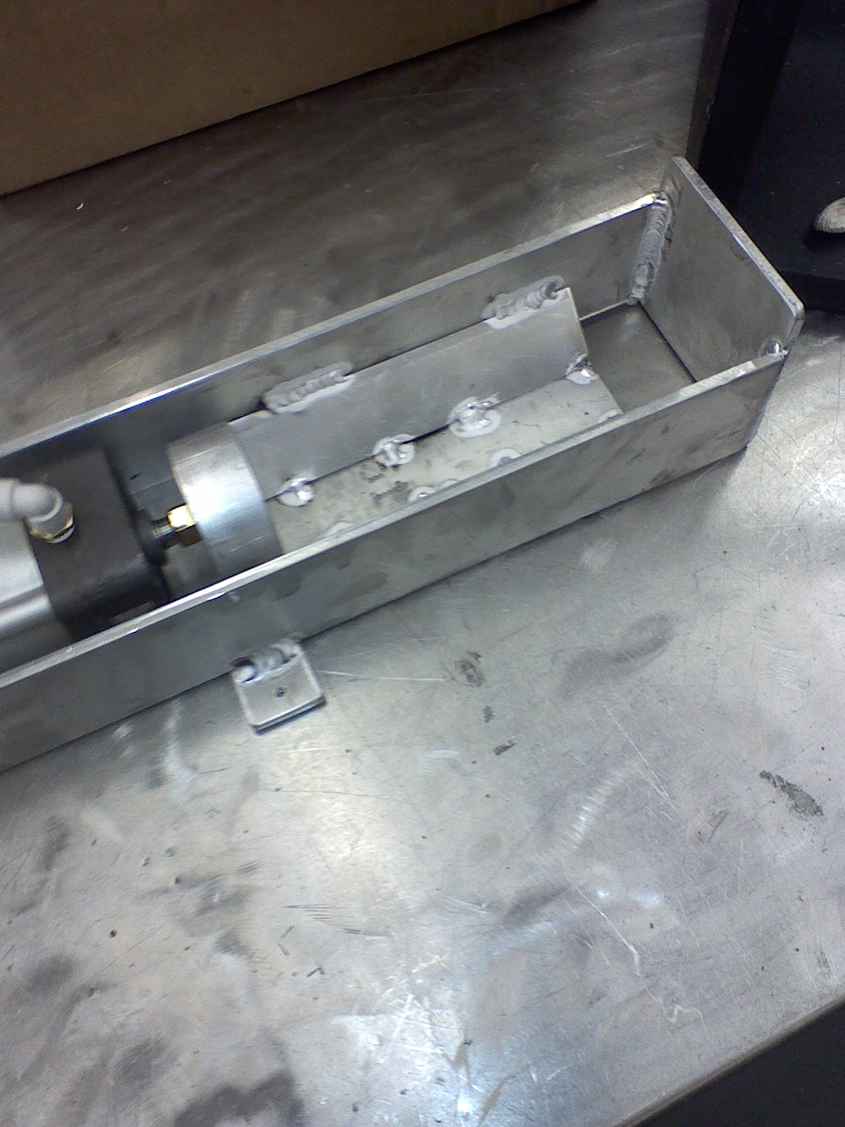

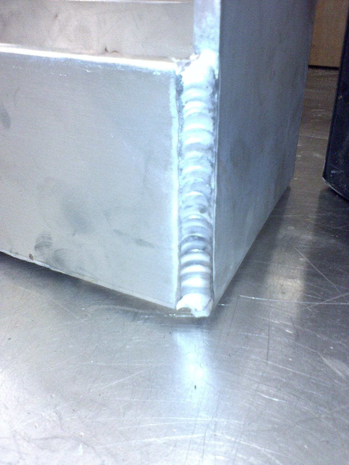

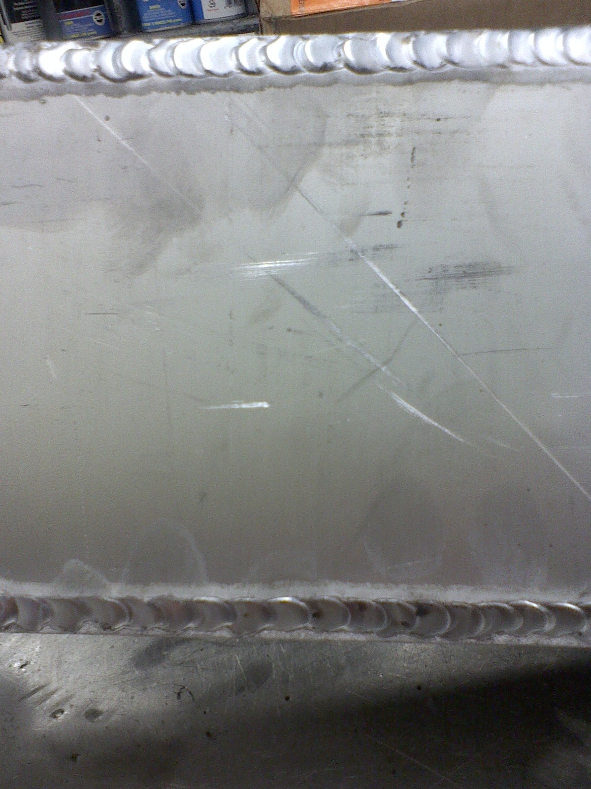

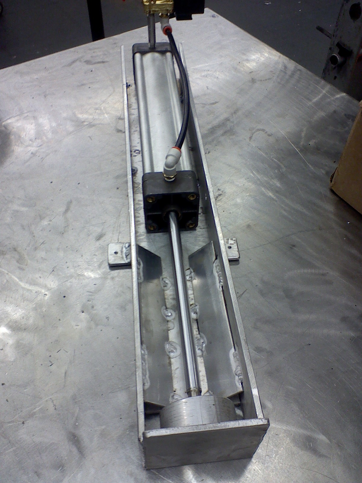

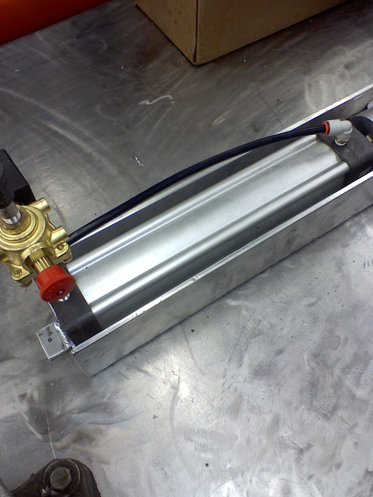

Yea, this is the kind of stuff I like doing:laughing: Just getting an Idea in your head and going to town :D So far, this is the 5th one I built.
The first two were a 2" cylinder with only enough stroke to crush a 12oz can. They were VERY fast. At my 130PSI they generate ~400lb force. And crush the can down to about 3/4"-1". (about what you get by stomping on them.
I made one for dad out of a 3" cylinder. It will do 24oz cans also. Used a solenoid DCV so it is just a little momentary contact push button to operate. Thats about 900lbs of force and crushes them to little under 1/2"
I also had a 4" cylinder one but gave that to a buddy. Too much air for my little compressor to keep up. And it was slower. He has a 175PSI 120gallon 2-stage. That makes that one about 2200lbs of force. 1/4" thick is what it would do.
This one I just made is a 2.5" cylinder. Crushes to maybe a little more than 1/2". about 640lb of force. But I really wanted one to do 24oz-ers and wanted a "purdy" all aluminum one:D
