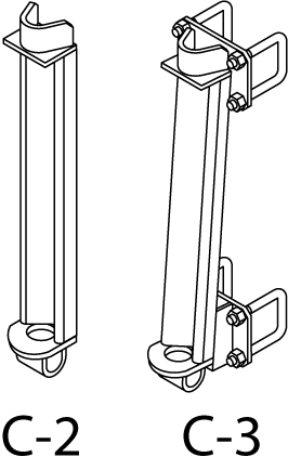

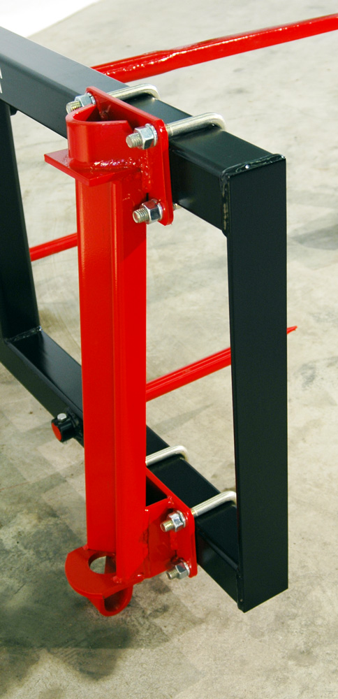

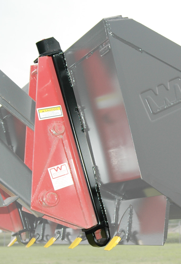

The photo inserted above is available from Westendorf (taken from our web site www.loaders.com). To answer some of the questions - Is one better than the other? Here are a few things to consider...
1) Number of trips off the tractor (automatic lock on or off)
2) Ease of alignment
3) Long term wear (flat face vs. V-shaped)
4) Cost of adapter sets to convert bucket/attachments
5) Is it a new design that may be obsolete in a year or two or has it been used for several years with reliable supply of parts for future attachments.
The Snap-Attach system shown in the in the above thread is universal to most loader brands, cylinders need to be on the top of the loader arm and arm ends need to be 4" wide or smaller. Set of loader couplers run approximately $650 (set of two) and the adapters for attachments and the bucket are roughly $150 (set of 2). Available in weld-on or bolt-on configurations. Most local Westendorf dealers will have these parts in stock.
Front-End Loaders by Westendorf: loader for tractor, shade canopy, wagons, manure & landscaping equipment.
