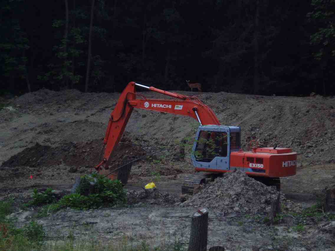

You have no idea what you are getting into thinking you can dig in grey clay with a compact utility tractor. You will tear the loader into junk and dig nothing. Digging in grey clay with a machine under 10,000 lbs is a waiste of time.
Rent an excavator for a week for about 1400 or a month for 3400 threw someone like United Rentals. Buying an excavator for under 10,000 will get you a piece of worn out equipement that you will have to sink alot of money into that you will never get back.

In order to have fish in a pond around me in Indiana 50 percent must be 10 feet deep. In this picture I am down to about 16 below my max waterline. You can see the grey clay. A CAT 262 skidsteer with steel tracks that weighs about 9000 lbs couldn't do a thing in it. A hitachi EX150 excavator that weighs about 30,000 lbs is what I used to dig with.

It sounds like a fair price. I have used well over 1000 in fuel alone, 3 cases of greese, 450 in gas water pump, and alot of time. Not to mention my wife riding me for spending all free time trying to beat the weather.
They will come in and get the job done quickly. It is amazing what a good oporator can do with an excavator and how little time it takes him to do it. I have become alot better with the excavator, but my first day of digging I could have moved more dirt with a shovel. Good luck.
