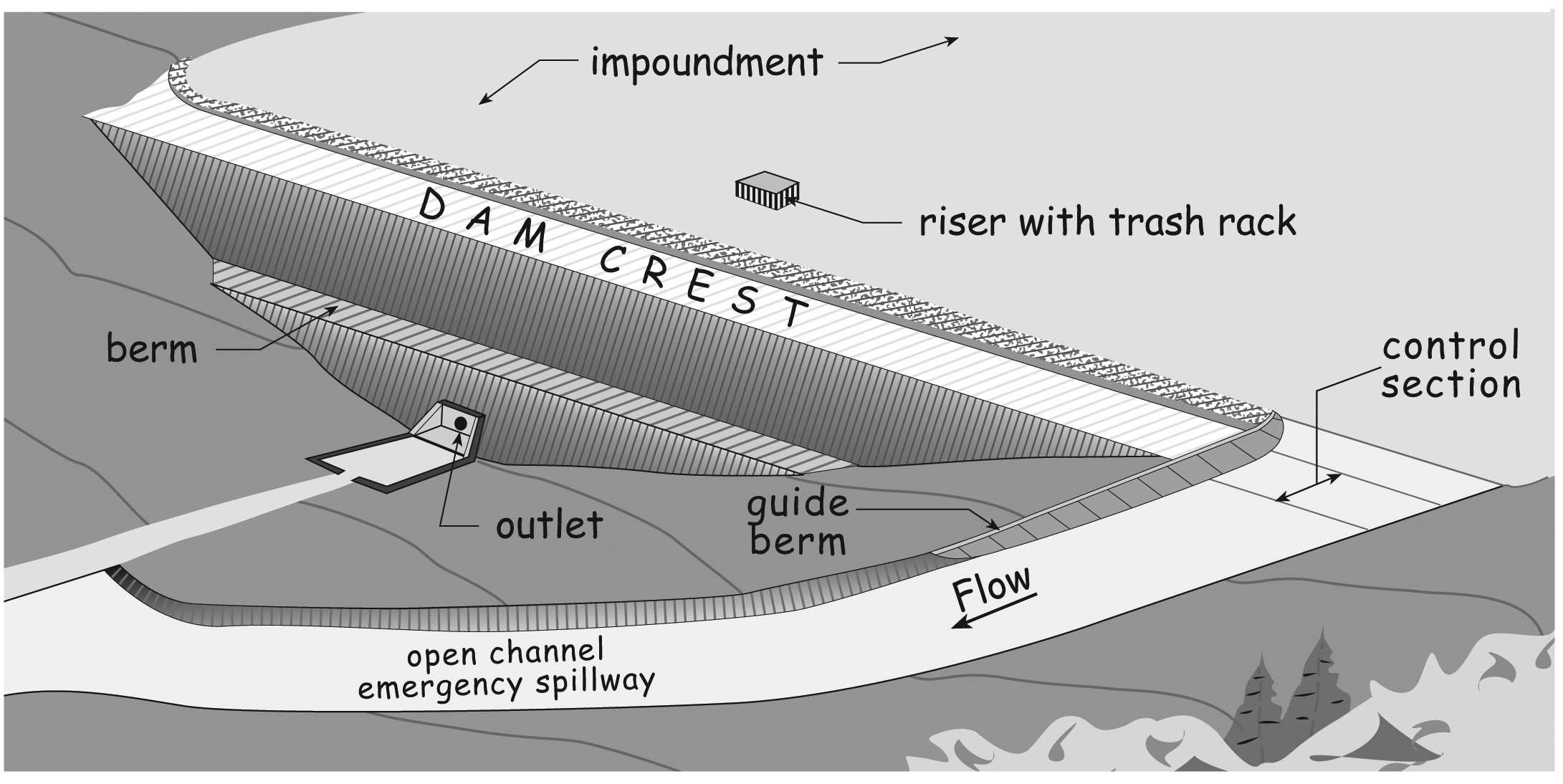

Maybe it’s just me thinking out loud but the beavers have created a somewhat natural spillway. I think I’d just leave it as is unless you want to give that Kubota a workout when you buy it.

The water is passing through it. If you don't give high water a durable way to pass through it at high water, you'll have a complete washout. Similar to this photo but using a culvert for your overflow. Its a emergency spillway in the drawing.
   / Camp property search #446
The water is passing through it. If you don't give high water a durable way to pass through it at high water, you'll have a complete washout. Similar to this photo but using a culvert for your overflow. It’s an emergency spillway in the drawing.View attachment 3528832
60 years ago, my dad built two ponds like that. It is a good design

I actually worked on a couple of projects where we improved emergency spillways with reventmat mat. These were for pretty good sized lakes. Does this pond even have any kind of constructed spillway at all.
#448
No, today it just goes over the top or through the Beaver improvements.

I had to Google reventmat. We have used "fabriform" in the past on slopes and ditch paving. Seems the move over last few years has been away from it, for some reason. It's a good product. but very pricy.
   / Camp property search #450
Yes Fabriform looks to be a similar product.
Arly you could just put a culvert to act as an overflow. The only reason I say leave it as is because it seems to be working but I suppose it could wash out also.
