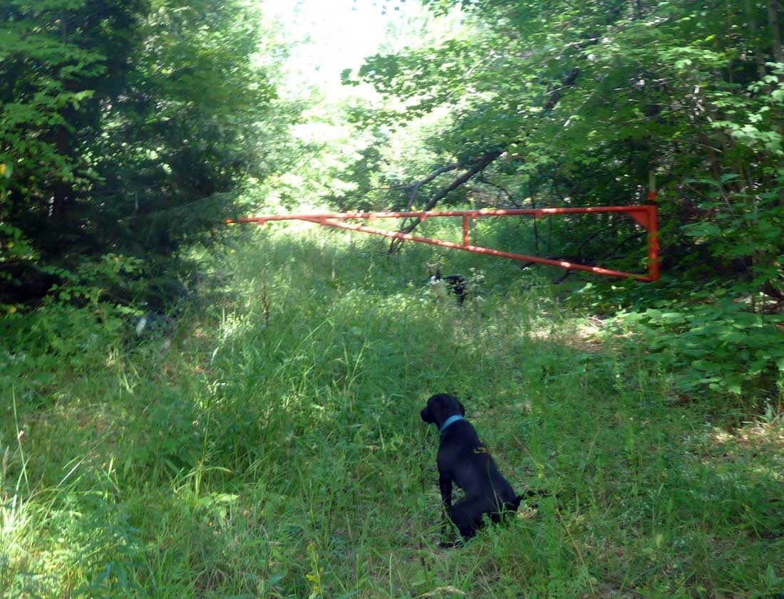

We are planned a modest weekend out there eating well, clearing brush at the parking lot and on the one mile in that has several dead-falls across it. Dang if I can find the gate photos now. Found!

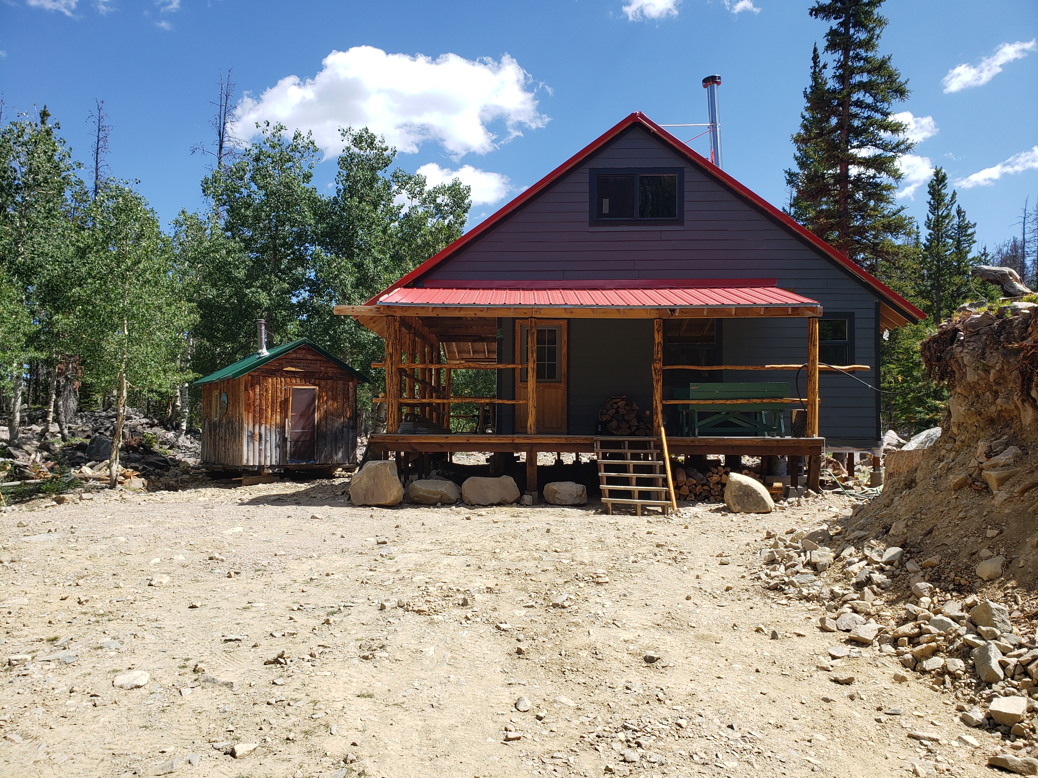

A current picture with the little shed i built. I hate shed roofs so I built a gable roof end and will sheet it like the small cabin. Need covered storage.

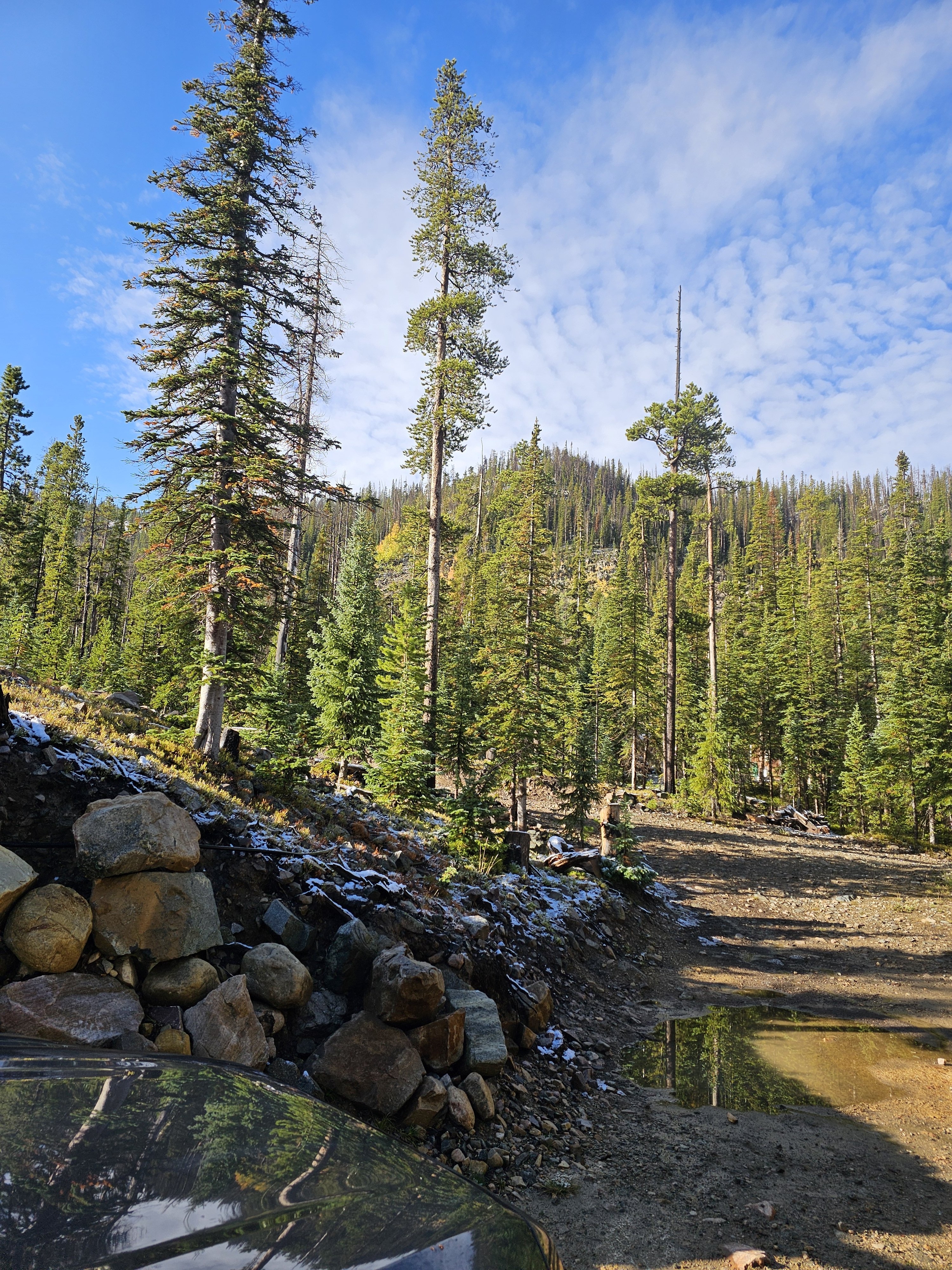

Where I get my water and what prevents me from having good solar, my mountain.
Yep, we had snow already a couple of weeks ago.
