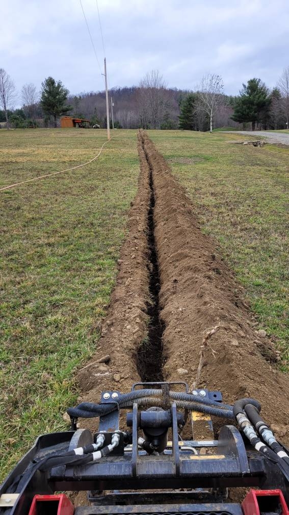

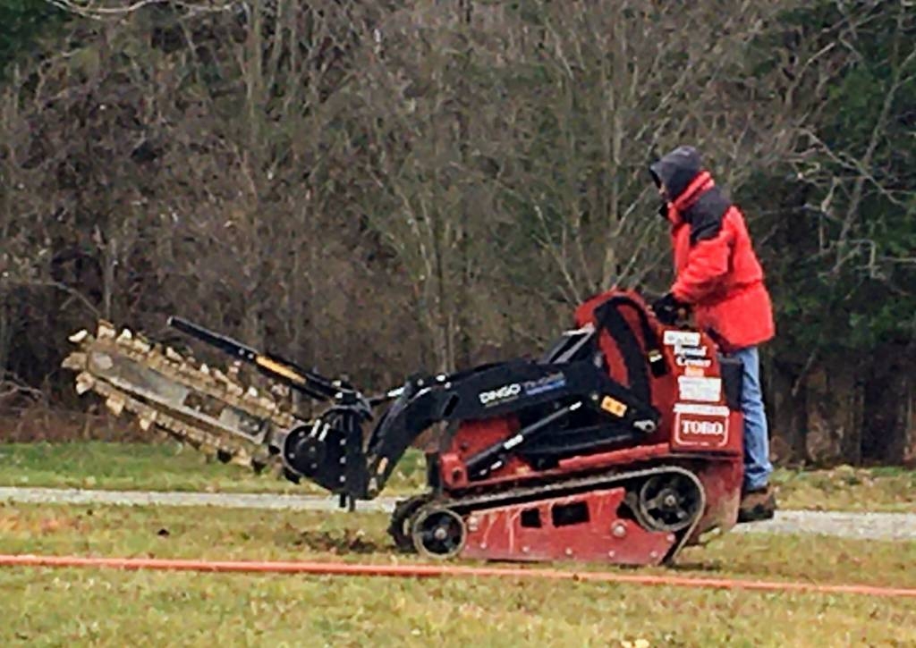

I called 811. Guy shows up and flags all the utilities including a major gas pipeline crossing my property. He said I'm not supposed to tell you this, but that's a 12 inch main line, installed in 1978 (so over 45 years old) that is down about 6 feet "according to my meter". Rules were I could not dig within 25' either side of the pipeline without a representative from the gas company present.
Followed up with the gas company and they agreed to be there Tuesday by 12p to watch. So I rented a very capable Dingo to trench in the 1000' conduit run for the cable service. I had already trenched the 950' balance before he got there, so was familiar and very comfortable with the whole trenching operation at that point.
Amazing how much higher the pucker factor was trenching the last 50' running over the pipeline...though only digging down 2 feet, and in spite of it being brrr suit weather, I was sweating bullet sized drops the whole time while digging over that pipeline!
