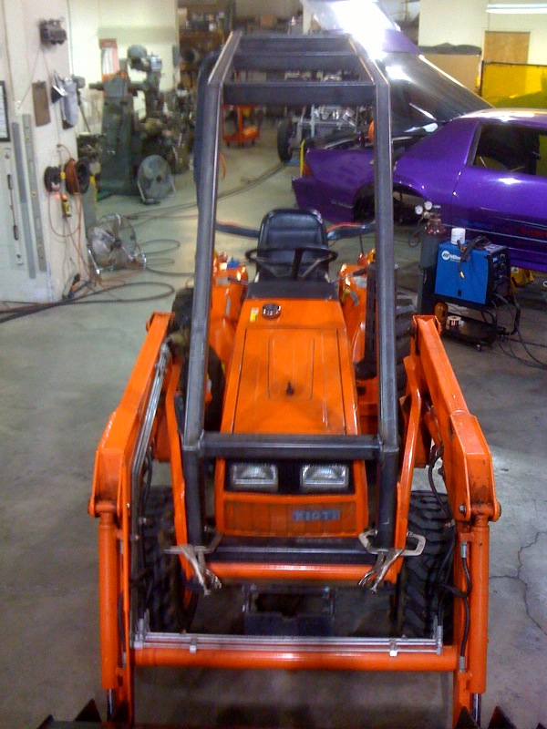

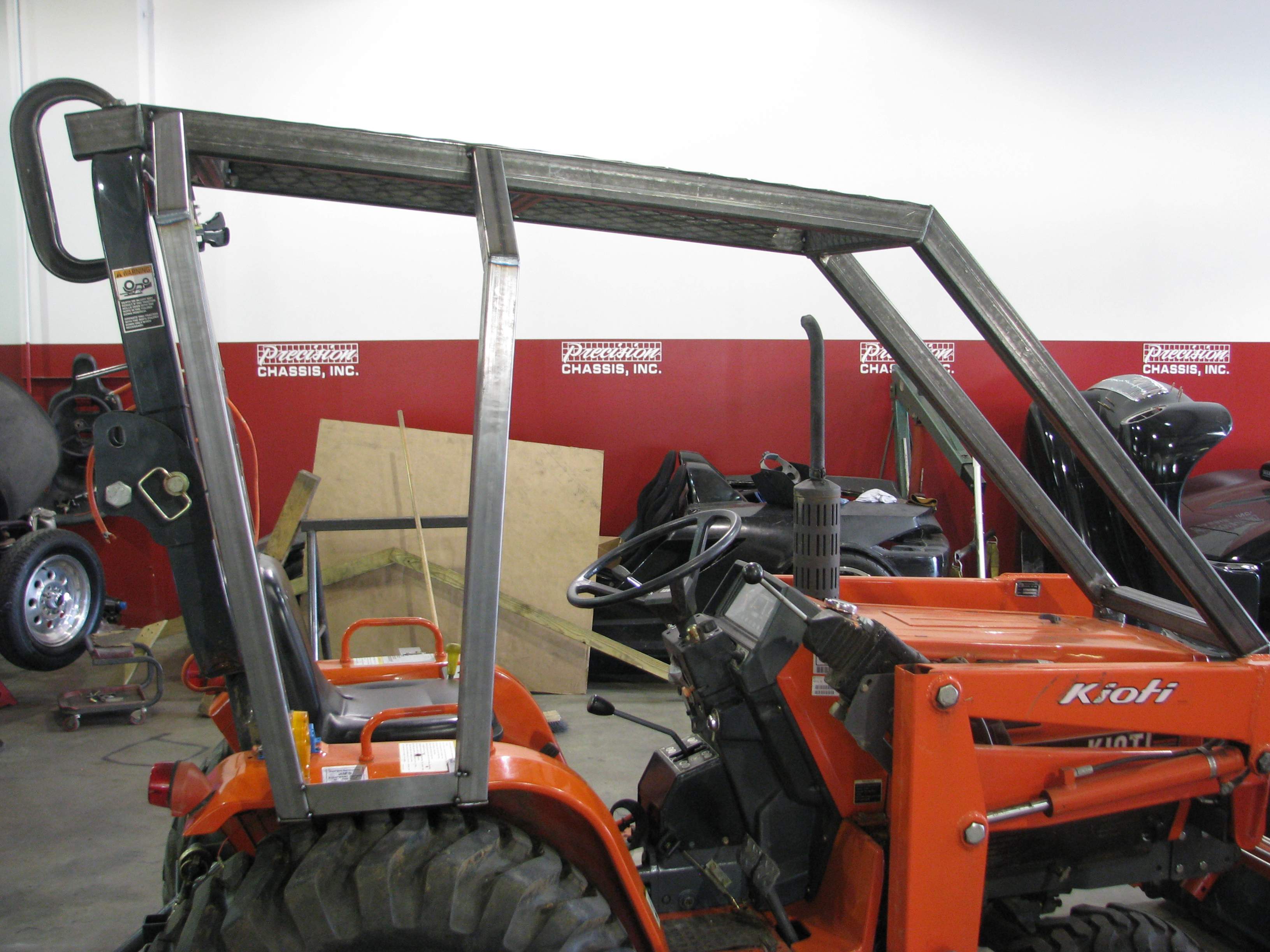

Got some pictures from the shop this morning! side sheilds, rear shield and expanded metal still to come.

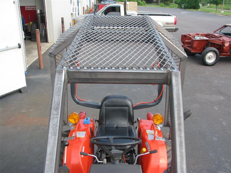

A little more progress and some more pictures!

That's a stout cage. A couple of gussets where the 'A' pillar meets the roof would go a long way towards taking the place of the posts I suggested in an earlier post.
I like the Willy's coupe on the lift in one of the shop photos you posted.
/ Cage for Kioti LB1914
#15
Are you talking about gussets to keep it from racking sideways or gussets to keep it from crushing downward?

Looking good. Just remember when we add heavy steel up high, we have now changed the COG. My cage is around 200 lbs, so I will be very carefull when working on a grade & I always wear my seatbelt unless I am on flat ground.
RD
#17

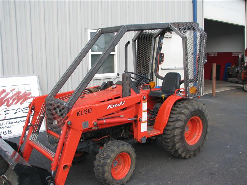

Thanks for the reminder RD. This cage should be around 300 pounds and I had the same thought. So I'm getting a 7/8" x 44" long rolled steel bar for the lower link arms. I used to be a weight lifter and have about 1000 pounds of excercise plates rusting in my basement. I figure I can get 600-700 pounds on the bar. Since excercise plates are round like wheels and the link arms float there are no worries about running it too close to the ground so I'll have this weight down low and it should more than counter the weight up high. The cage itself will add to initial stability but will detract from secondary stability. Stability is part of the reason I made the cage narrow. You can lean a bit before the heavy part of the cage is outside the wheels.
I wanted to do the side supports to the loader arms that were mentioned before but when I got an estimate for them it exceeded my budget. So I'm taking the cage as is and may add to it myself in the future since my cousin just aquired a new welder and a whole bunch of other metal working tools.
I'll post pictures of the final (well, final for now) cage once I have them. I've been told it's done but haven't seen it yet.

Here are the final pictures (for now). I do want to add side supports from the loader uprights and rear mesh but that is for another time.
