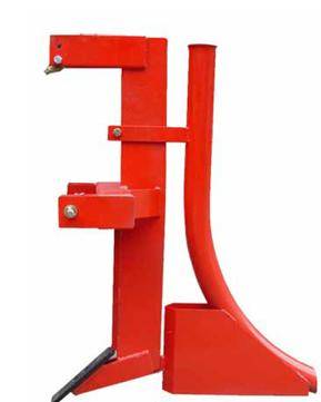

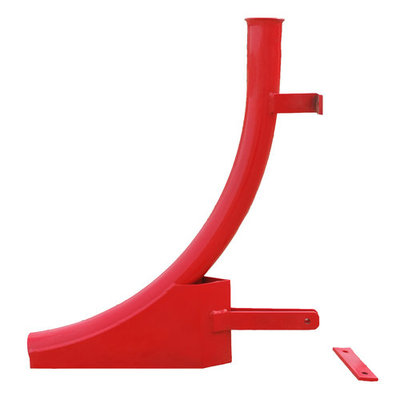

A little help please......I need to lay about 1650 feet of TV/Internet cable and was looking for an attachment that would do the job. I couldn't find a ripper/layer combo like the one pictured below on the right but found the pipe/cable layer by itself. (first photo) It looked a lot like some of the homemade jobs I had seen and the description said that it attaches behind any ripper or sodbuster and lays water lines cable etc. Looked like exactly what I was searching for, so I ordered it up. It was $168 delivered. It didn't have any dimensions listed just "fits most rippers and sodbusters".
Yesterday I see the UPS guy struggling with a huge box and was wondering what the heck he had. After he unceremoniously dropped it on the front porch muttering under his breath about oversize items I opened it up. BABY JESUS! It was the pipe/cable layer and is about twice as large as I thought. It's a little over 36" high and 30" long and that's a 3 1/2" tube with a 4" flared opening at the top so it looks like I could bury about 25 cables at the same time.
The $100 Tractor Supply ripper I have that I was going to attach it to is too small so if I'm going to use this thing a new ripper is in order. Any suggestions as to an appropriate ripper to match? Or maybe I just try and locate a smaller layer/ripper combo and hang this one up for laughs. Thanks in advance.

google "cable trencher". Those rippers will cause you all kinds of extra work.
/ Cable laying conundrum....
I already looked at all kinds of trenchers and I was trying to stay away from filling in a 1650' trench. The ripper doesn't disturb the earth as much and running over the raised ground to seal it back up is 100 times faster digging a trench, laying the line and filling it in. I just thought someone on here who has actually used this type of unit would respond. Thanks anyways and disregard the question I found what I needed.

Hi: I used to lay underground telephone cable for Henkels and McCoy in the late 60s. We had a "similar plow shoe" but it took a D6 caterpillar or more to lay the cable in clay ground without rocks. I would think it would be a tough pull with a small tractor but we were going about 30 inches deep when possible. Our equipment was set up to do that type work and involved a multi size crew.
I will be interested in following your progress. Hope it proceeds well.

Cat5 is speced at 328 feet. It will work out to 1000 with slow speeds. A camera will work OK. Coax all depends on the size of the coax. For 1600 feet I would reccomend one inch hard line.
With the chute you bought try and rip it a few times before you put the cable in. It will take some power to pull that chute. Find a friend wiht a tractor and make a plow train.

Before you plough your cable in its best to prerip the line. To do this is to do a pass or two without the cable shute to insure you get a good cover the cable and also find any unripable objects(rocks,tree roots etc).Also bear in mind that you cannot back your tractor once you start plowing the cable in the ground. Used this method to lay 1000's of k's of optic
Everything Attachments sells the Fred Cain subsoiler it's pretty manly.
BTW where did you get the pipe/cable layer you bought?
/ Cable laying conundrum.... #17
I'd be real interesting in where you got the part you did get?????? I'd kinda like something like that.
