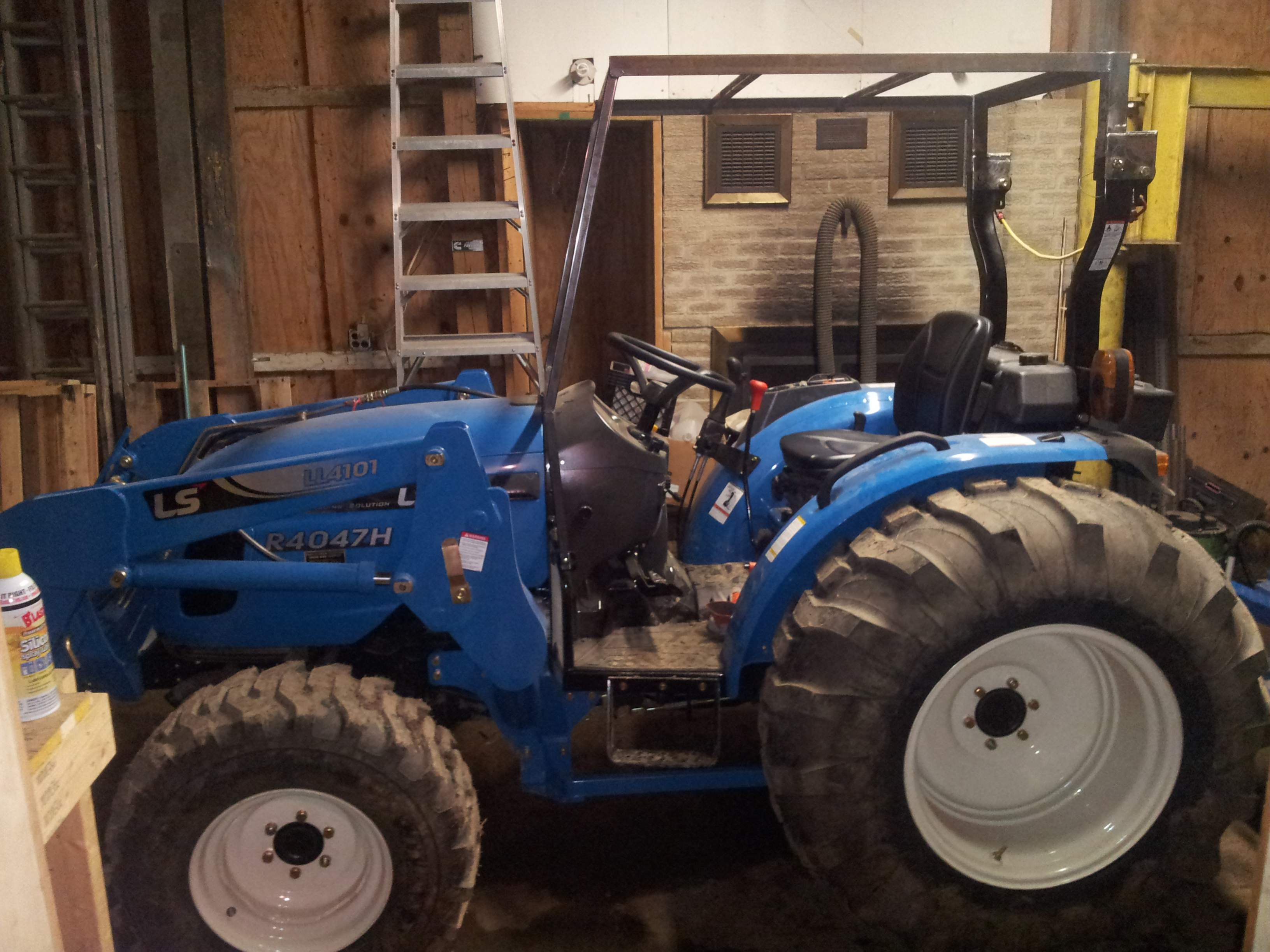

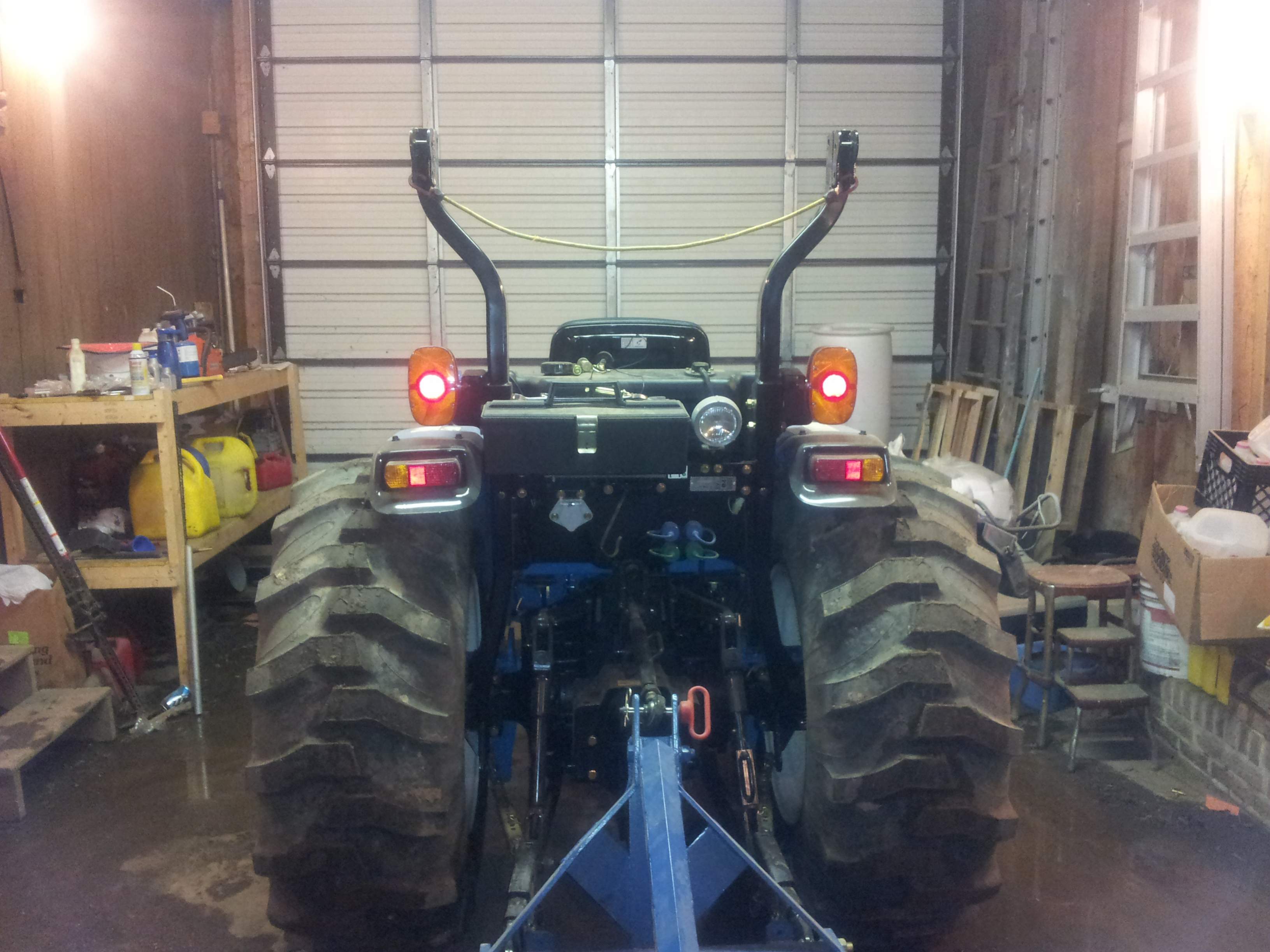

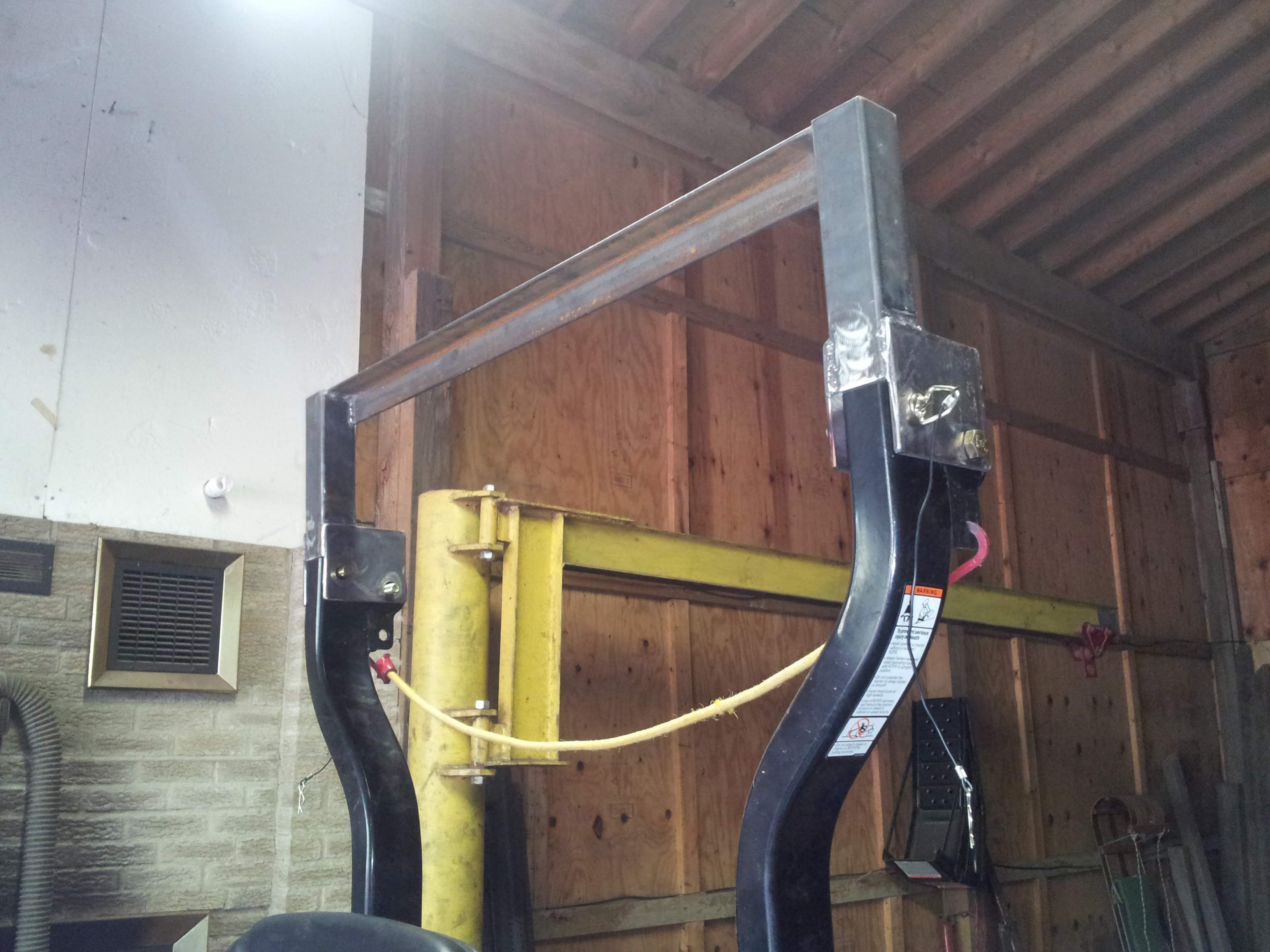

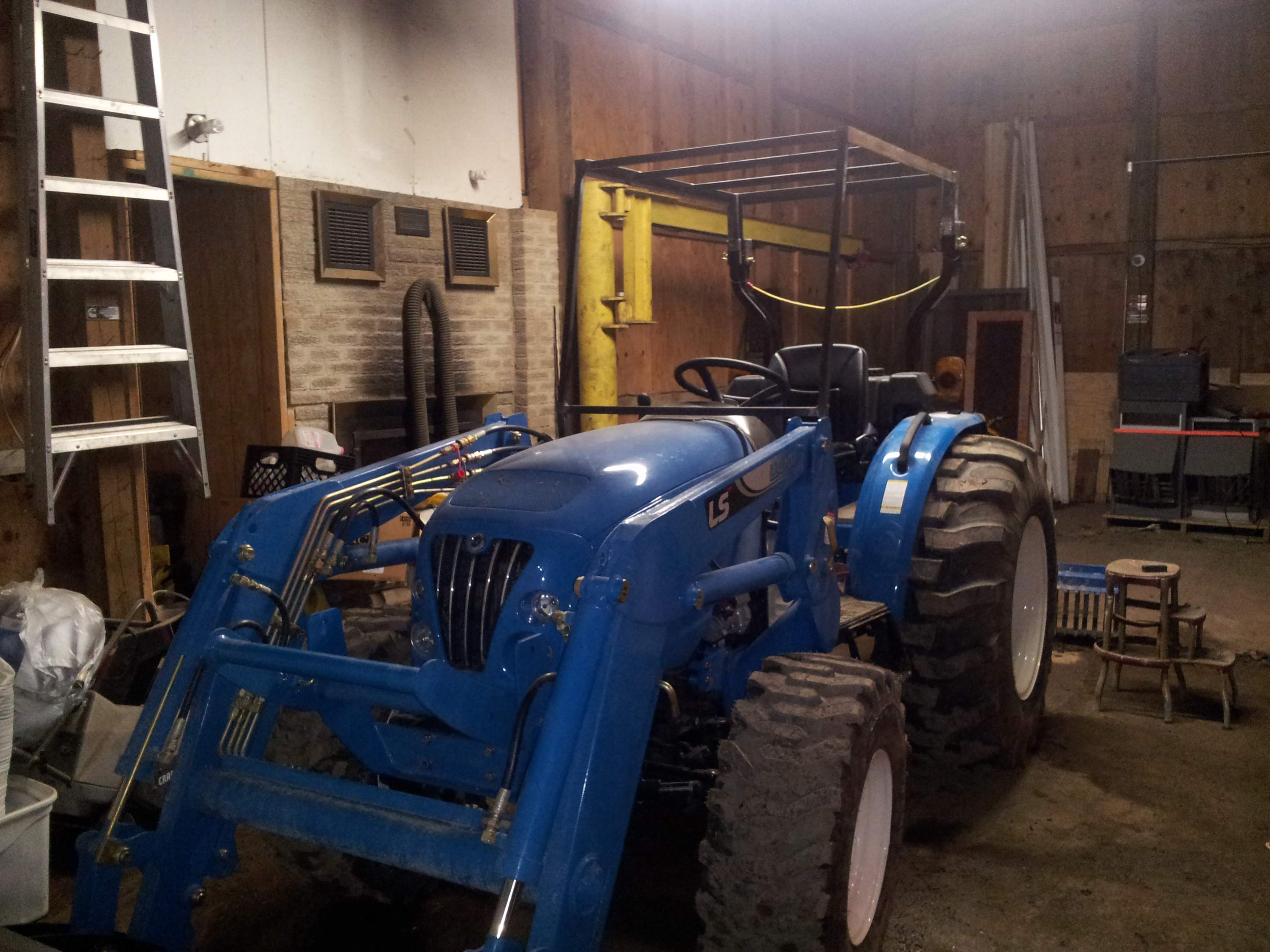

First off, I needed a new "upper ROPS" for the back that I could attach the frame work to. I decided to shorten it a bit so that it could fit under my short barn garage door, and my actual garage doors... if needed. So, here you can see that I removed the upper ROPS portion.

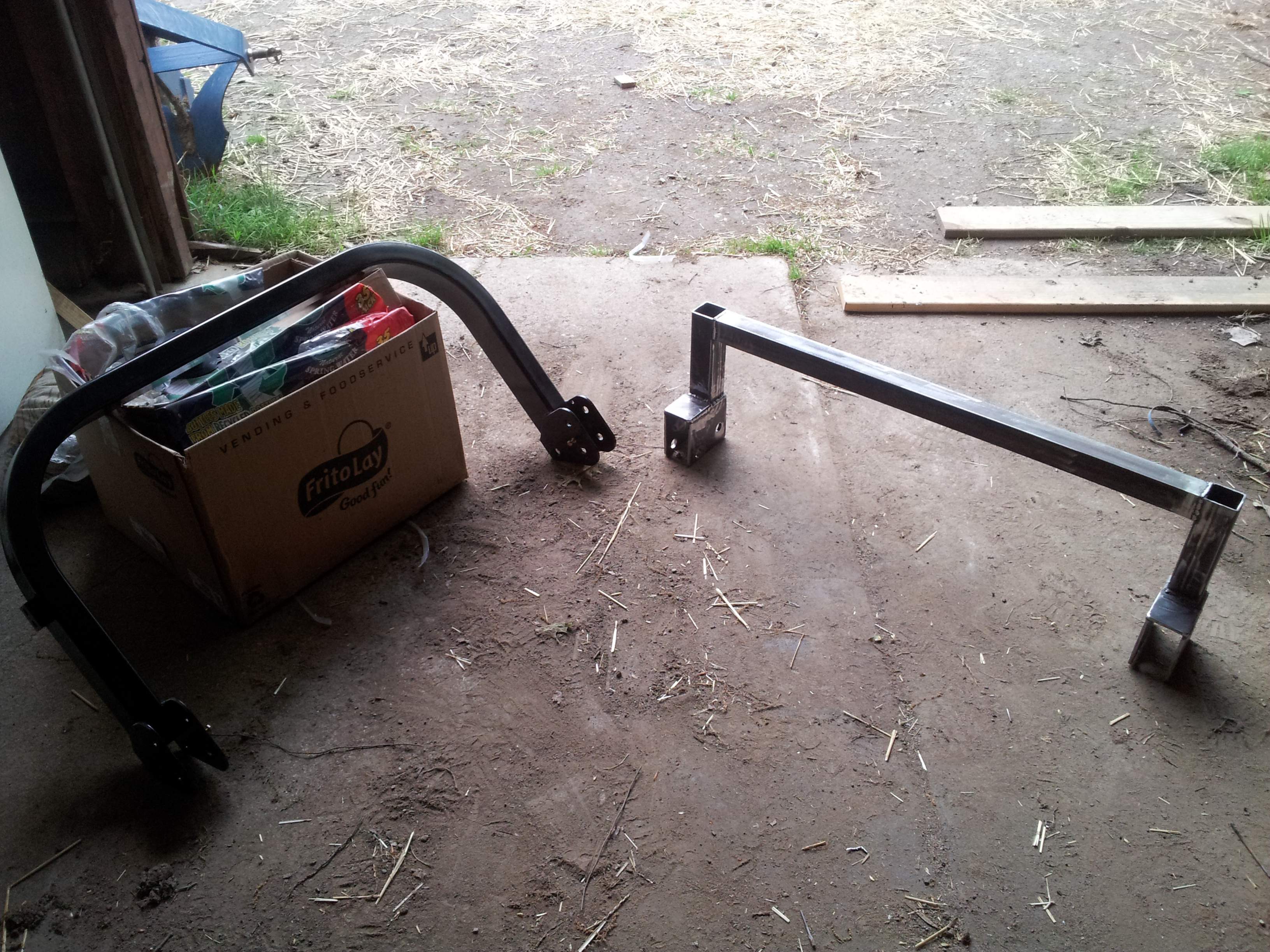

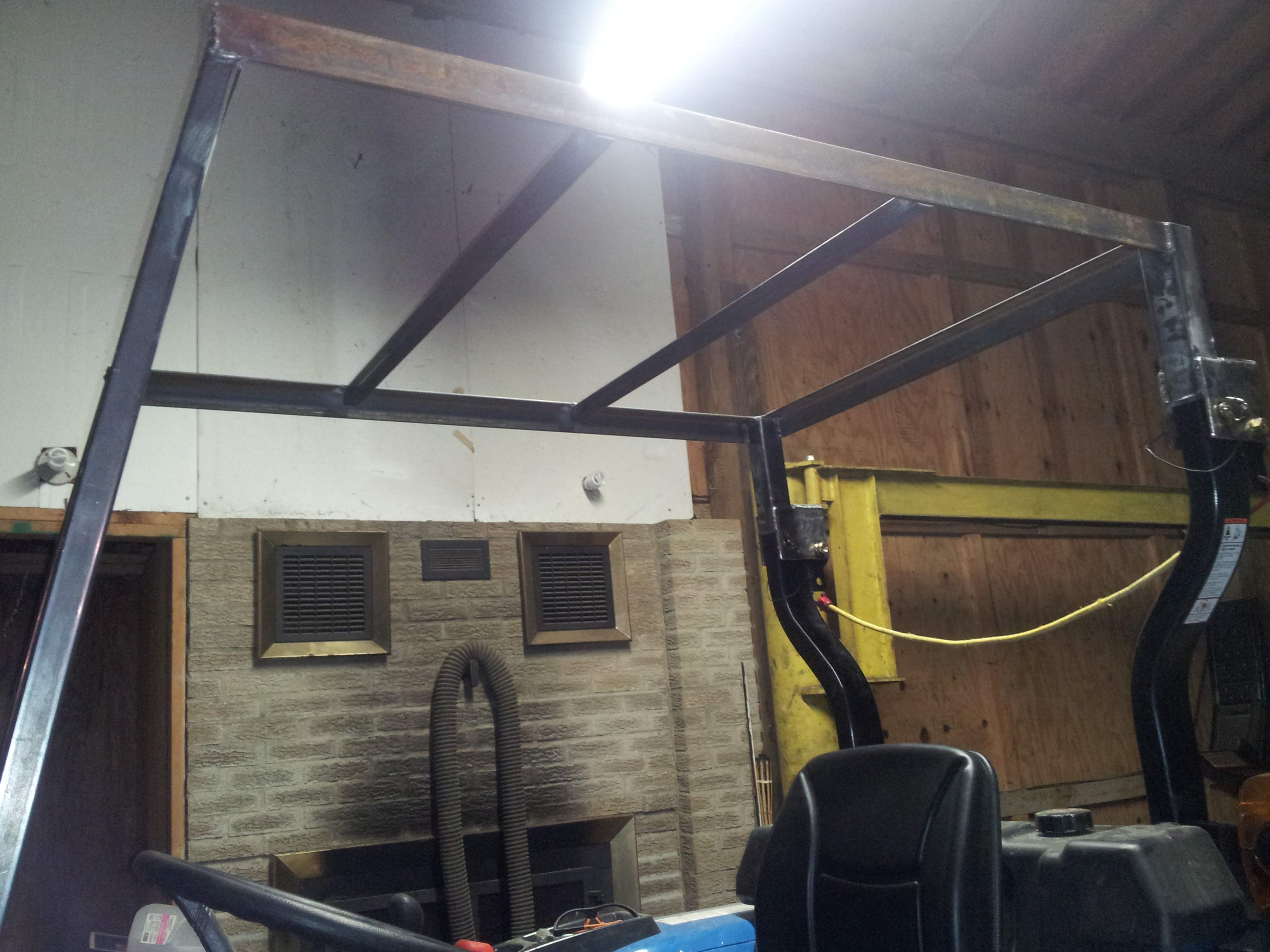

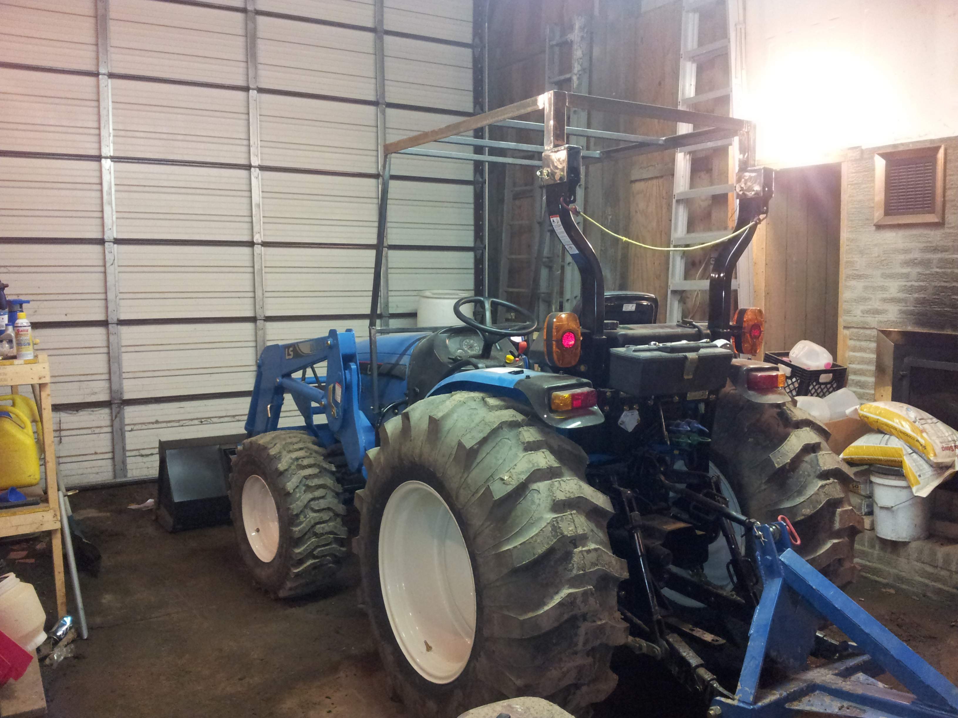

And here you can see the new upper ROPS that I built to replace the factory one. I also included a tab on the back to mount exterior lights (don't think I got a picture of that tho...). The vertical bars are 2x2x1/4" tubing, and the angle iron is 2x2x1/4" as well. I made plates to match the factory mounting points to the lower ROPS portion and used the factory bolts/pins.

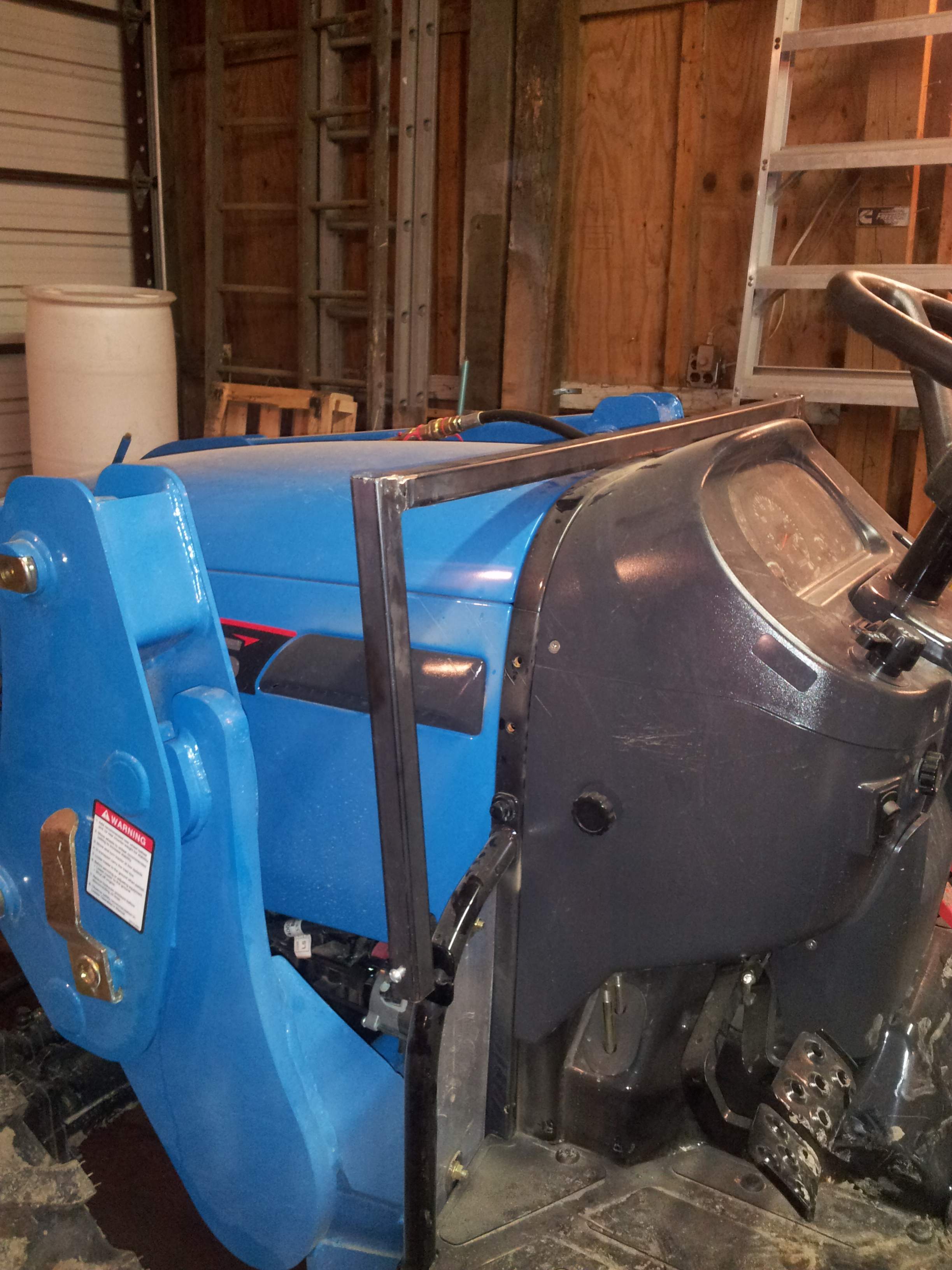

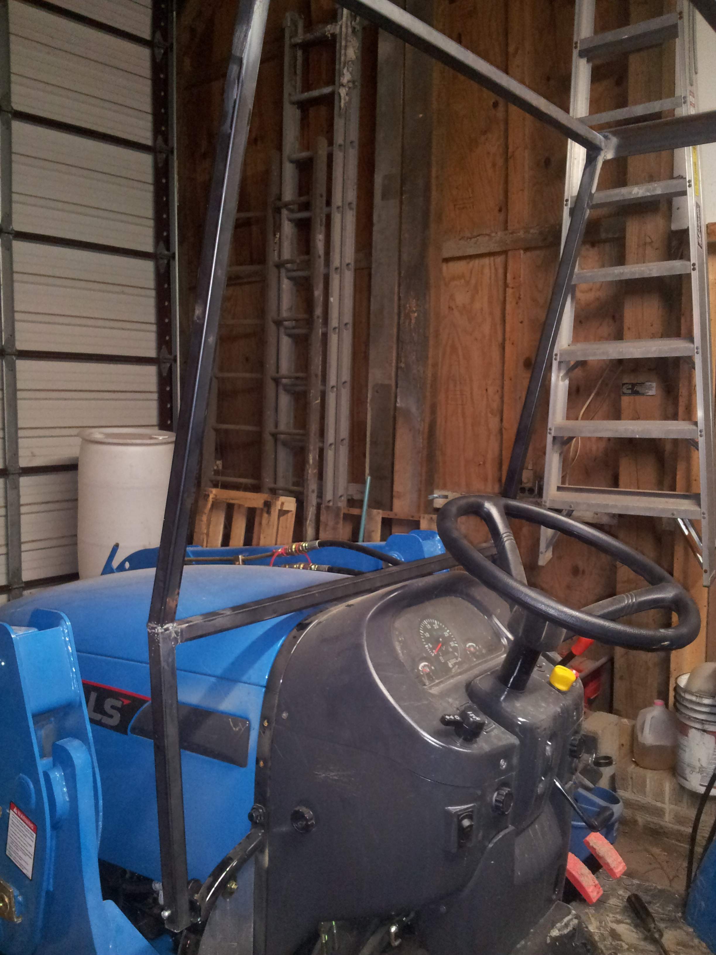

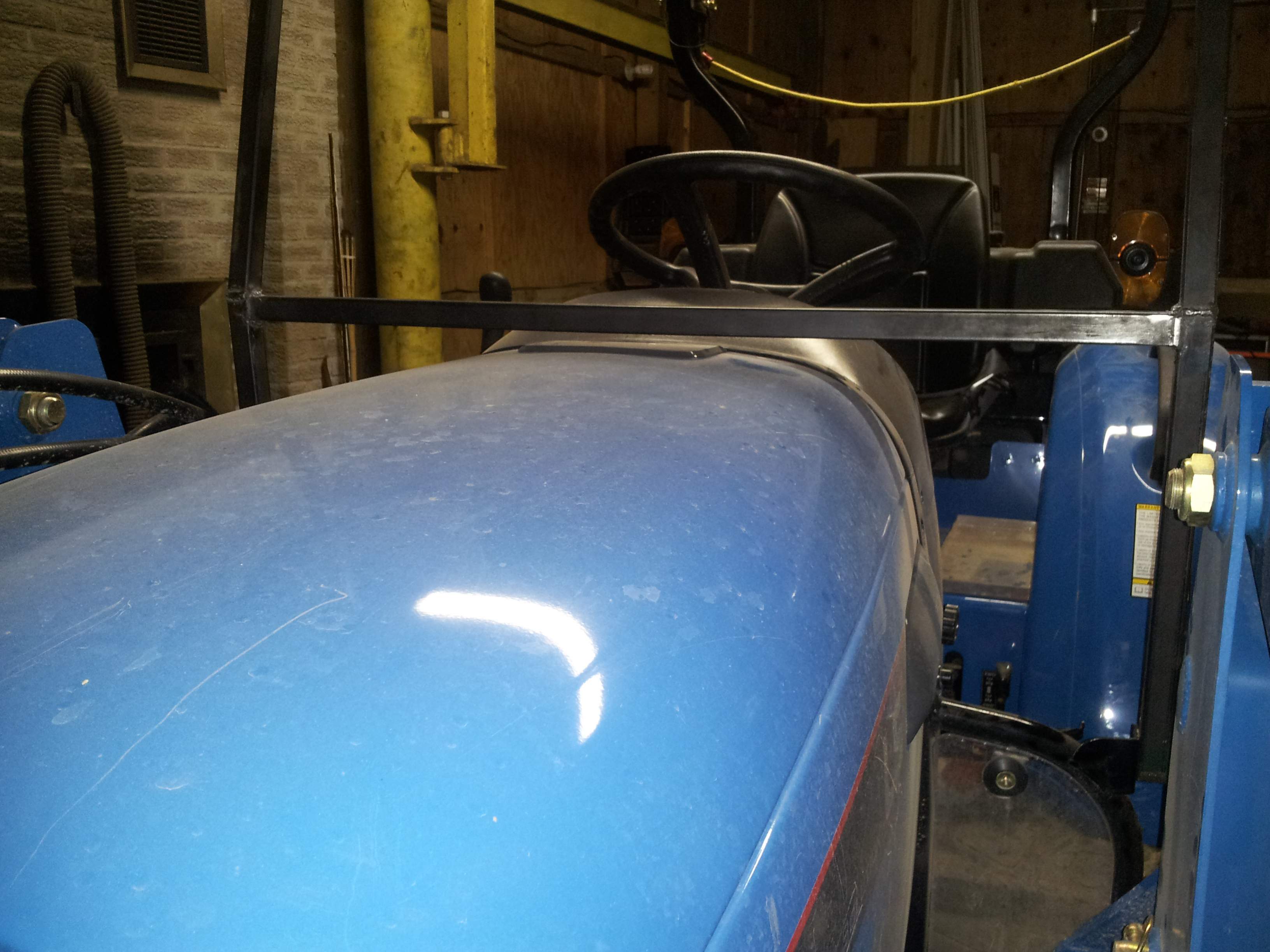

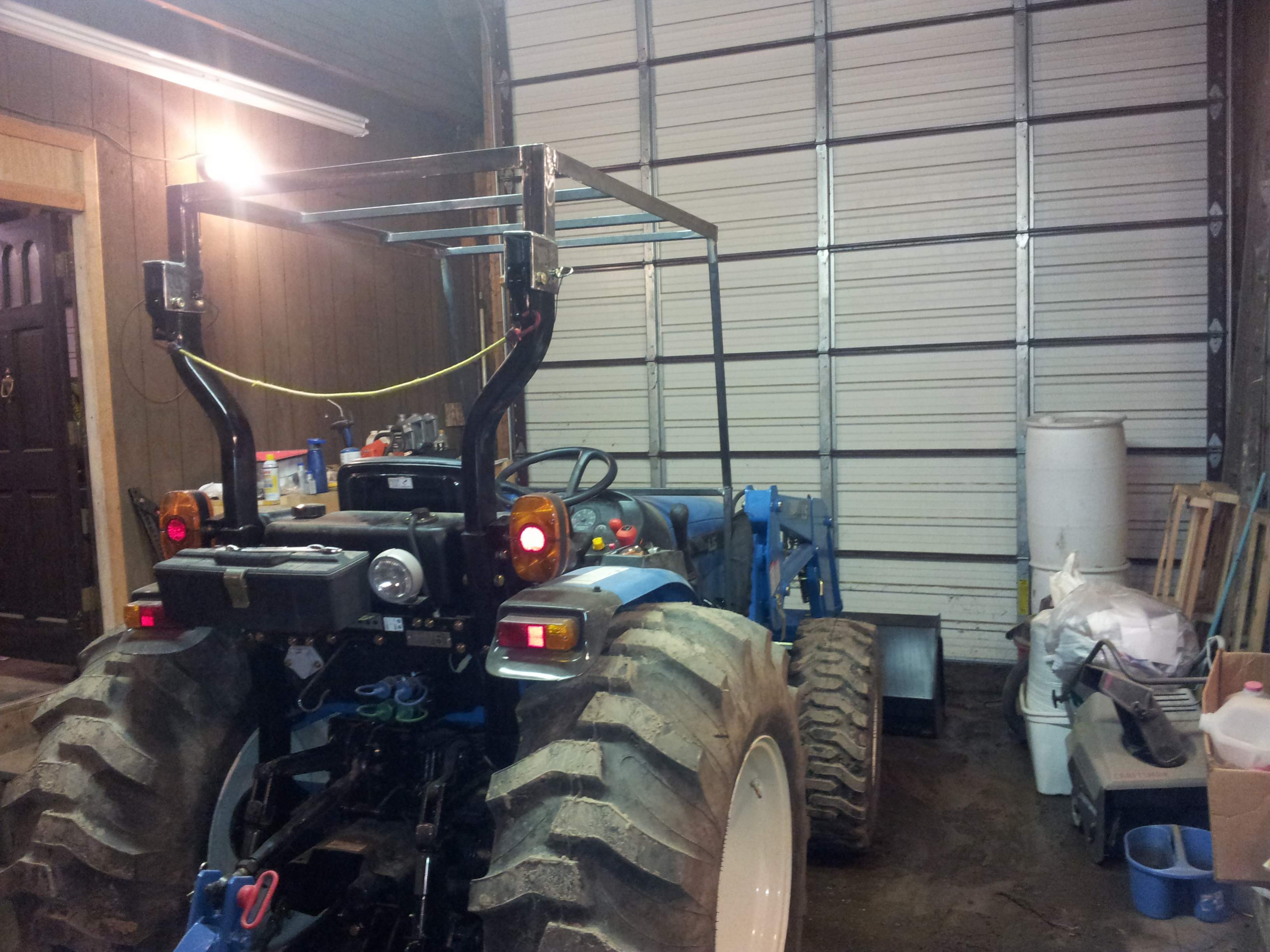

To tie the front portion to the tractor, I used 1x1x1/8" tubing and tied into the lower "mud-shield" framing. The tubing (and mounting points) are strong enough to support the frame & such... but would most likely be destroyed by a roll-over. Luckily I don't plan on doing that, and the upper ROPS that I built should be as strong as the factory one, albeit a bit shorter. The horizontal "roof" pieces are angle iron, with the 1x1 tubing for cross bracing. Regardless, I should still be safe in the event of a tumble.

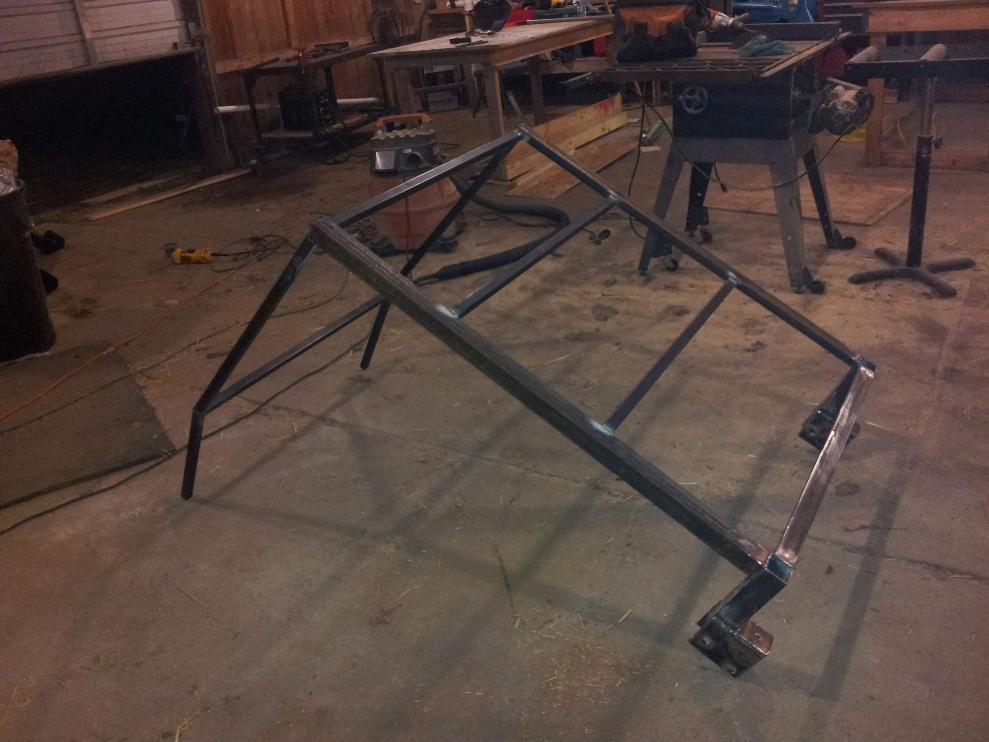

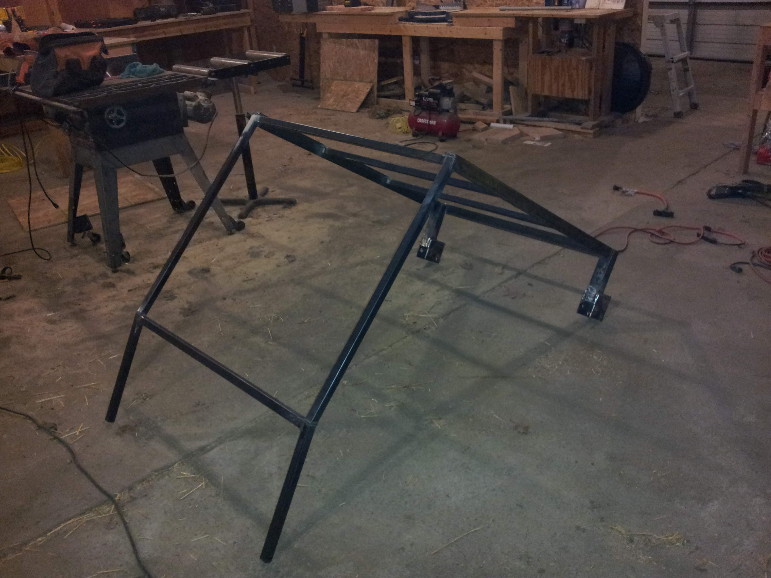

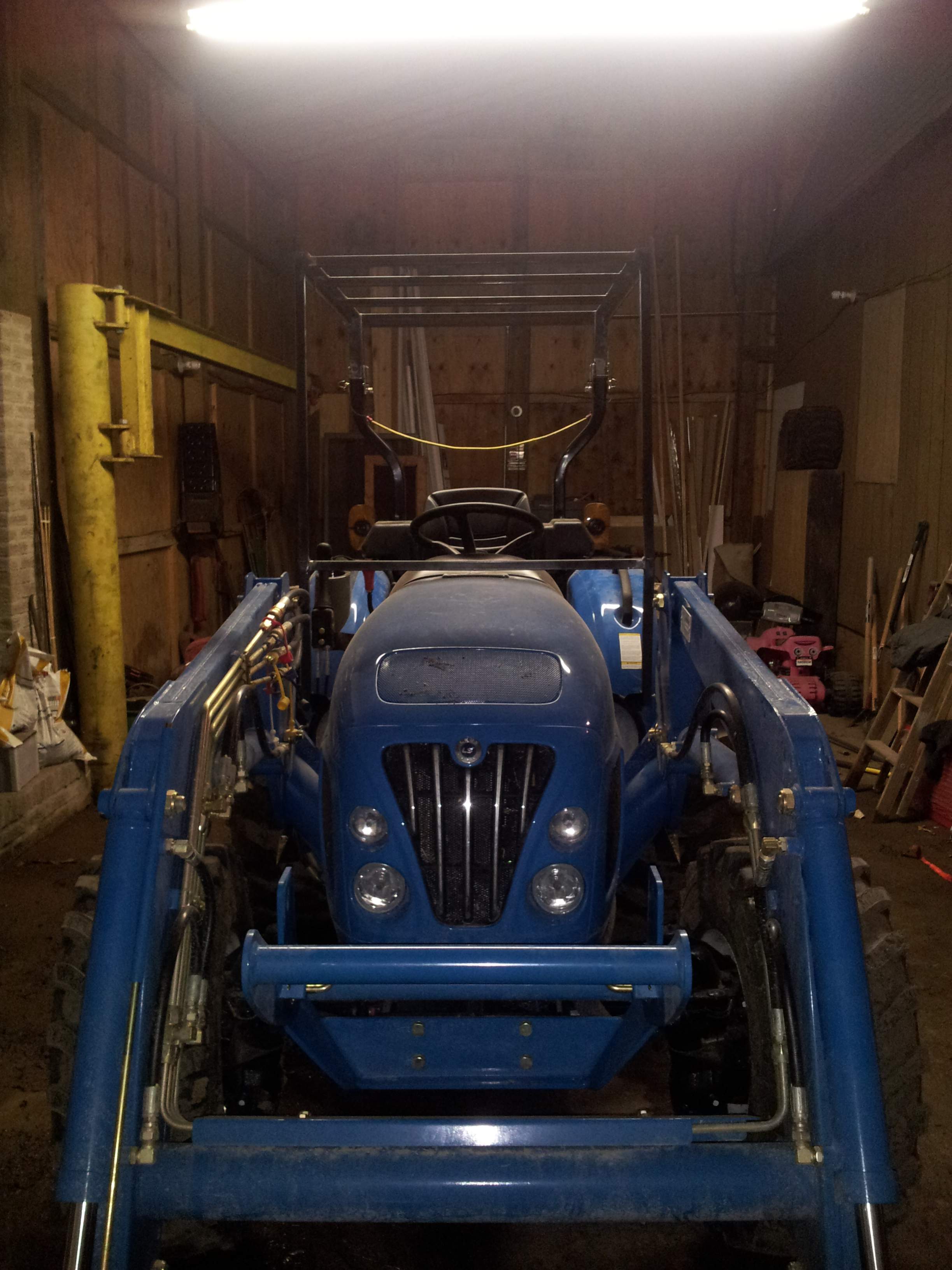

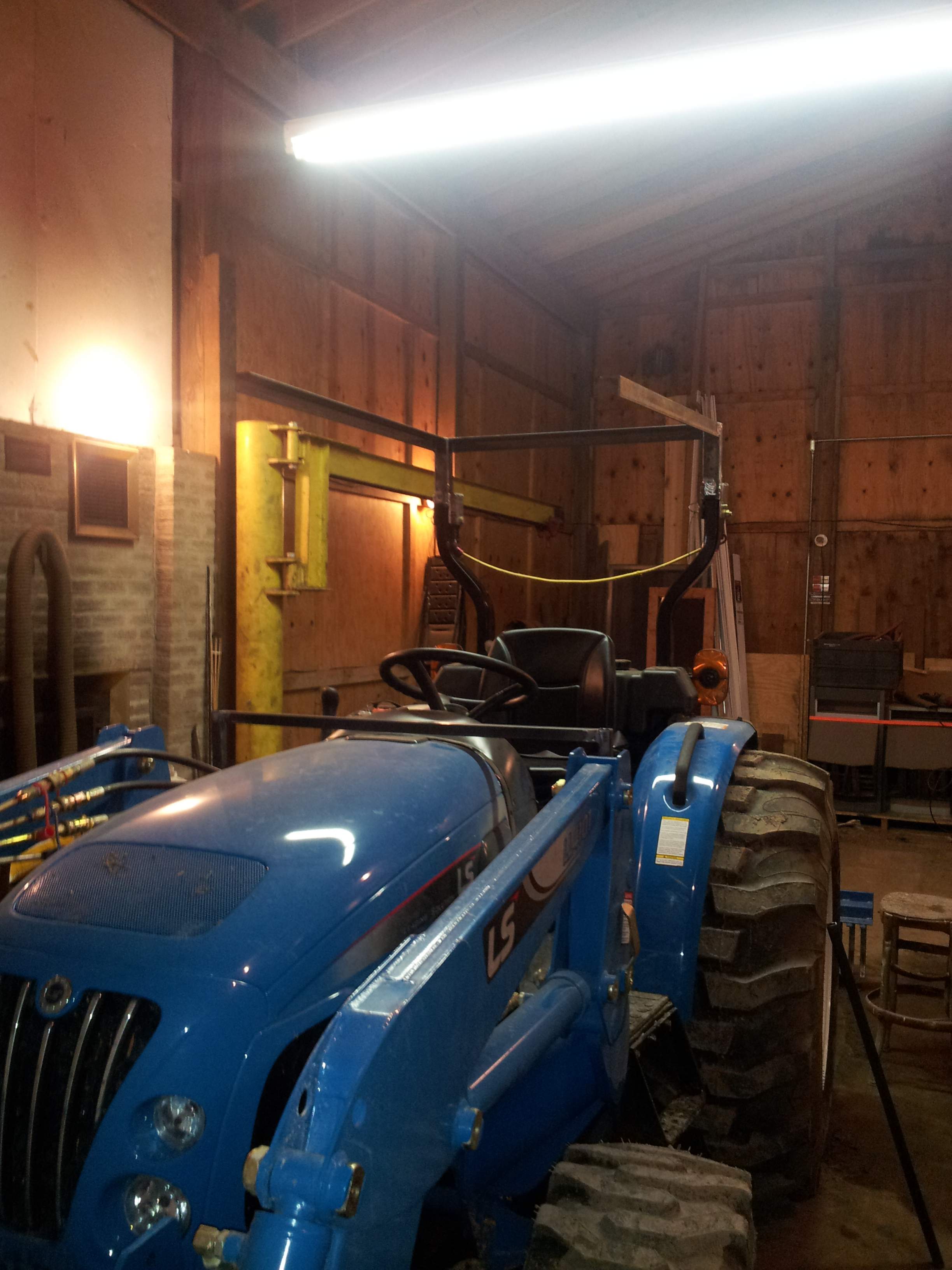

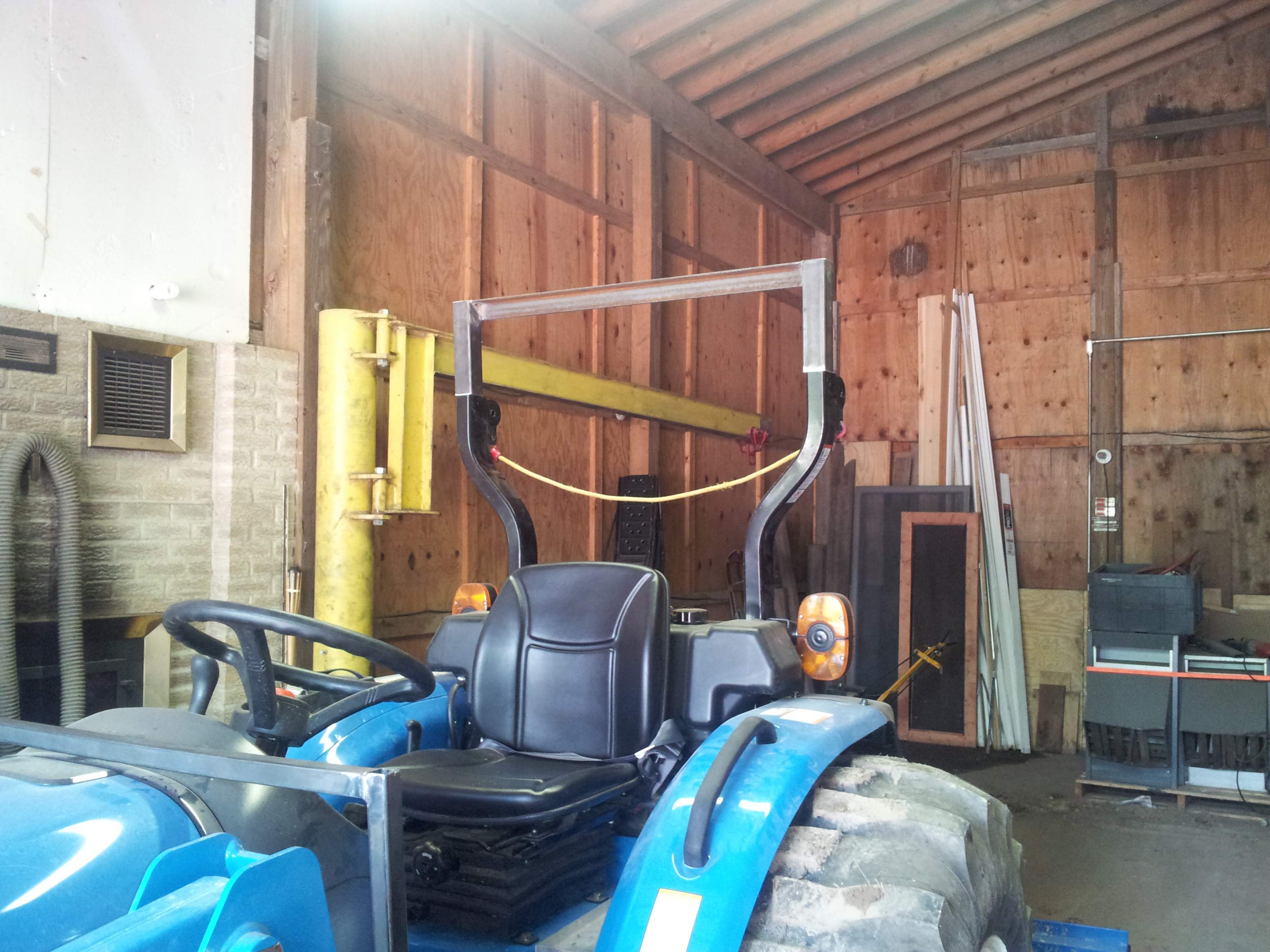

So, here it is all together and bolted up. I still have to add a few more brackets for some storage & lighting, but otherwise, it's complete & functional. I also still need to paint it and add the roof. I'm still not 100% sure on how I'm going to finish off the roof, but I'll most likely use Plexi-glass so I can still see out of the top. I don't know if they make it tinted or not, but if so, that'll be my choice. Otherwise, I'll spray it with some tail-light tint spray.

Eventually, I'll build a quick-attach front windshield panel, as well as some side & rear panels for the winter. No hurry though now, this build only took me 2 days (much faster than I thought) so I'm ahead of schedule on it! More to come when I have new pics, paint, etc.

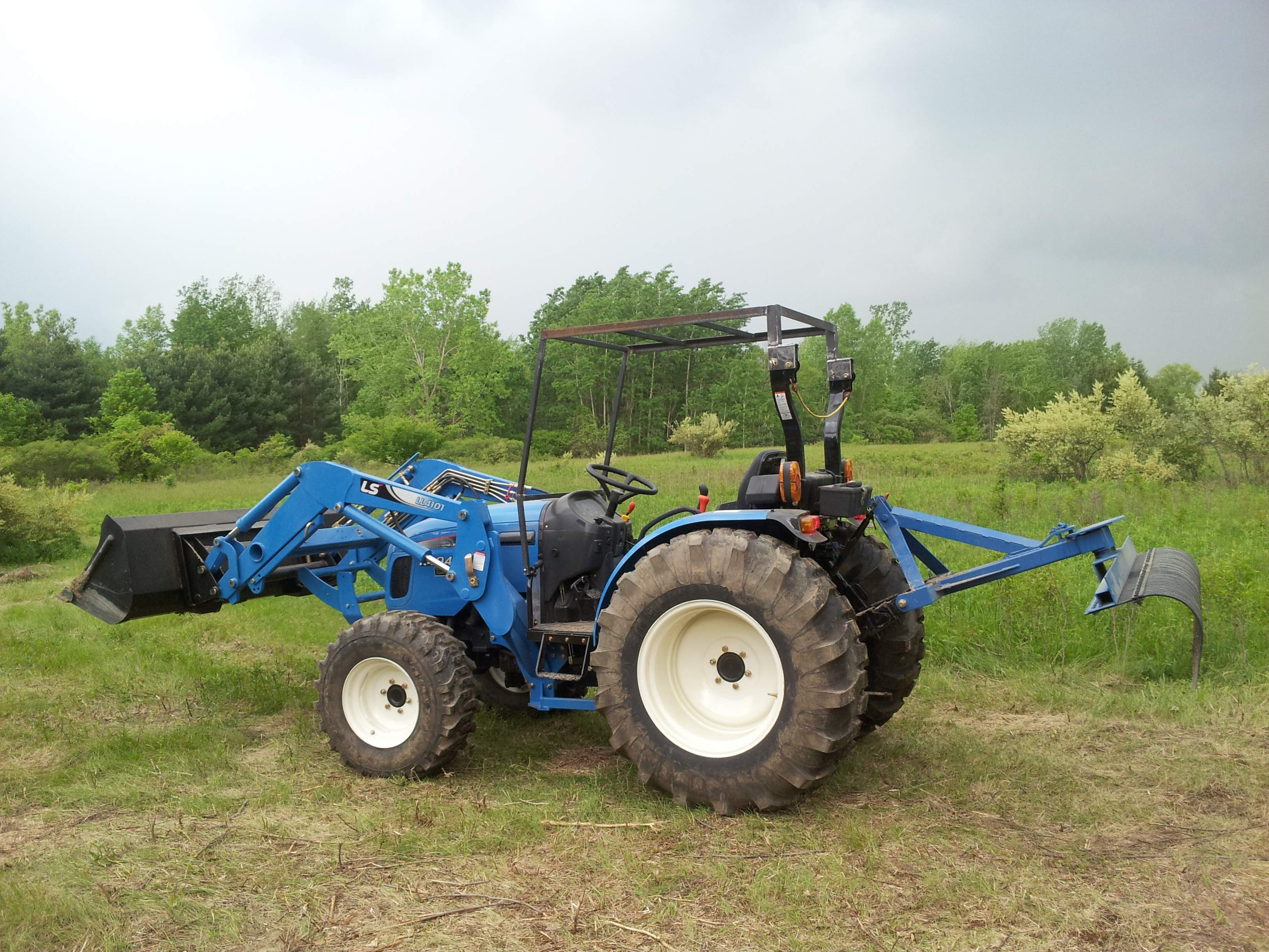

I was just thinking of that 'false' sense of security a roof may provide towards falling branches and such. Your framework will handle a good blow, but I am not sure about 1/4" plexiglass. Hard to say really... just my thought on it!

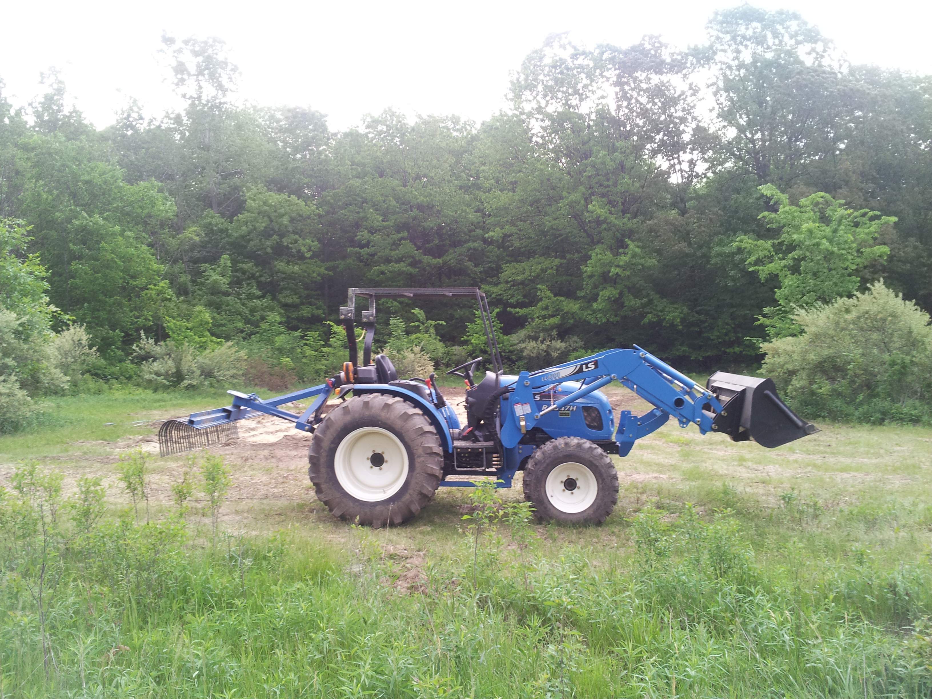

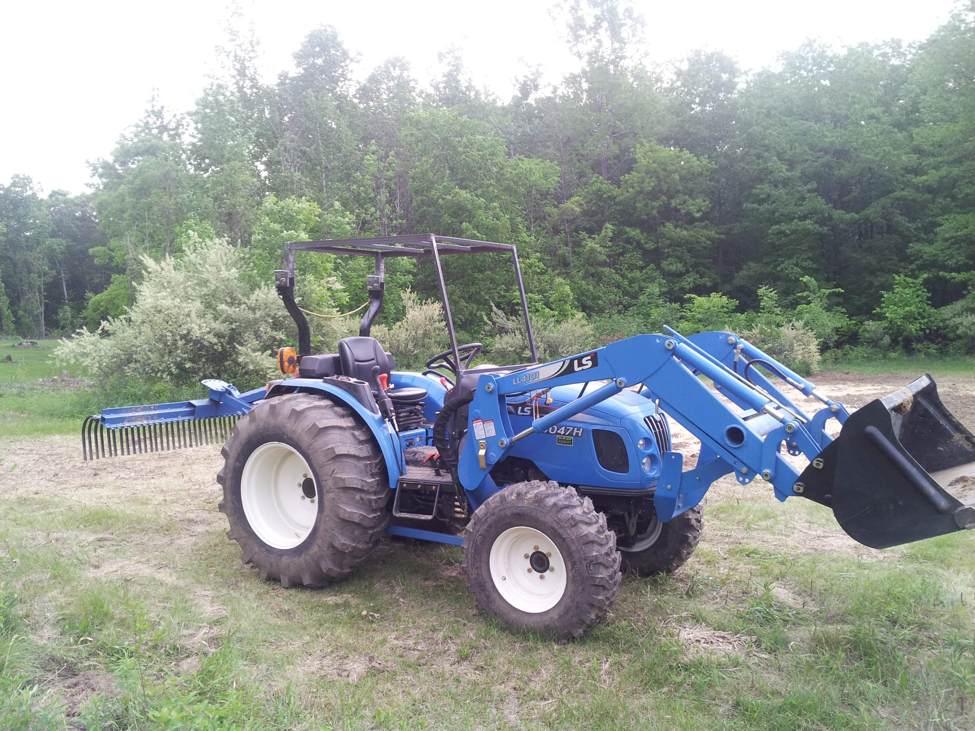

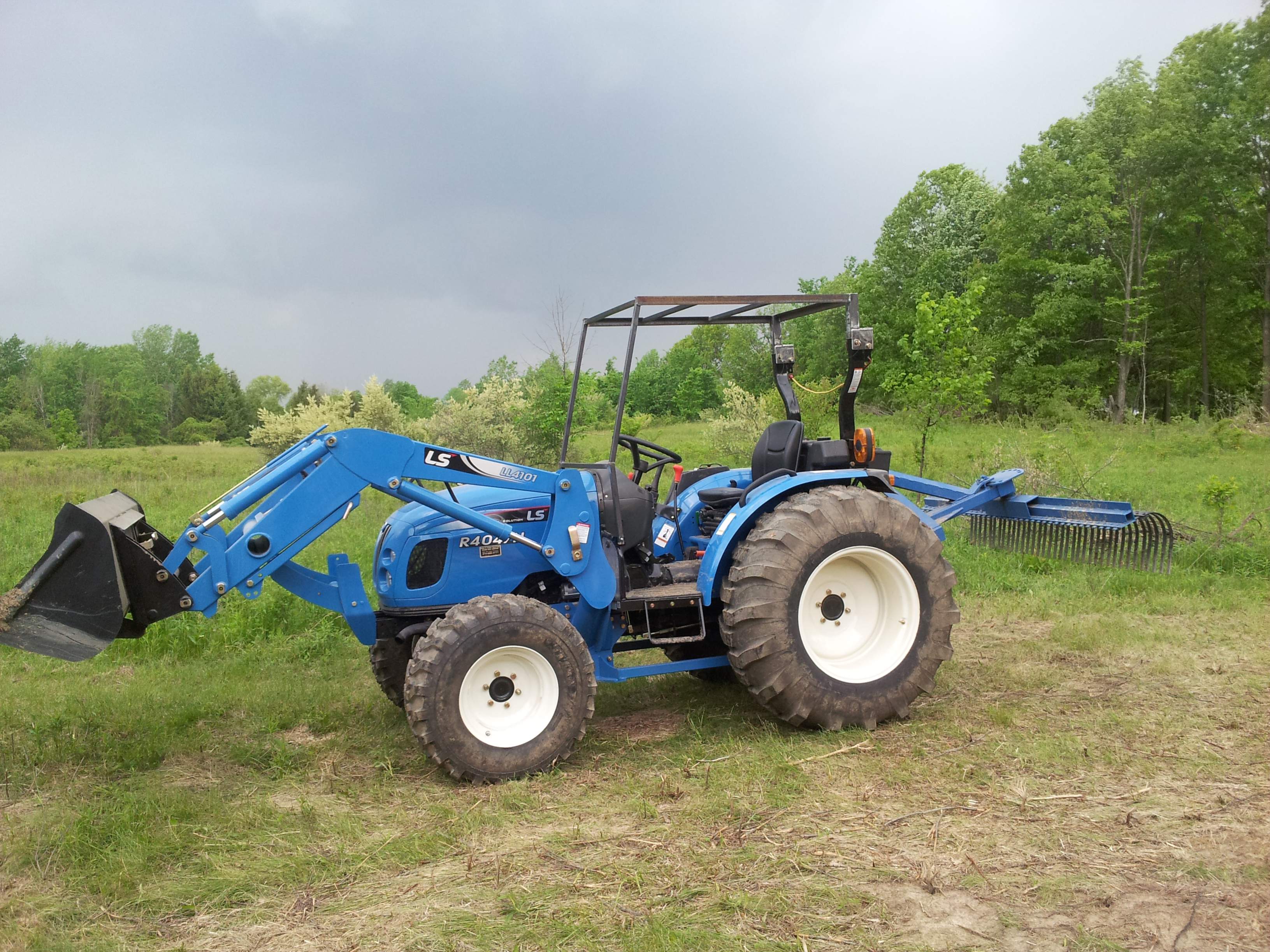

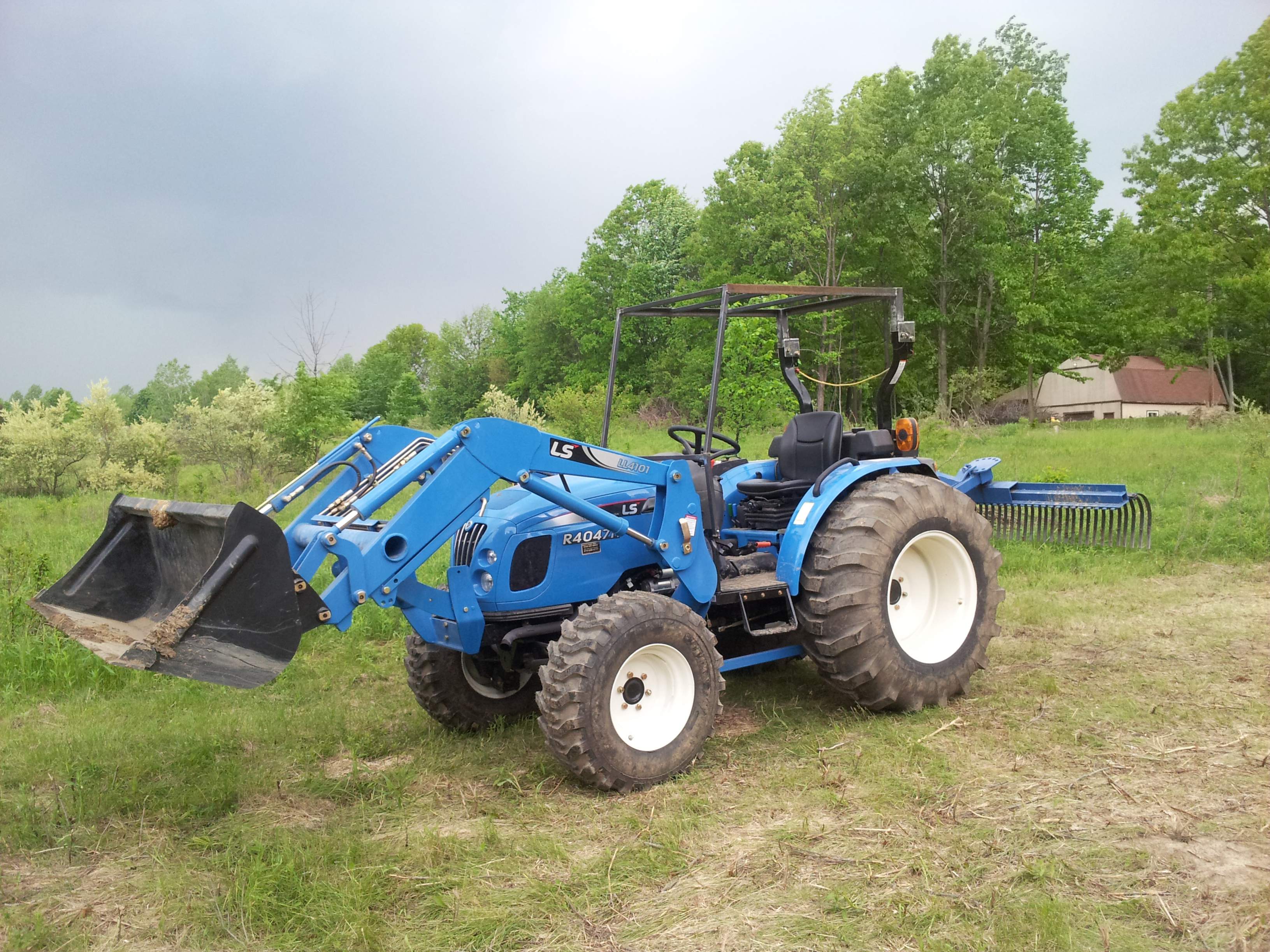

No prob Mangus, any comments/concerns/insights are welcomed... it's an evolving project. I drove it around a bit today to get a feel for it, gonna have to find a way to dampen the vibrations because the engine vibration and ground-bumps really resonate through the frame.
Here's a couple "outside" pics today.

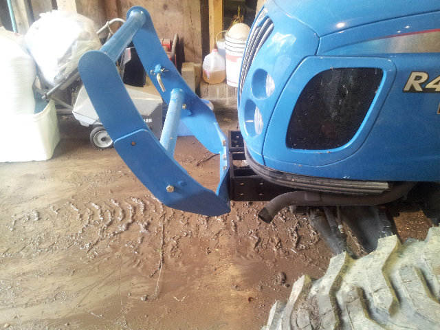

Do you always drive around with your brush guard down? My loader doesnt clear mine!! so I cant ;-)
/ "Cab" project for my R4047
#11
Funny story...
I had to swing it down to open the hood to make sure that the windshield frame would clear the hood. When I was done I swung the grill guard back into position, but apparently I forgot to push the pins back in place to hold it. I didn't realize that the guard had swung back down when I was driving, and when I parked the tractor and put the loader down, I bent the guard.
Oh well, I was gonna remove it anyhow for the hood protector I'm going to build, but it still sucks that I bent it.

Oh that doesn't look to hard to straighten out, a little heat maybe a lot of heat and a vise. Of course you'll have to paint it when you paint the rest of you new frame but no biggie!

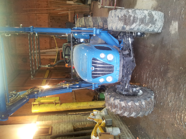

Thanks fellas... finished constructing the roof (beginning phase of course). Ended up making it out of 3/4" hardwood plywood. I will be cutting out "skylights" for the roof for visibility and covering them with plexi. I'll finish the wood with filler-primer and tractor enamel to seal it. Using angle-iron to line the edges of the roof for durability (that'll get painted too, of course).
Right now I'm just finishing up some little things to the main frame (little add-ons) like storage, mounting points, etc. Then I'll take it back off, weld on all the little extras, and paint it. This project is becoming fun. I'll be moving the rear flashers up towards the top, and getting some LED work-light bars for the front and back, which will mount to the roof-frame under the overhangs --- that'll really help night illumination. I'm also building a large metal "tool-box" that will go all the way across the back. Also planning to add a "marine" stereo & speakers, along with some other goodies. Picked up a bunch more metal today from the scrap yard (love that place).
All in all, I'll probably only have around $220 in metal on the whole project. $50 or less in wood. Not sure how much on the plexi yet. I think I have enough lying around for the skylight, but not for the windshield or the rest of the "cab" although I'm not in a rush to get that part done, won't need it until winter :D
