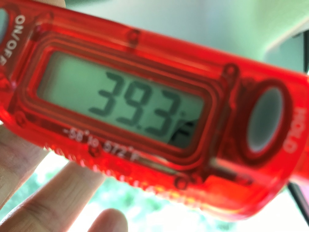

Bought my L4240 used with 977 hours at the end of 2018. Put around 500 hours on it since then. Near the end of the Summer in 2021 I replaced the expansion valve. Other than that it's been fine. Here's what she blows on a normal Summer day. (Vent set to recirc)
