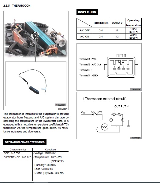

I noticed something odd relative to this topic this morning. Today was one of the coldest mornings that I have used my tractor - about 10 F. When I first got in, I turned on defrost and tried to toggle the AC button. No light. After running it for a little while, I tried it again, and the light toggled. My theory is that the AC is not allowed to be turned on below a certain temperature in order to protect the AC system. After the tractor ran a bit, it warmed up everything enough to be above the disable threshold.

That is correct. The thermister, that works as a temperature switch for the AC in our tractors, must be warm enough before allowing to AC pump to turn on and begin drying the air for defrost. If the thermistor did not do this, the AC refrigerant would slug the compressor. Yesterday while blowing and plowing my tractor didn't kick its AC on until maybe 15-20 minutes of work and this with a block heater on for over 24 hours.

Perhaps this. Attached is a description of the "Thermocon" operation in the NX HVAC system. If I'm interpreting it correctly, the thermistor's set point is nominally 32 F. So, if it senses an ambient temp in the roof cap below that, the AC relay will not switch on. Does that sound right?
Since some are reporting no illumination of the AC indicator light prior to warm up, the light evidently is wired between the thermistor and the AC relay, thus will not illuminate below 32 F. That seems a bit odd, though, as more logically I would expect it to illuminate whenever there is power to the thermistor. :confused: Then, as the roof cap temp reaches the set point, the thermistor would allow current to flow to the AC relay, while the light stays lit the entire time until the AC switch is toggled off.
But, then, I'm no electrical design engineer, so I may be all wet on all of this. :laughing:

My A/C indicator light will not go on if A/C is not operating.
