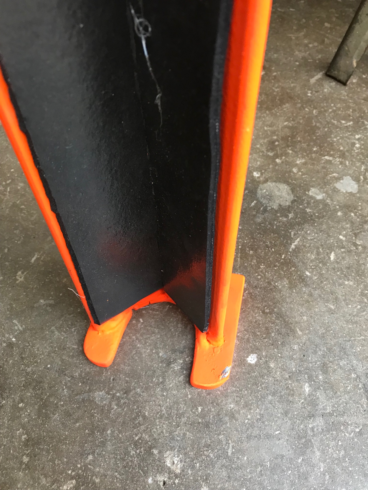

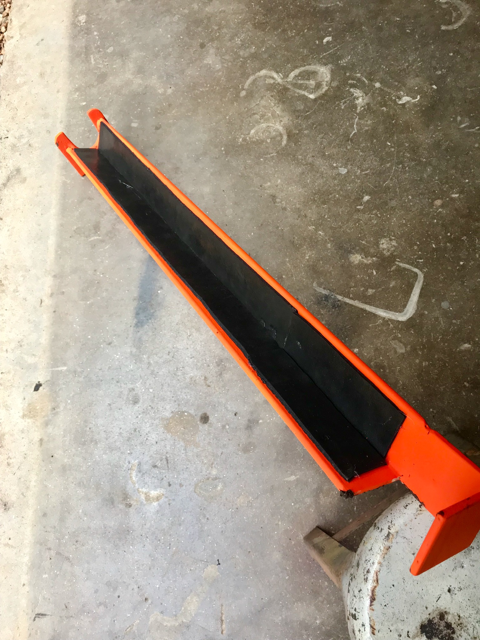

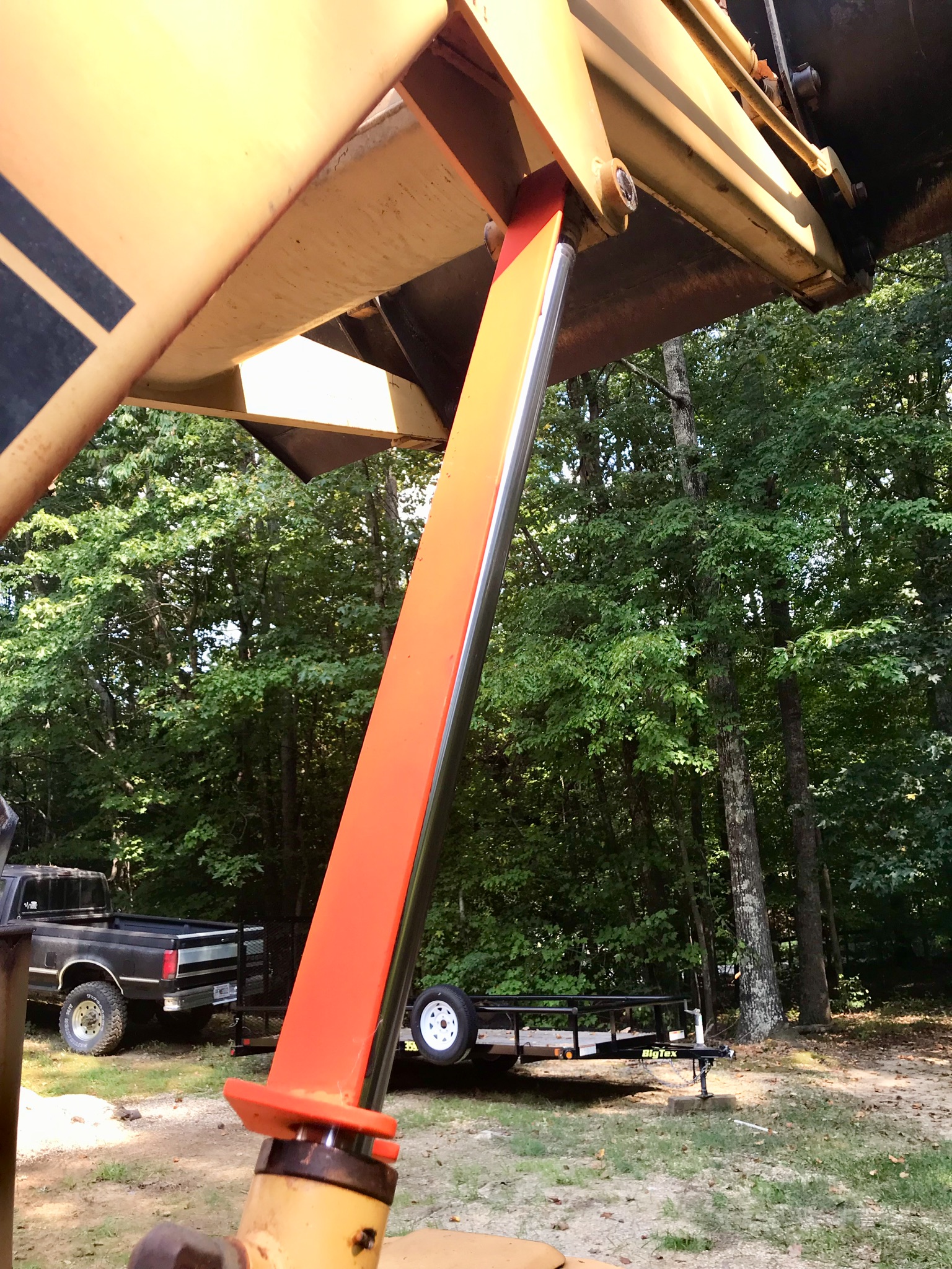

No matter which way you choose, never, ever get under the loader when raised, even for a second, it will only come down on
you once! This is one I welded up for my Ford 345C, it痴 a heavy loader, so I used very heavy angle iron, welded a foot on it to spread the load over most of the cylinder gland, then I welded a hook to line it up and hold it in place while lowering the loader down onto it. I went ahead and landed it with rubber to protect the cylinder chrome.
