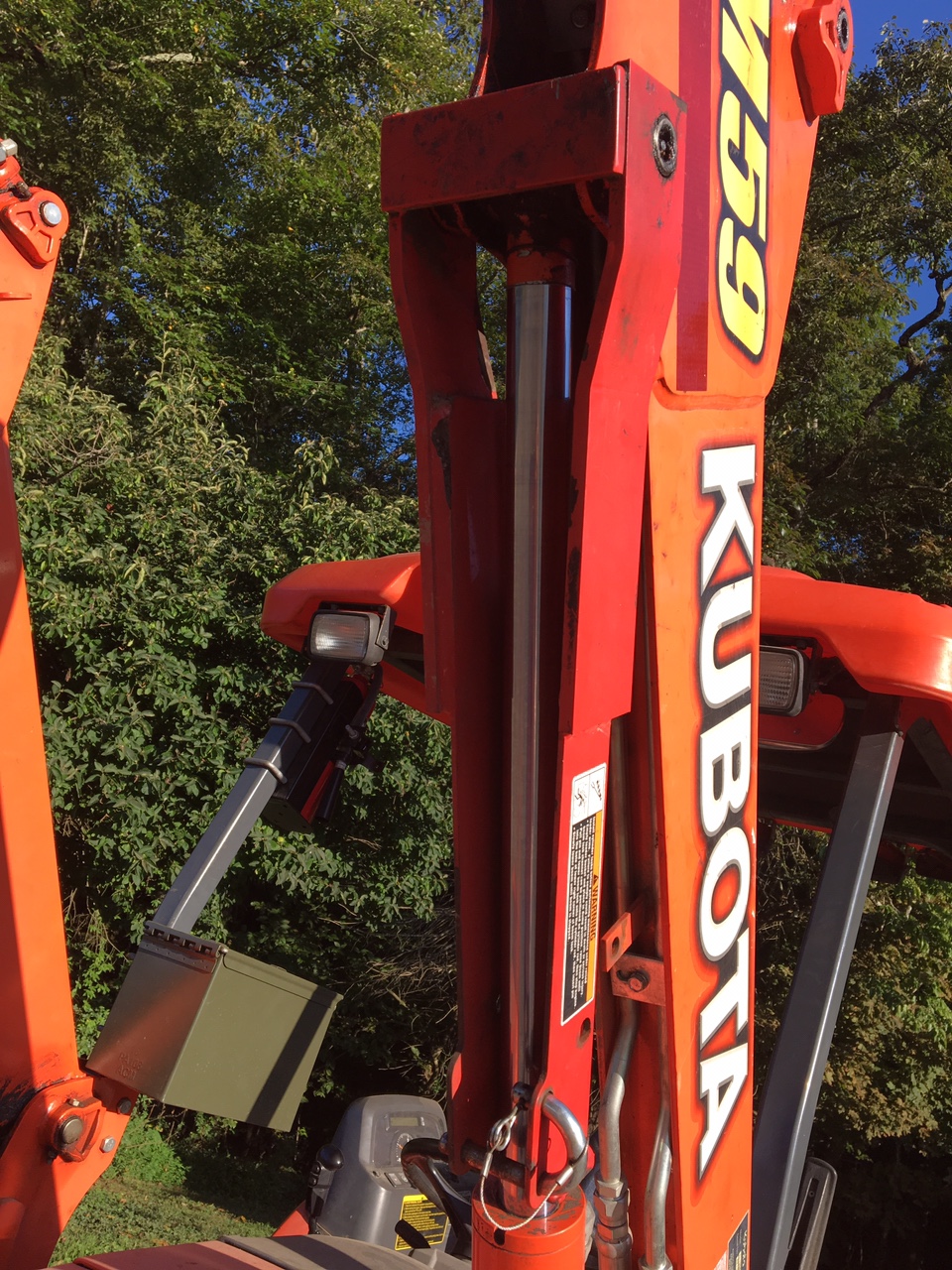

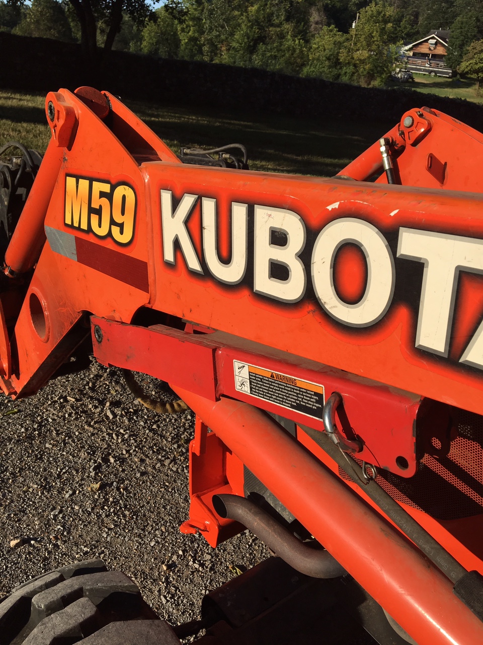

Want to make something similar for a B26 more for safety more than storage. These will become more common like ROPS on ag tractors eventually. Cleaning the radiators is a frequent job during mowing season.
The M59 prop is well designed. Not under the loader to deploy or store. Takes <10 seconds to use and always with the tractor. My home, shop and tractor shed are 0.5 mile apart so staying with the machine is important.
Kubota used 5 pieces of steel just for the prop.
Rubber bumper protects the cylinder rod chrome from nicks.
The top hinges on a special longer loader pin. For the B26 I’ll probably hinge on the loader pin bearing bosses instead.
Agree, use steel pins to secure. I like ball release pins for their simplicity and professional flare.
Accidents are usually a combination of failures. A Simple step can prevent a major catastrophe. Is failure an option?
The top hinges on a special longer loader pin. For the B26 I値l probably hinge on the loader pin bearing bosses instead.
Same design my backhoe has. I have to pull a hitch pin to remove the retaining pin though. Still pretty simple and safe.

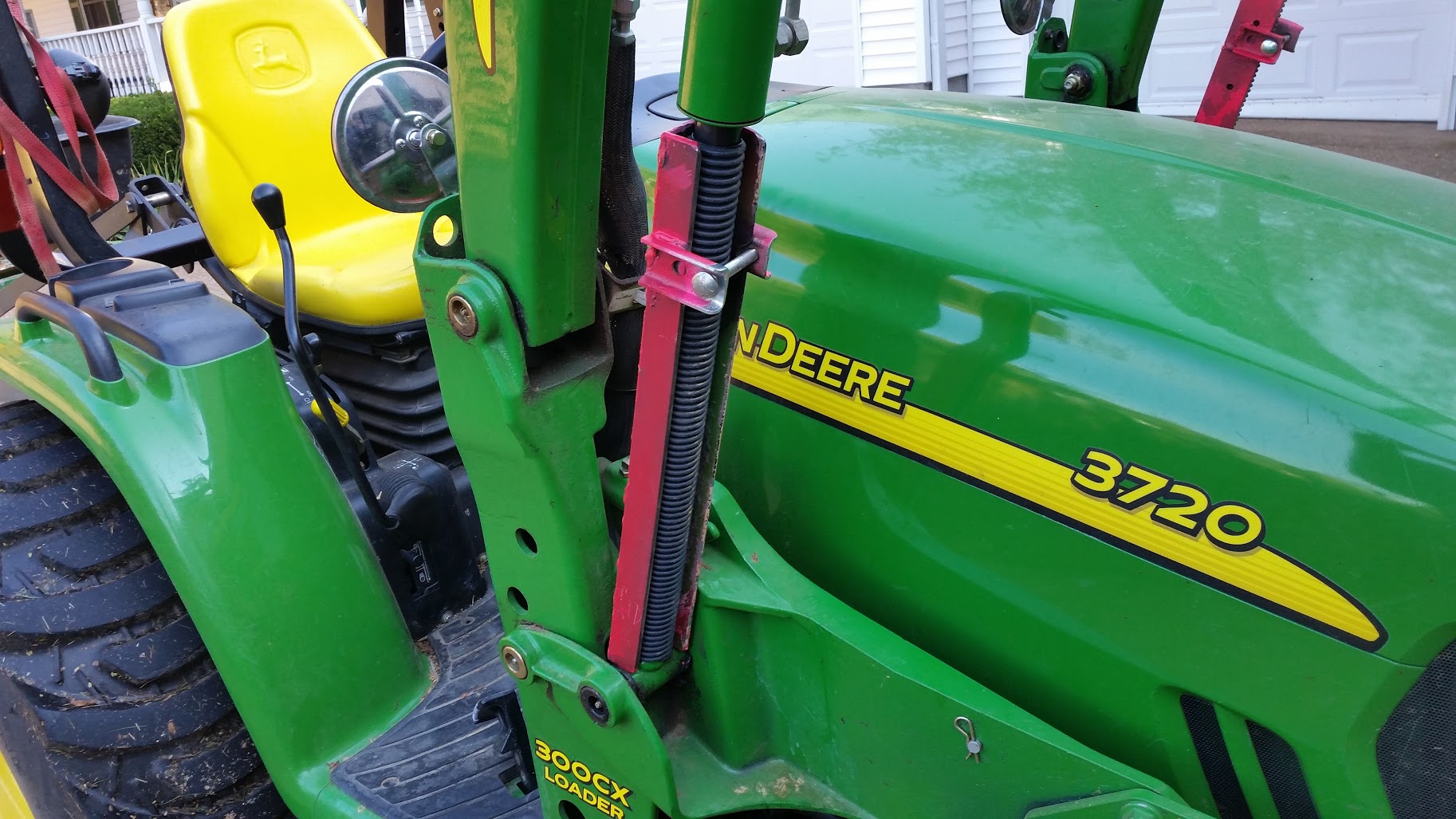

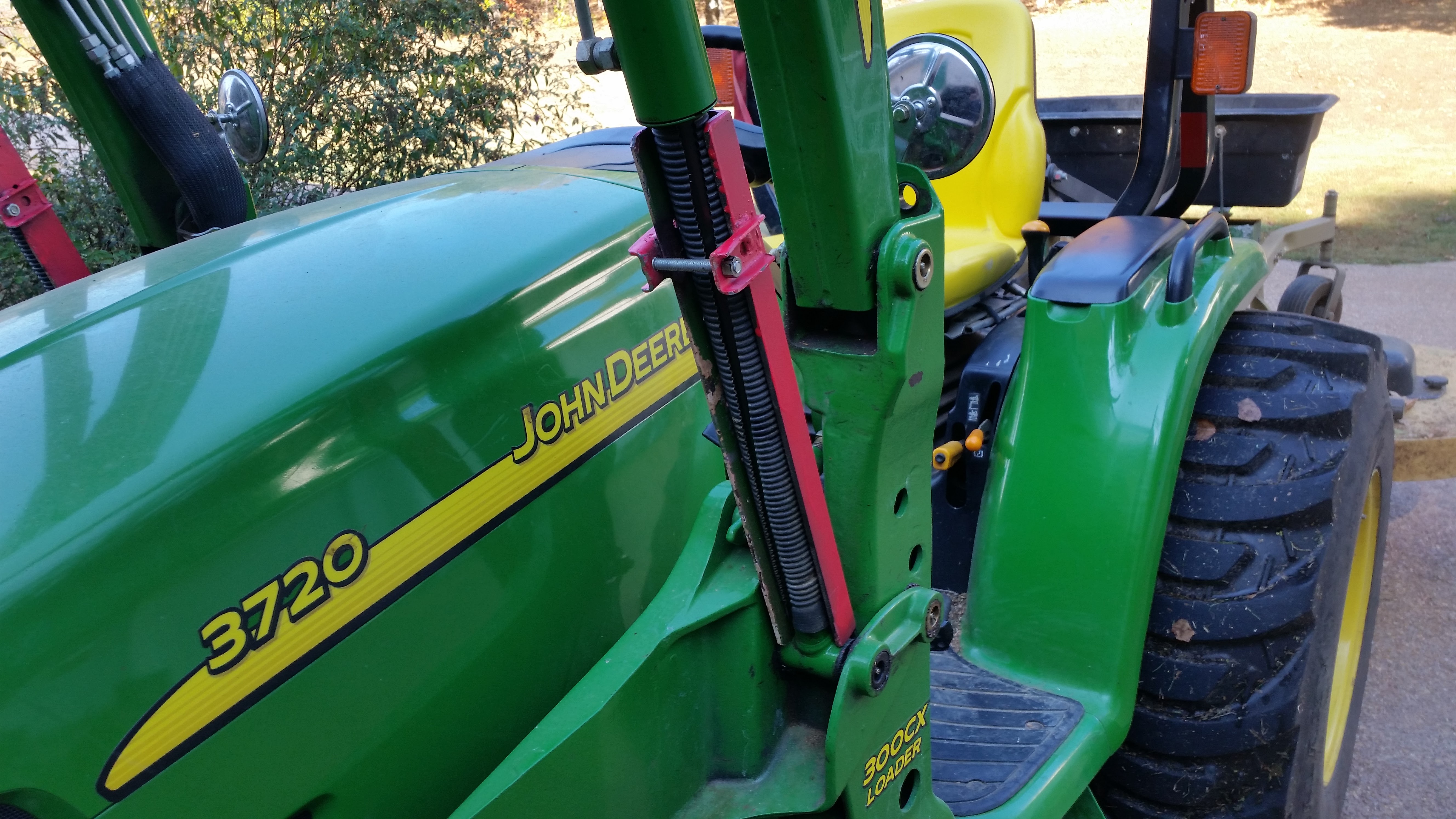

I thought about building one, but found that the one that came with my Kubota fits my Deere. I was worried about doing anything that might damage the cylinder end. That part of the cylinder is (I'm guessing) NOT meant to take load!

I made a shield for the end of the brace today. I'm going to try to find an old tire I can cut up so I can put rubber on the ends of the brace. I considered using wood, but I don't think it would stand up to the pressure over and over.

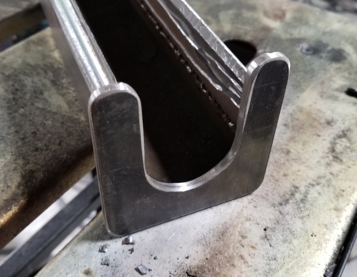

I built these u channels with a tang for a pin or bolt. I use a plastic sump pump hose to cover cylinder under the steel. Works great an is secure/

Nice ideas and work.
Since the Kubota loader prop is hinged it needs only a small rubber plug bumper. If you were to pull the pin and let the prop fall it would make first contact. You rounding all edges is good craftsmanship.
